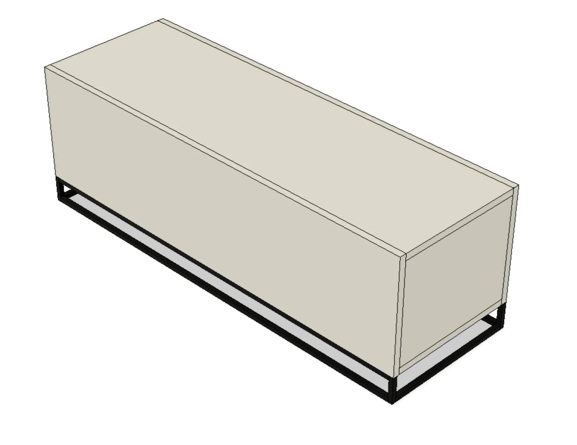

the plan is to make and hide it as table. I was thinking of making a down firing subwoofer, but in my other thread, people said that dual opposed would be best to cancel out vibration and resonance, that over it would be best, and more out put.

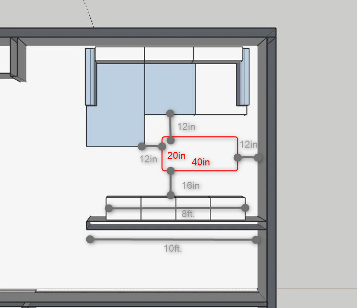

I have ~ 40in x 20 x 20 roughly avalaible. I can give or take couple inches to accommodate.

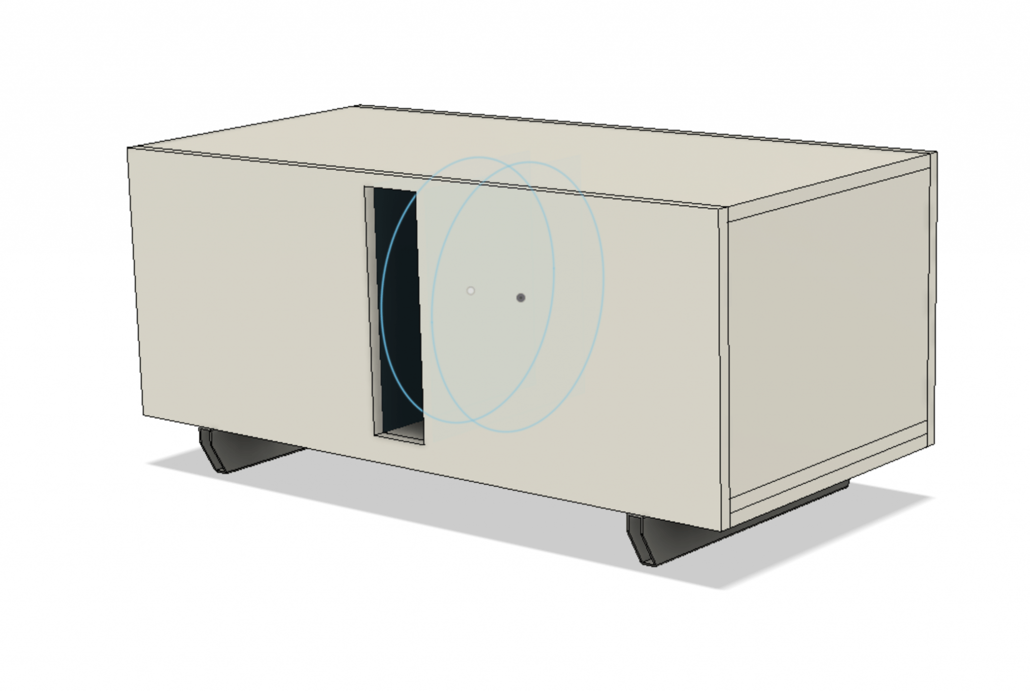

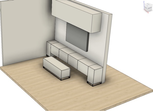

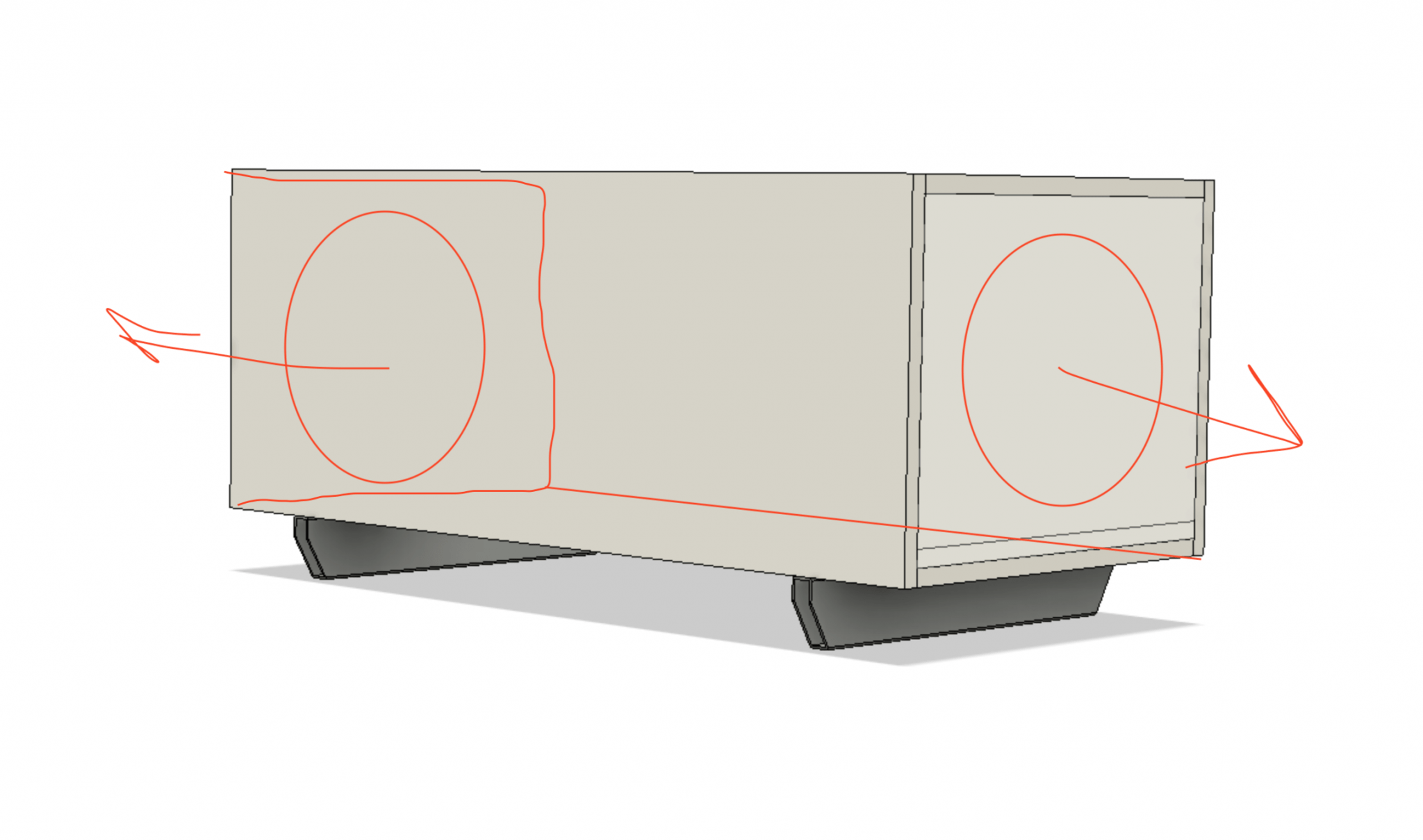

I included a screenshot of the table with 2 15’s in their 2.5ft^3 at each end of the table, and a ‘concept’ of a “slot loaded” type of subwoofer.

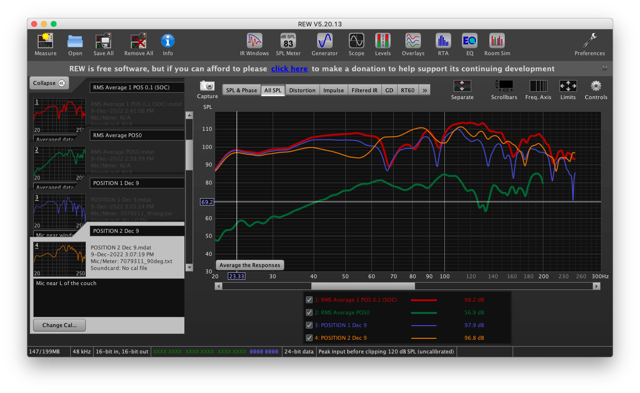

Also, I included a REW screen shot reading of actual subwoofer placement: red and green line. And driver placement at each end of the table : orange and blu-ish line.

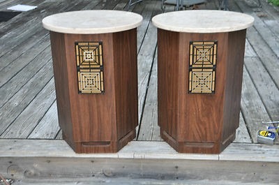

Oh! I don’t mean to pretend who came up with this idea! Haha.Empire did it way back when. Marble tops.

On the other hand, I remember DAK used to sell a Cerwin-Vega sub setup as a coffee table; it too had the downward firing driver.
Perhaps there's something to that arrangement.

If you intend to use it for a table I think dual-opposed is the only sensible approach, since you will need to cancel vibration as much as possible. I would also make sure you couple the magnets carefully, or at least thoroughly... glue, hardware, something to keep them moving as one.
I think vented or any other alignment is possible. Given the size requirements I think you are looking at a coffee table. However, it's worth noting that 20" is pretty tall for a coffee table and they tend to be closer to 15" tall.
I would start with WinISD to figure out the size(s) of enclosed volume for this.
The amp you're using has plenty of juice... so I think choice of drivers is pretty open. You could even go sealed since you also have DSP, the limiting factor is going to be xmax. There are plenty of long-throw subs including the ones you linked, at a similar price I'd also suggest the CSS SDX12 can do pretty well with a high-power, limited-volume situation.
The idea is to keep the drivers hidden so I think the slot-loaded idea is probably the simplest path forward. You can close the sides of the slot and have it be down-facing, (basically the whole table looks like a box) put the whole table on feet to keep it off the floor, and there you go.

A casual observation on the slot loaded layout: I would likely increase the slot size so the drivers can both be mounted/removed through the slot that faces the bottom. It burns some volume, but makes assembly and finishing easier.

Yes, 2x12" should be enough. Dual opposing will be force cancelling only if they are firmly fixed together. Slot loading actually gives extra spl only in extreme nearfiled, with the expense of more distortion at high spl because of air motion noises.

A flat downfire box can be mounted below the table cover, sort of hiding and giving more "air" for the feet of the table.

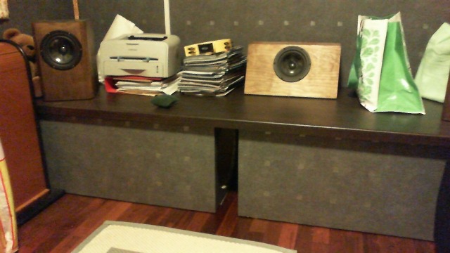

I've had a dual opposing slot loaded bench sub in my study/HT room for many years, 2x15" Dayton DC380. The 2m long cover weighs about 30kg and carries lots of stuff and is not attached with screws, but has just window sealing silicone tape.

Is was intended to have the table on some feet if down firing. That would get the overall height the same, but the box a little shorter.
Any pointer on how to design/ calculate slot loaded? I wouldn’t mind have the slot on the side. That would make a cool discussion starter haha. But yeah, if you have to be very slick, down firing is the way to go.

I’ve gone ahead and measure with rew before cominting to something that wouldn’t work.
Here’s my rew reading.
Green line is where the sub usually go, and umik-1 at the MLP.
Red line is the mic at the subwoofer location, and subwoofer at the MLP.
Orange and cyan line are “at each end of the table”
I found that both driver would complet the other in a good way.
The receiver was set to 75db using pink noise with the generator and the spl meter before readings.

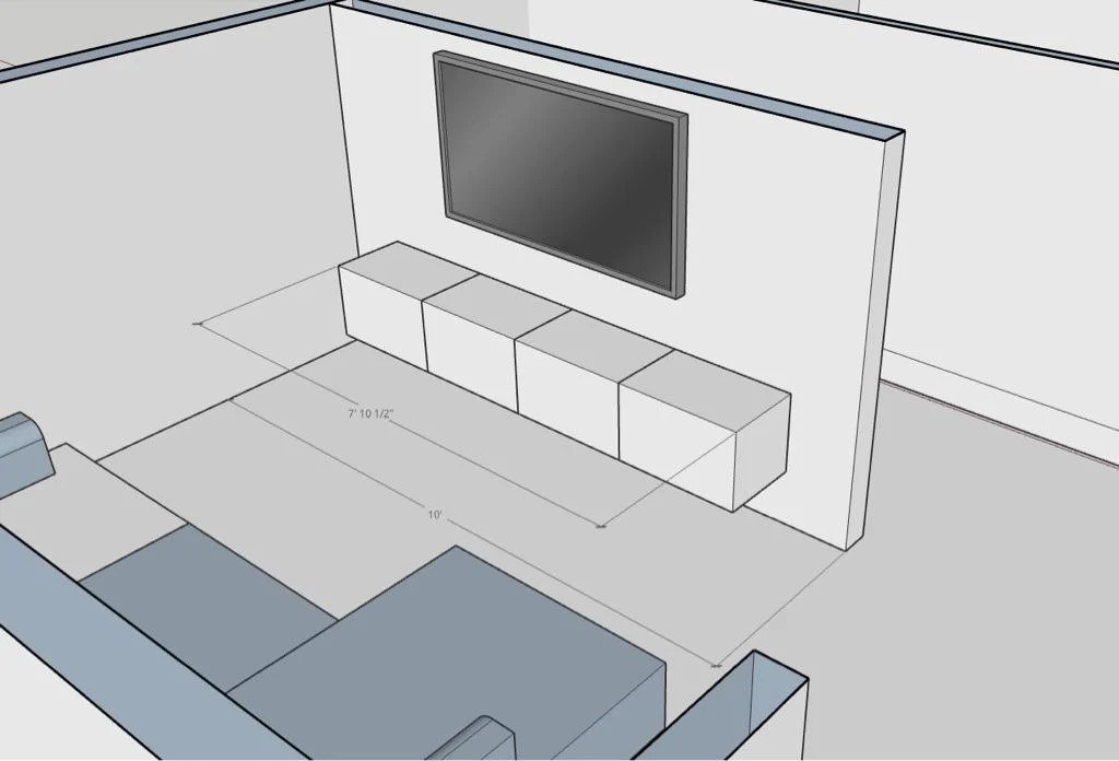

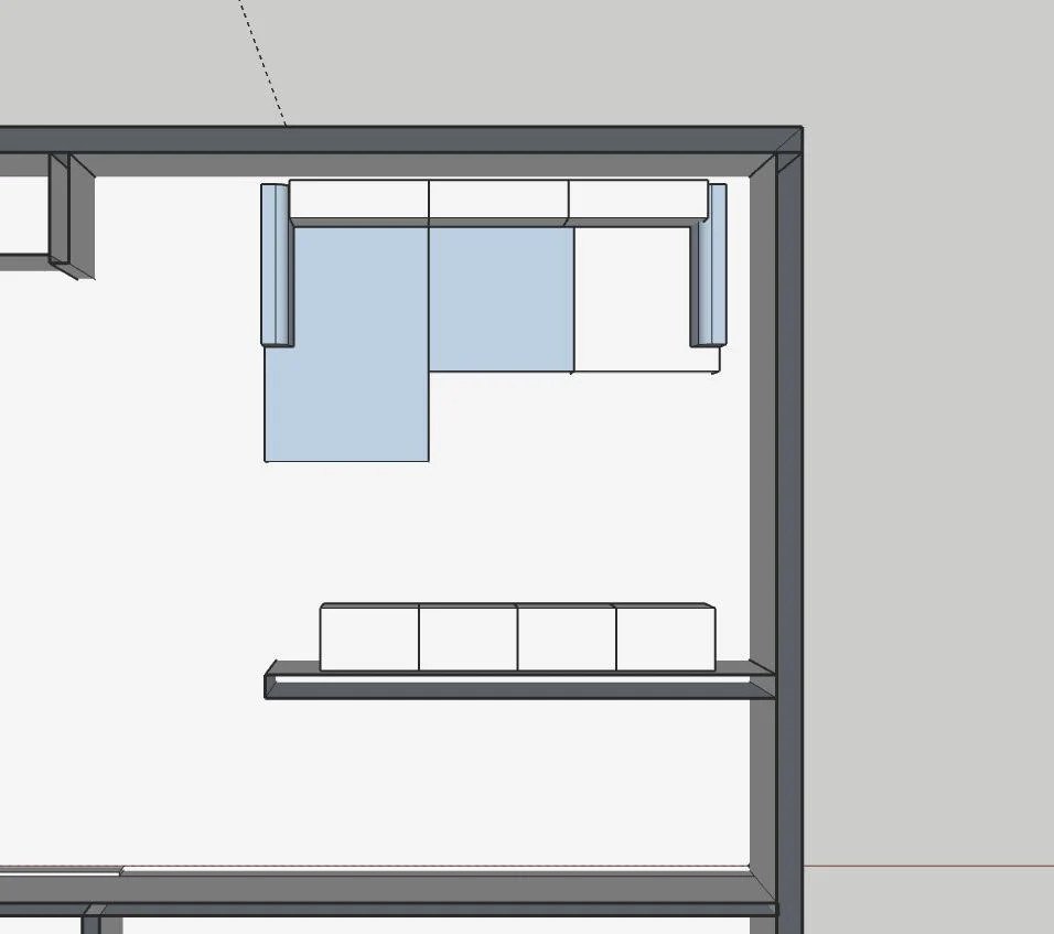

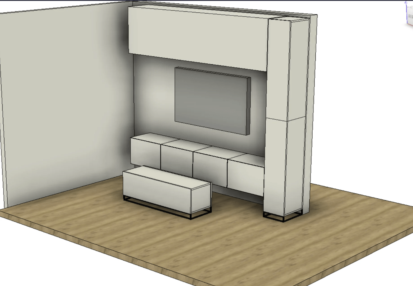

Linked osme picture of my living room in sketch up an fusion with positionning of the table.
table will be 'very near' couch and wall. Like 1 or 2 ft max. I was planning on either, getting the cable under the rug, and poking a little hole in the rug to get the wire out. Or just running it on the rug with some kind of cable hiding tray to hold it still. Its not onlu just go there to sit down and watch tv, not a high pedestrian hallway.
if going slot port, I will dust it using a swiffer or something.
yes, children, 1yo. Thats why, and WAF, I wanna hide the drivers. But if not worth it, Ill go the first box with opposing woofer at the ends with a cloth grill. I just kinda think the slot 'port' looked special and great and without beeing too much 'in your face' would be a good conversation starter and we could even see the woofer moving.

As for the down firing option, by definition, it wouldnt be opposed firing driver?!
