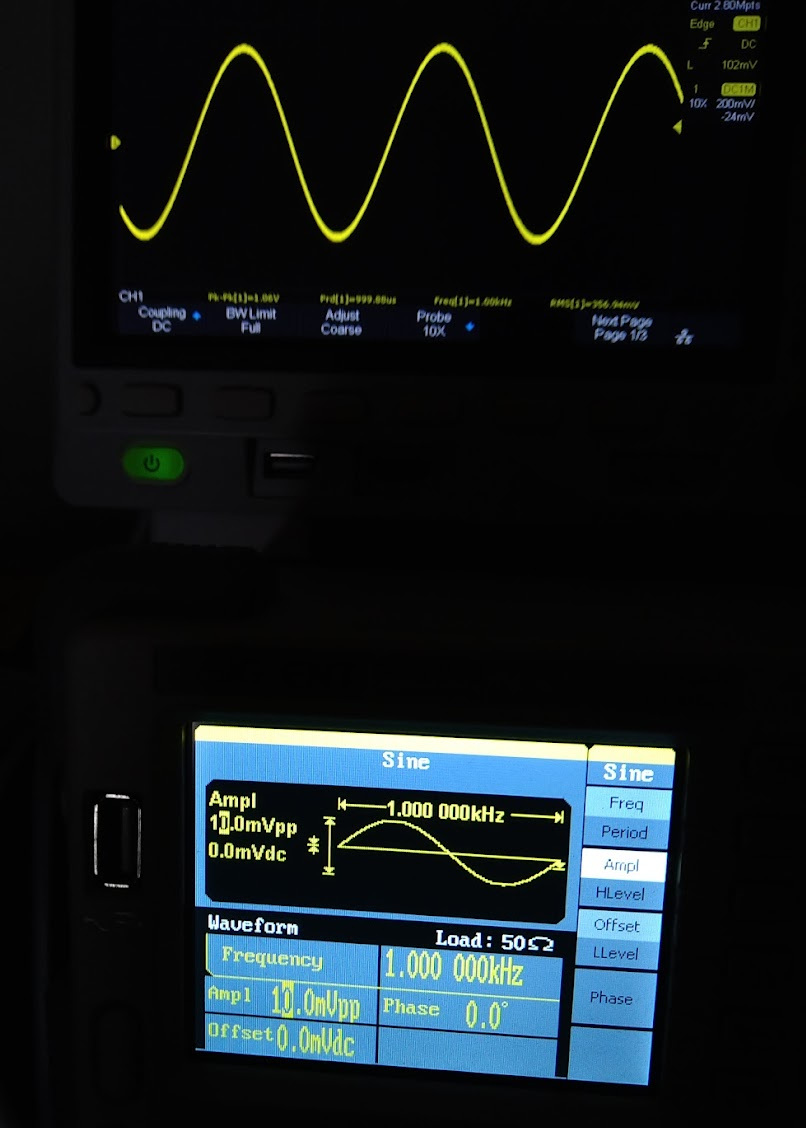

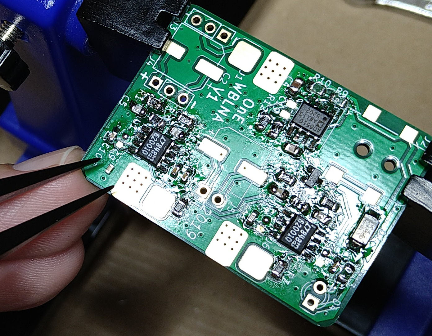

You can show below some picture of my unit and some measurements results.
PCB Kicad 3D view :
Picture of the finished prototype :
100ns pulse test input/output result :

Just wanted to tell I built this amplifier by Frex (thanks again!).
Some small modifications were done. To make it capable of withstanding DC input voltages up to 30V, capacitors C1 is 50V and C2 35V. In addition there are also two anti-parallel 1N4148 diodes (one in each direction) after R1 to GND. Output connectors are isolated from chassis to minimize risk for ground loops.
So far it seems to work fine.
I'm not too fond about BNC connectors in such a small box, though. They will easily begin to rotate (if you don't make correct holes with squared sides). But then you don't have to lock cables, just pushing them onto the connectors is enough.
If one would like to make as perfect as possible chassis for a noise amplifier, take a look at Linear Application Note 159. Inner box Mu metal, middle copper and outer steel cookie tin! 😀
