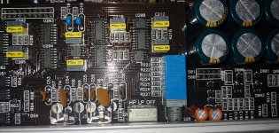

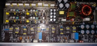

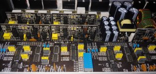

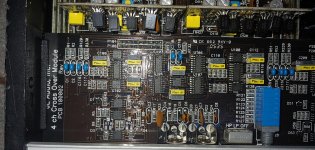

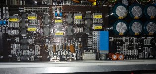

Just went out and did that, no change. I did get the idea to swap left and right RCA'S and then leave left one off. Have sound out of both speakers! So basically if the right channel gets a signal the left works along with it. I opened it up and took some pictures, I don't see anything out of the ordinary, but I am no tech either. Let me figure out how to upload, keeps sending me to Tapatalk
I found some notes that a couple of 300/4s had RF channels out due to a loss of power to the op-amps. The op-amps are on the end of the preamp board near the front speaker terminals. You can get to them without taking the amp apart. Only remove the bottom cover.
Only do this if all else fails.
Don't do this with power applied. You should be able to find it by measuring the resistance between the corresponding power terminals between the nearby op-amps. The op-amps will be marked 2068.
