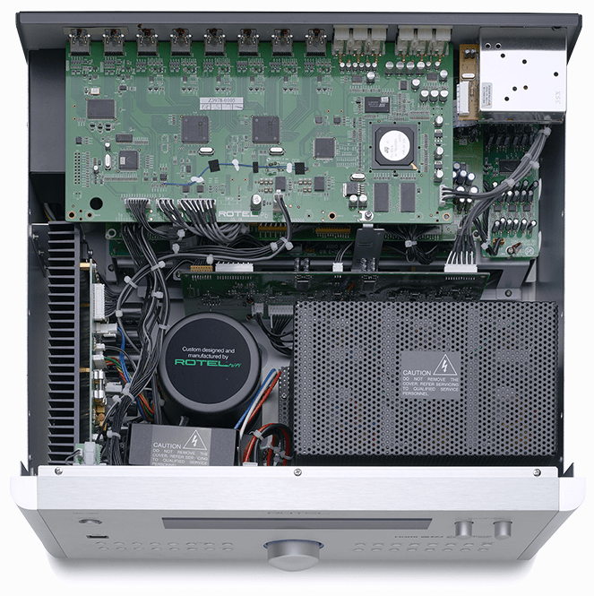

So, my "old trusty"® Rotel RSX-1562 has lately started having some issues. Not sure exactly how old it is, I bought it second-hand a bit over 3 years ago.
Some minutes after turning on (typically 10-20), some crackling noises start coming out of speakers, and it lasts for a good couple of minutes, then they disappear altogether.
However, noises are most audible when HDMI inputs are used (for some reason), and also most audible from center and rear speakers (I have 5.1 setup and typically use 5ch stereo audio mode). My front mains are 4ohm, all other speakers are 8ohm. Also, when audio is switched to stereo mode the crackling noises seem to down a bit, but again it might be to different impedance of the speakers.
To me it sounds like there's some static building up and then being released. It's typically higher frequencies crackling.
From other inputs (analog, coax or optical) noises are much much more quieter and harder to observe (I had to sit on the floor next to the front speakers waiting for crackling to occur) and I only heard them from HF unit (which means they are above 3kHz).
After RSX has been turned off for at least (cca) 30mins, and then turned back on, the weird sounds will reappear.
So far I've tried different computers via bunch of HDMI cables, no difference. Same issue is from my TV box as it also connects via HDMI. Since there's a 7.5m HDMI cable from my PC to RSX which passes by several other power cables and speaker cables, I thought maybe some static can accumulate in it, but wasn't able to prove it so far.
So now I think that something in RSX produces those noises when heated up. I'm in the process of obtaining a different AVR that I can connect instead of Rotel so I can take Rotel apart and check inside.
Any idea as to what might be culprit for these problems? Something inside the RSX or something completely unrelated? My plan is maybe try to replace some of the power caps?

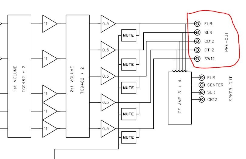

My suggestion is, first you have to isolate 'cracking noise source'. According to Rotel SM it has 7 Class D amp modules.
SL,SR,CB1,CB2 092 ICEPOWER200AC DIGITAL AMP PCB ASSY
FL,FR,C 092 ICEPOWER200ASC DIGITAL AMP PCB ASSY
Please check from the Pre out sockets, refer to above. you can use a head phone but you need RCA male jack wired to a head phone jack since the pre out might be RCA type.
Check all the pre out channels for the cracking noise.
If all the pre out channels are OK and free from noise, identify the noisy speakers and identify the faulty amp modules accordingly.
7x ICEPOWER200AC DIGITAL AMP
If the cracking noise is noticeable in the pre out channels you have to trace back .
Please check the power supply voltages and cracked solder joints, specially dual power supply for analog ICs

I just tried pre-outs, and crackling still persists. Next step is to find/obtain another AVR so I can remove and disassemble this Rotel (I'm unwilling to do so at the moment as all my audio and video devices are connected through it, so removing it would send me back to stone age 😆)

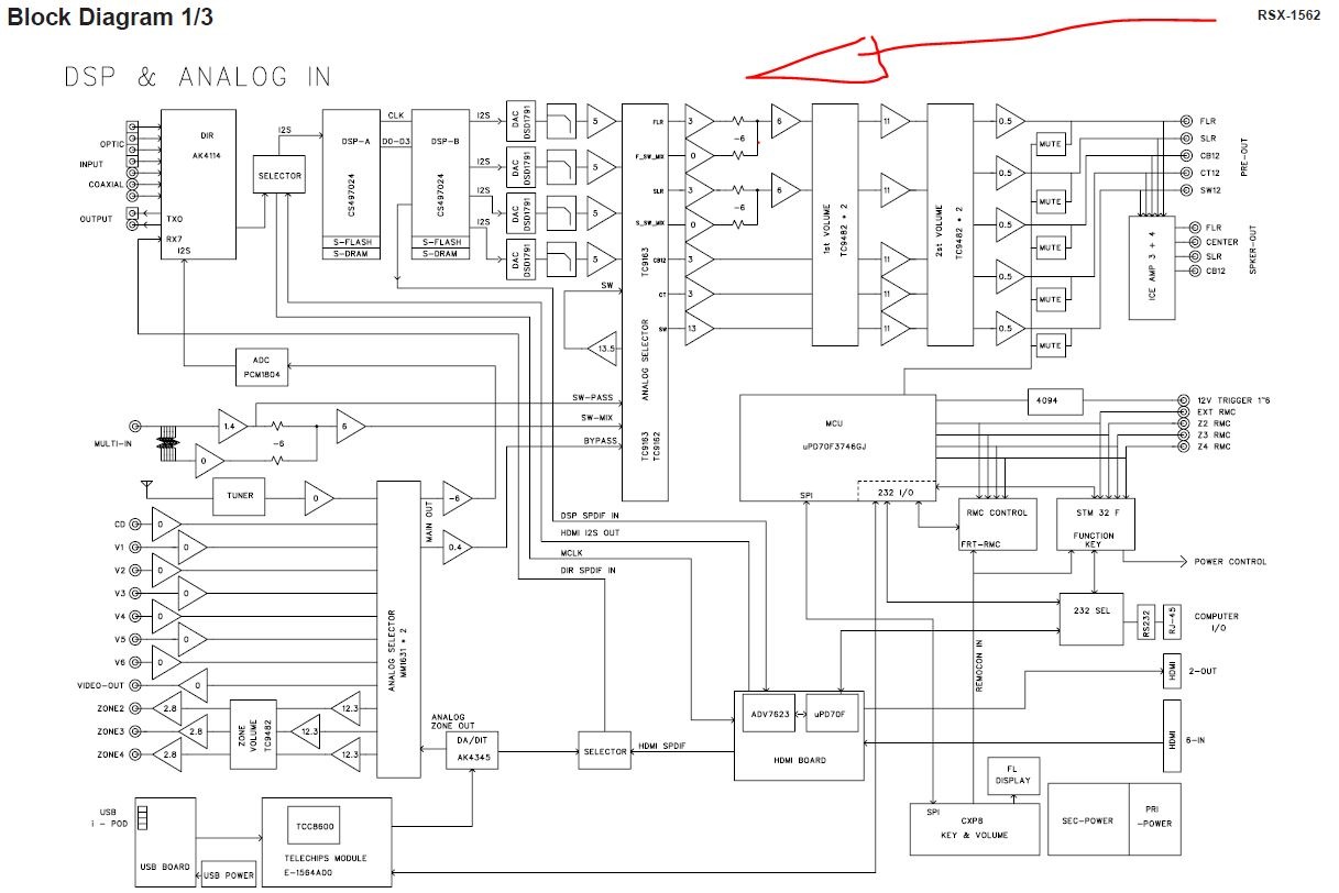

I just want to reiterate once again, the crackling noises eventually "deflate", meaning whatever the mode or settings used, crackling is heard for up to 15minutes, and then it practically disappears (afterwards only a single crack can be heard every once in a while, maybe 1x hour).
Is this still true? If yes the problem is with the digital and DSP section. This is highly integrated and all SMD.Thanks for another great suggestion!

Maybe get an ice spray and try it on the large PCB that you see on top. Picture from Rotel.com

The large DSP chips can evolve problems, as there are countless soldering points between them and the PCB that may fail over time.

I did another test today, just turned the device on on a unused analog input (nothing connected to it). And 20min on the clock, the crackling started. As soon as I switched to bypass, crackling goes away.
So thanks @Turbowatch2 for identifying the problem, apparently it's DSP fault, and the amp is still OK.
