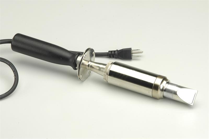

I've been using a Weller 700F closed loop iron for my entire career, and it's great.
Amortized cost around $0.01 per day. You would not believe the heat capacity.
And yet it works well for small connections, which is most of what I do.
Only a couple of times have I needed a larger iron, and it took this one:
