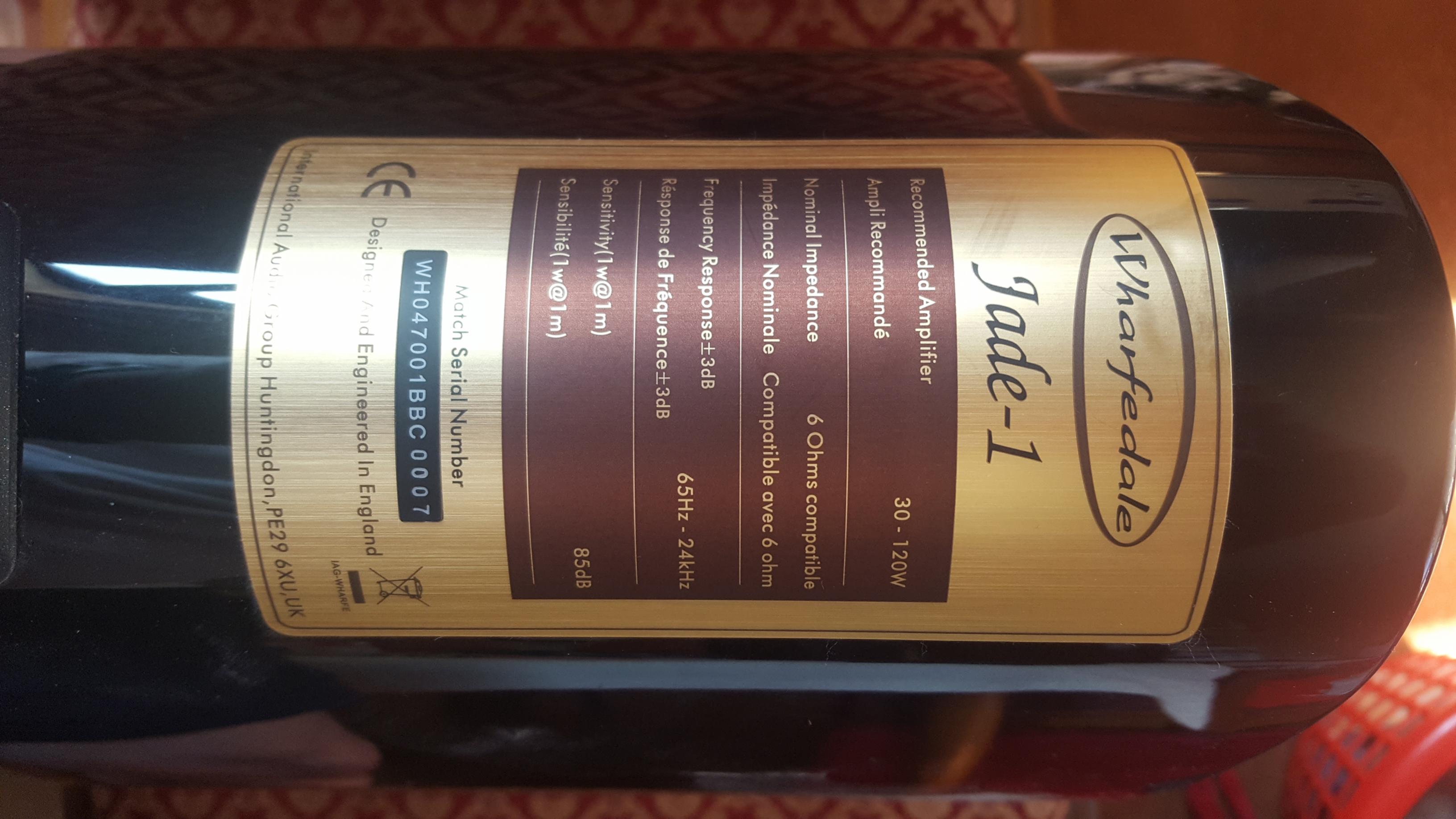

Managed to test both speakers today. As far as I can tell both woofers have blown. Mid range and tweeters both still have continuity.
Here are a few stats for Jade 1 from the wharfedale manual:
3 way aperiodic
Bass driver 125mm Acufibre
Cone mid range 75mm Alu-pulp
Tweeter 25mm Aluminium
6 ohm impedance
Frequency response 65hz -24khz
SPL 2.83v @1m 85db
Rec amp power 30-120w
Crossover frequencies 570hz 2.5khz
Attached pics of drivers and label
With this information can anyone recommend a bass driver woofer of suitable quality as a DIY replacement?
Thanks in advance
First choice wpuld be a proper replacement from Wharfedale.
Allmost none of the data you have specced help with chosing a potential substitute.
dave
