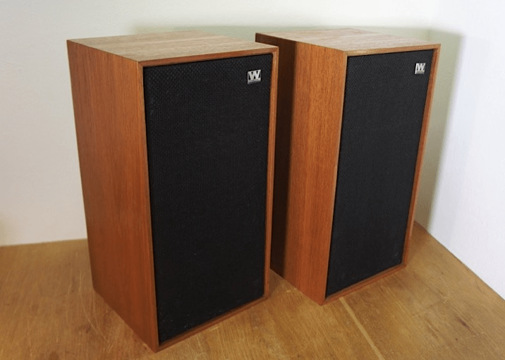

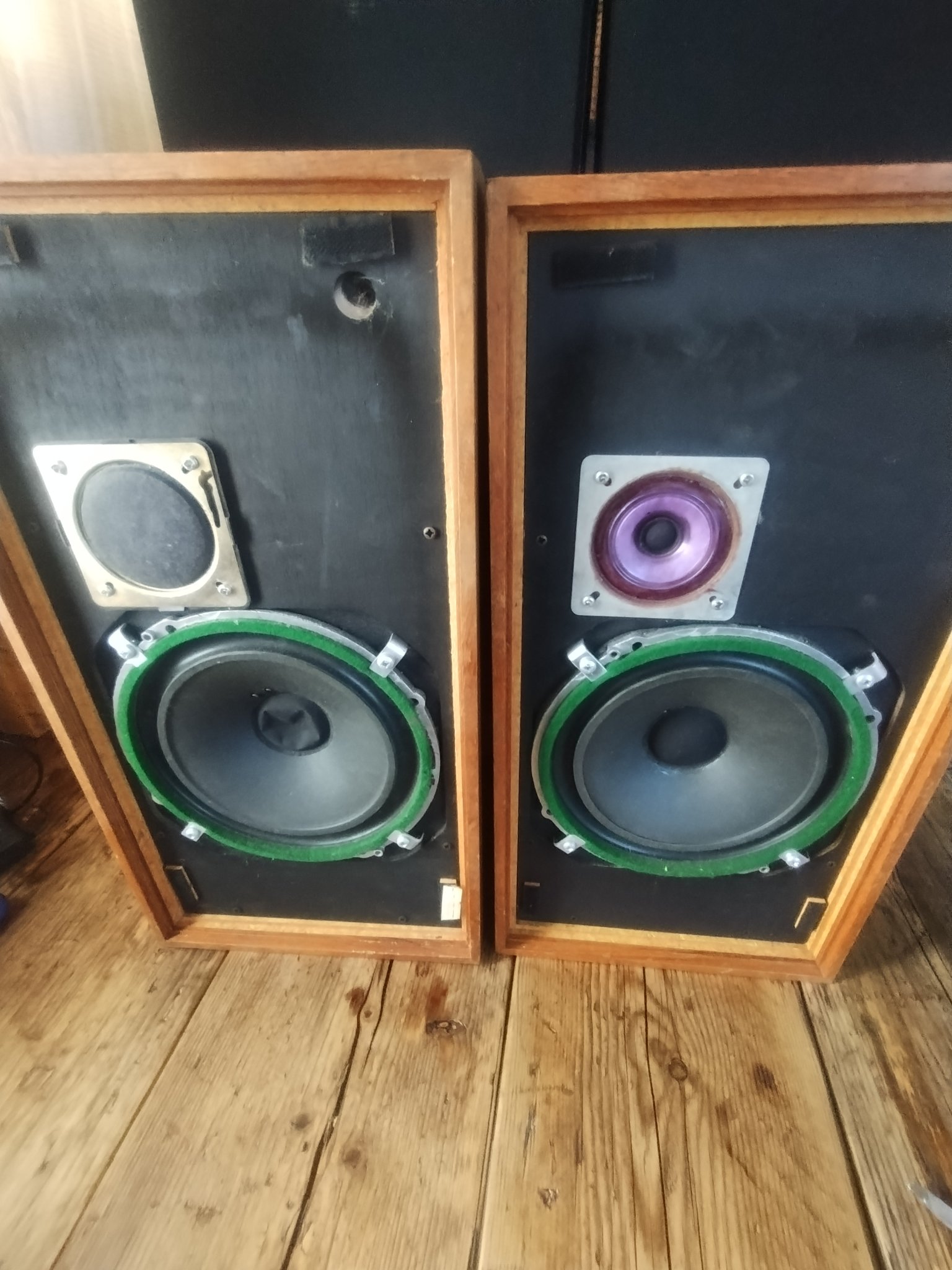

I have a pair of these. Cause I like lost causes I would like to refurb to a reasonable extent. To my ears classical music is nice and open and the stereo imaging is pretty decent.
If I was to do some checking, reasonable maintenance to keep any costs within the worry of these speakers what would you do?
The drivers are all pretty decent and everything on a visual check is as it should be......I think. 😜

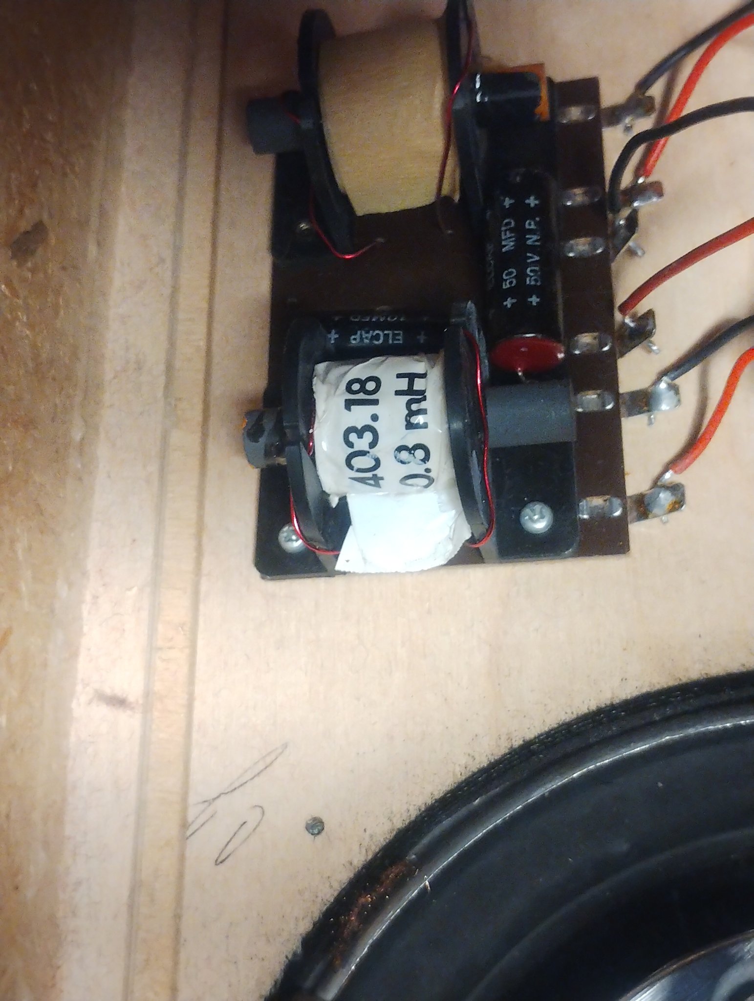

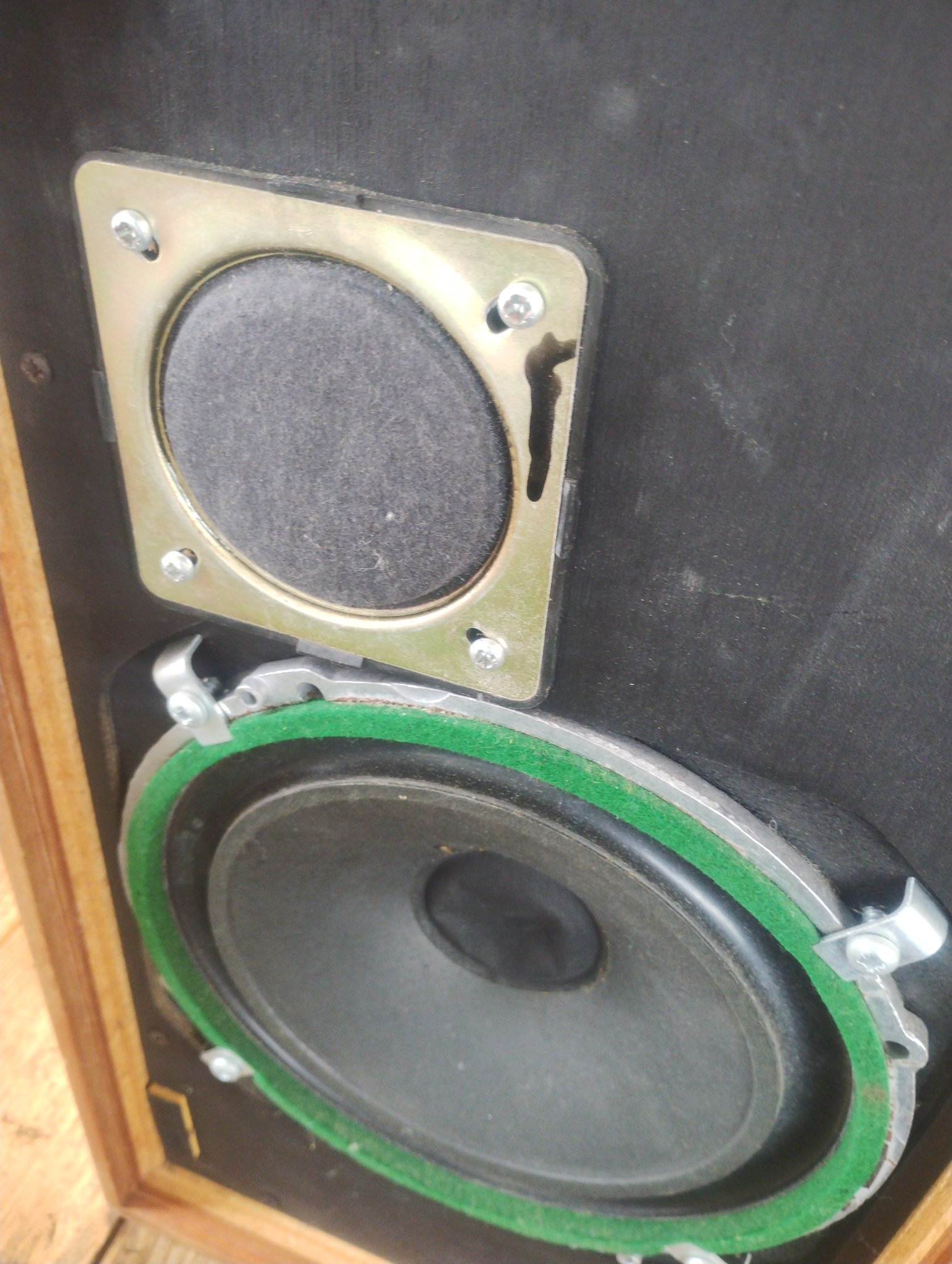

Here are some pics. It looks like either one tweeter is missing a cover or they are two different tweeters.
The crossovers do indeed look old. They also seem to be glued to the front baffle which would make replacing components difficult would it be possible to get new crossovers and keep the originals in place but disconnected.
I think the values can be made out in the pics?

The crossover will be screwed to the front baffle. The screws pass through holes in the black plastic coil formers. Two such screws can be seen at bottom left and right of your third image.
It looks like we have 10 uF, 50 uF, 0.8 mH plus one unlabelled inductor.
The alloy framed bass drivers indicate that this is an early version of the Linton, which is a good thing.
The tweeters are different, but both are Wharfedale units. I believe I have information on each of them, but will need time to locate it.
All you really need to do initially is to replace those unreliable ELCAP capacitors:
The 50 uF capacitor can be replaced by the current standard value of 47 uF. The 10 uF is a current standard value.

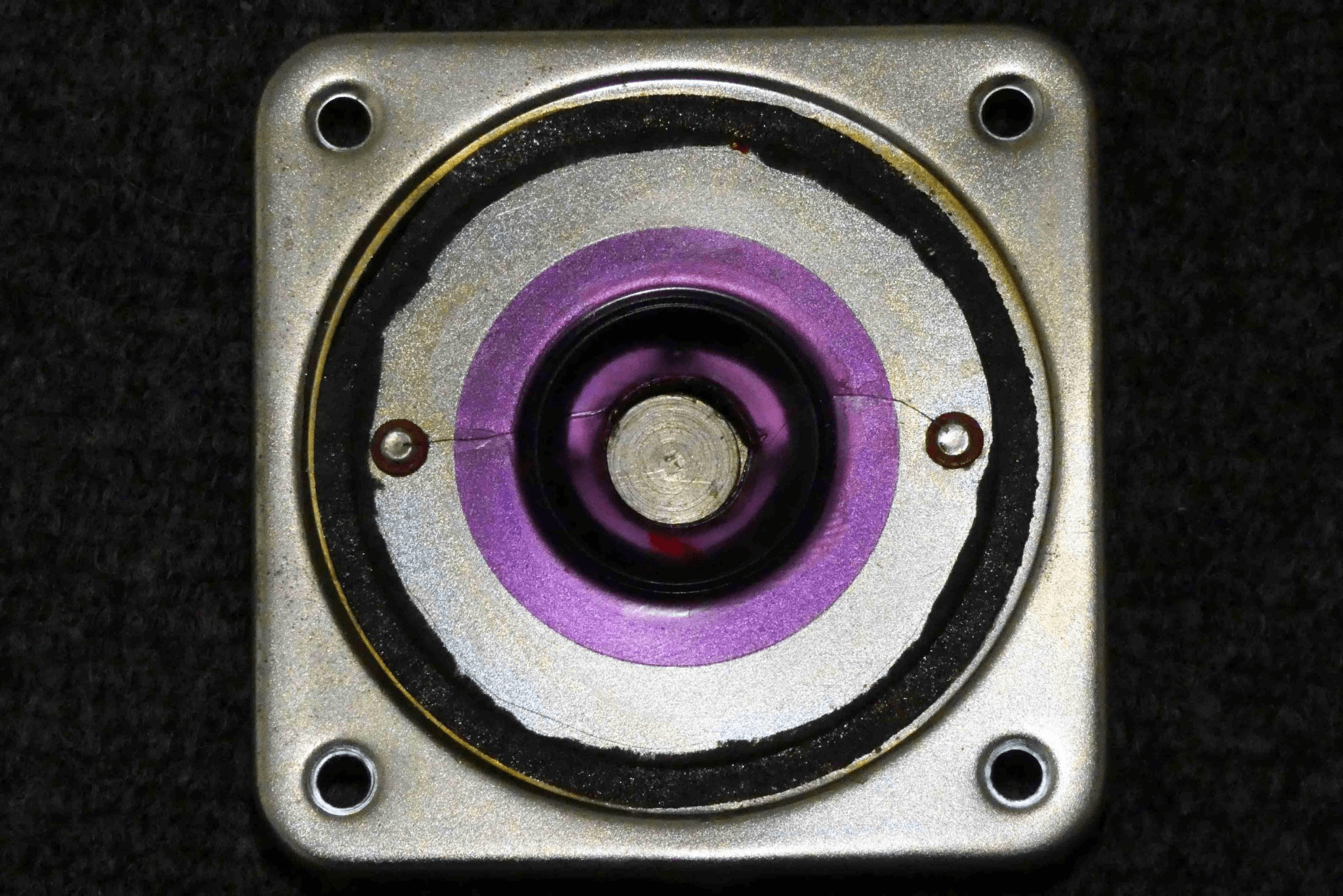

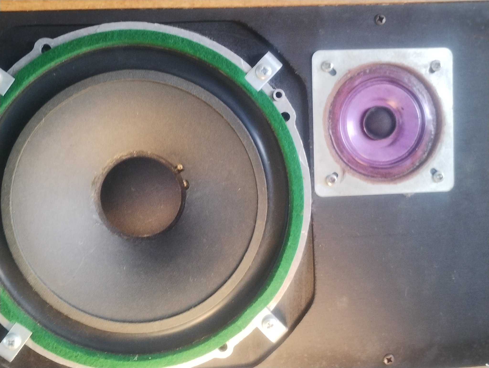

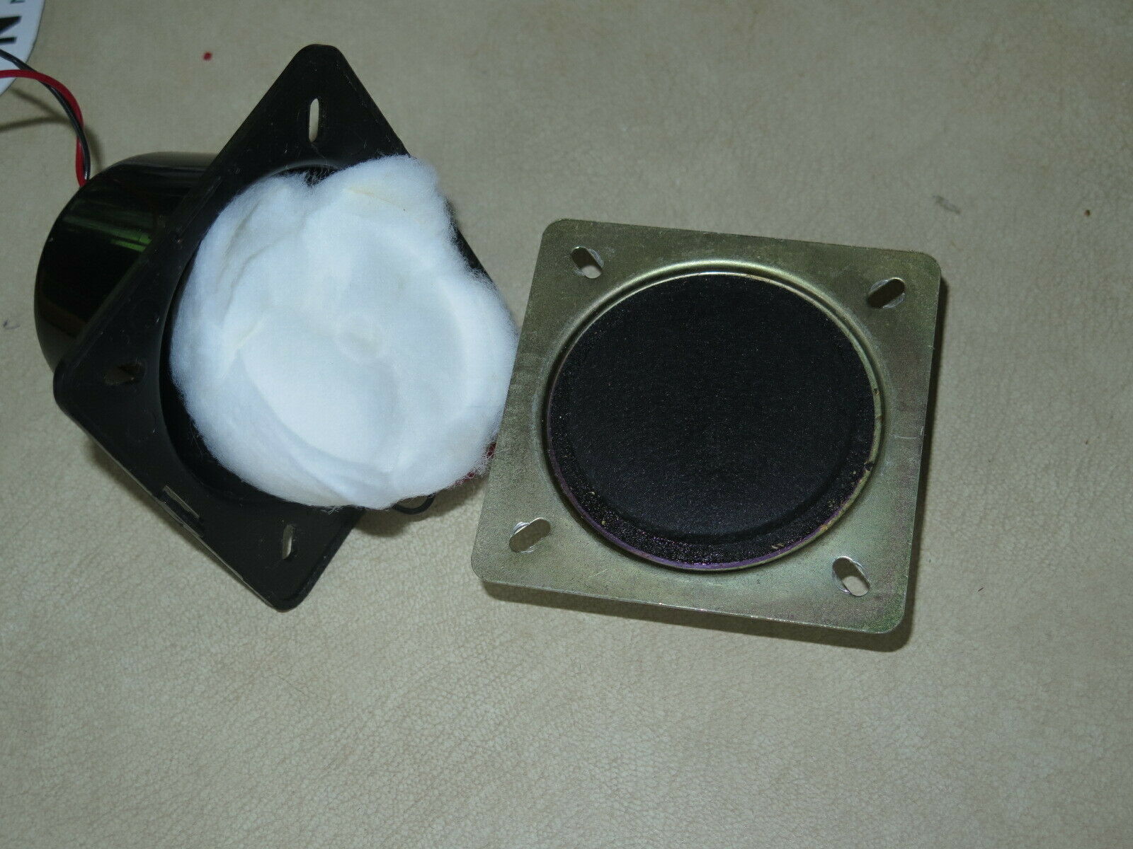

The tweeter in your left speaker cabinet has an acoustically transparent external dust cap that should not be removed.
Here is what the synthetic purple cone looks like underneath the cover (note the open voice coil gap):
Please post pics of the rear of both tweeters, identifying which is which.
EDIT: The covered tweeter looks to have a black plastic housing (cup) at the rear as shown in the attachment below.

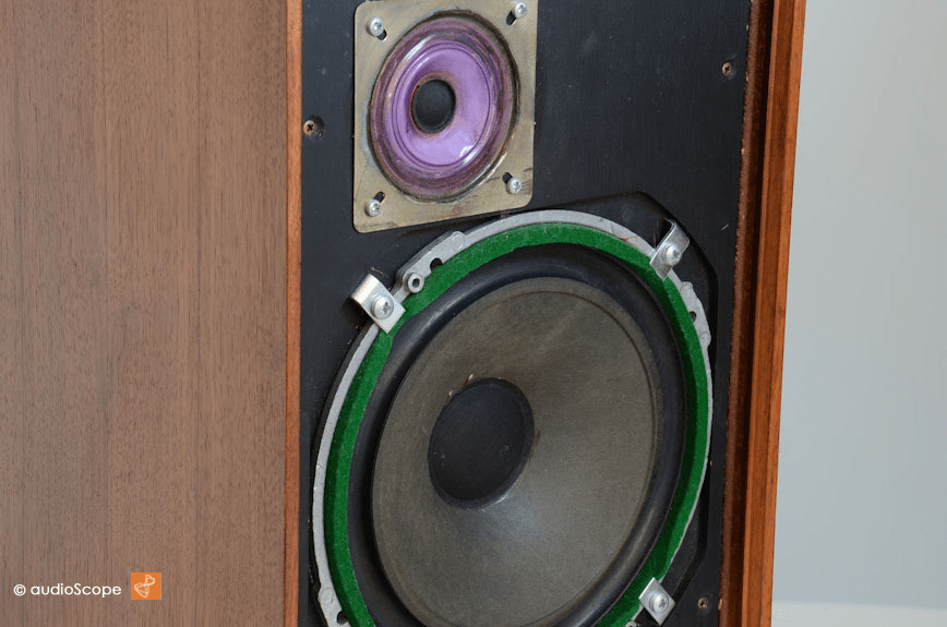

The Linton 2 has a mid-range/treble unit which the bass driver crosses over to at a low frequency of 1,200 Hz - i.e., it is not simply a treble unit.
Your right hand cabinet would appear to contain the period correct mid-range/treble unit - as indicted by the stock photograph below:
The left hand unit appears to be like the one shown in the attachment of post #10, which may be identical to the right hand unit but for the external cover:
Please tell me what you see at the back. Are both of those little units mounted in a black plastic cup?

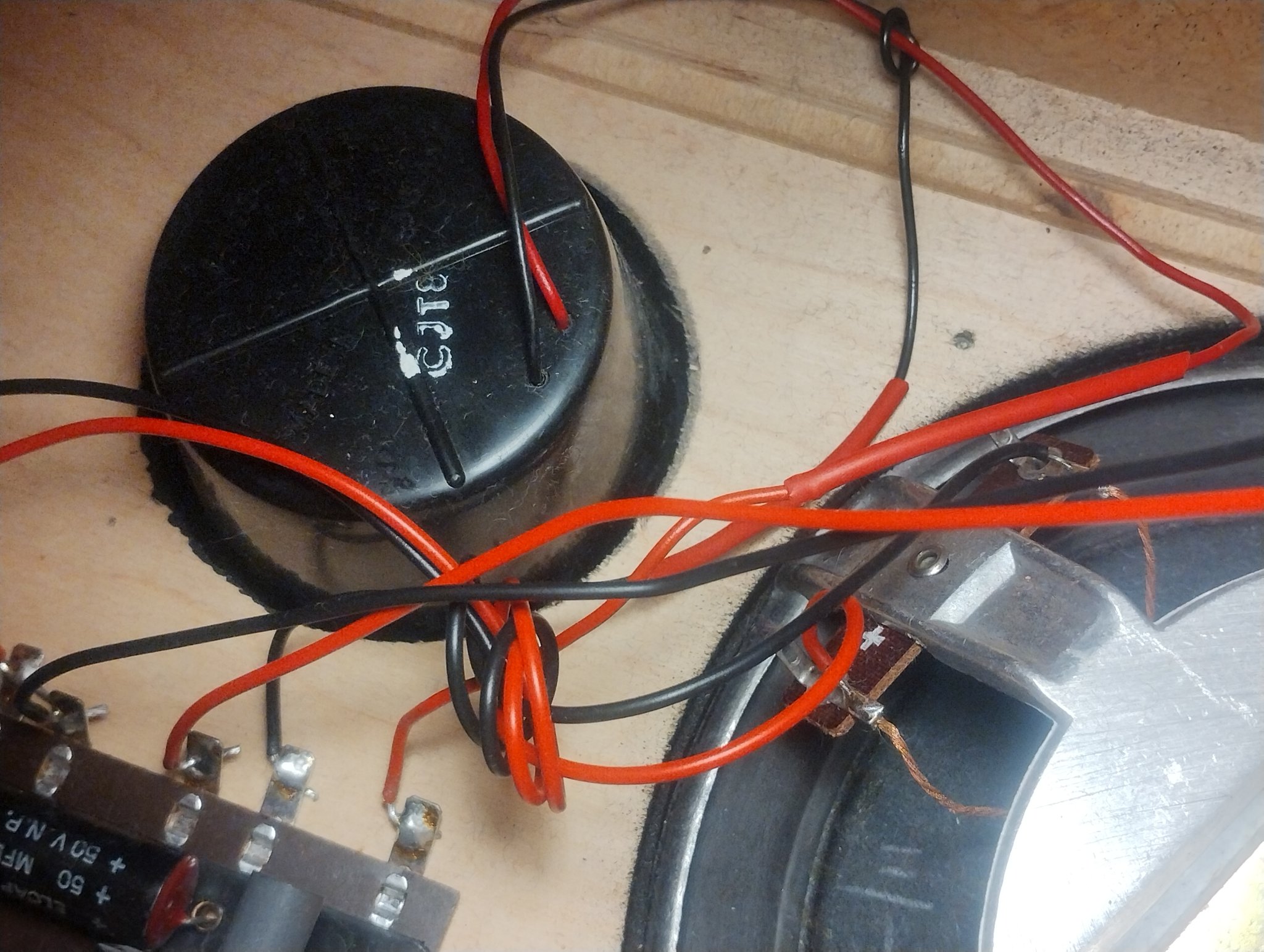

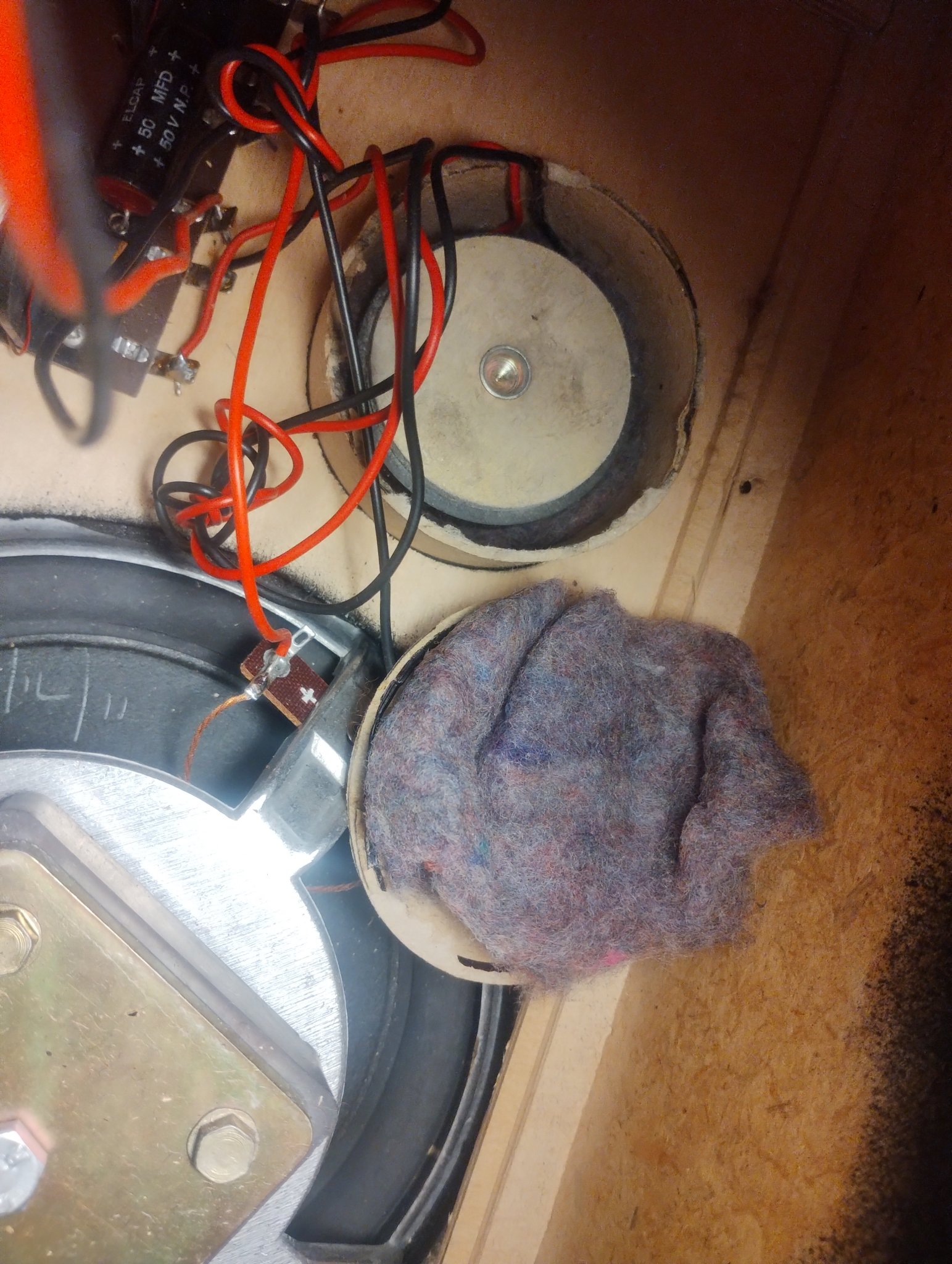

Once again many thanks for your valuable help.

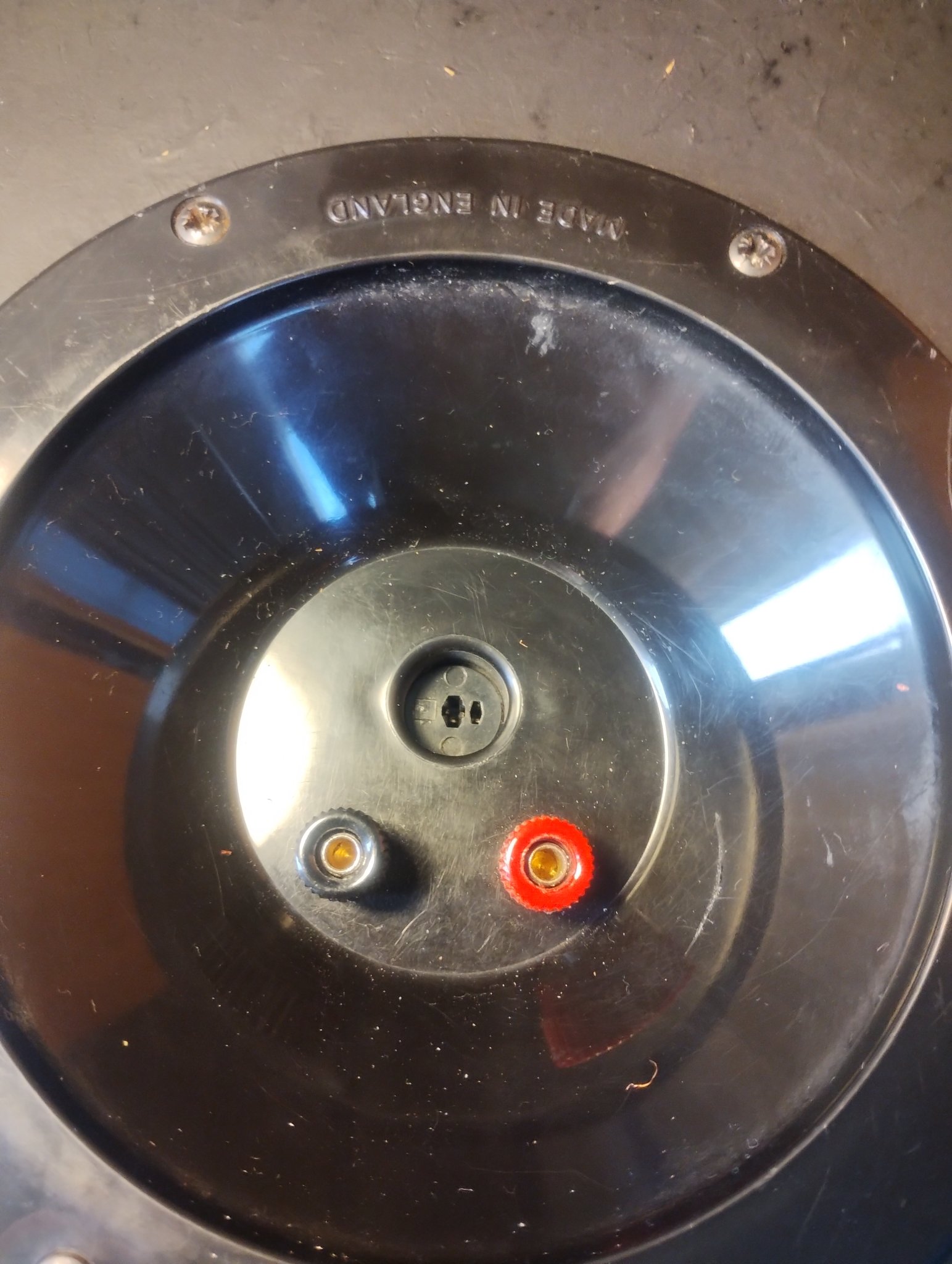

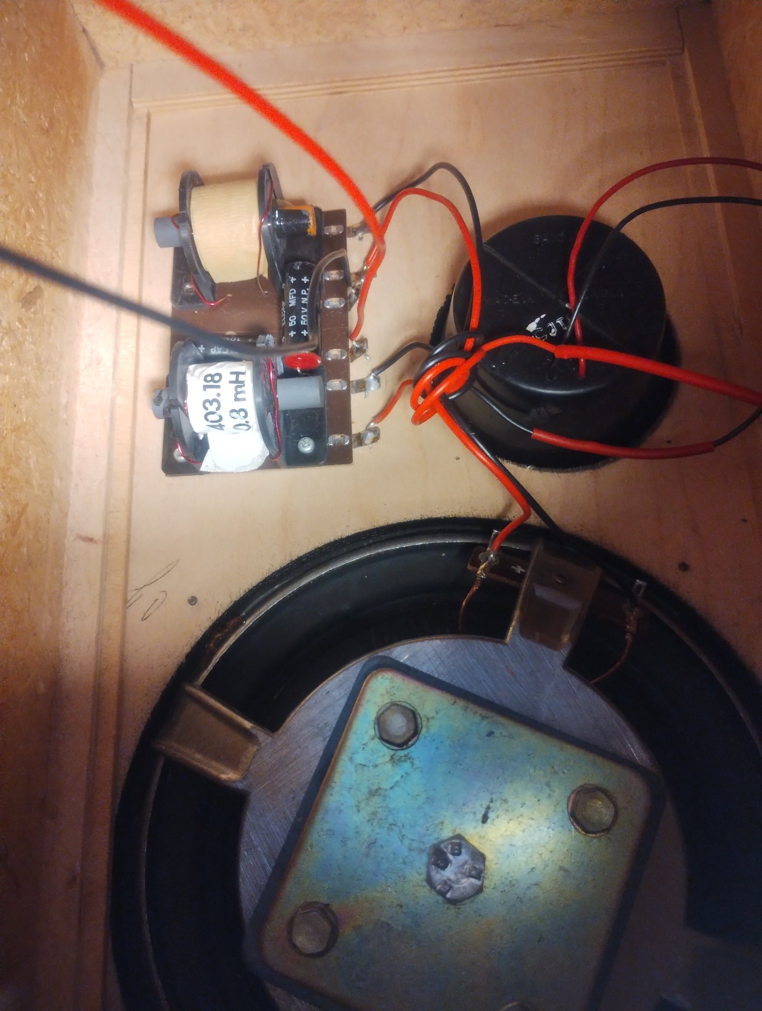

Ive attached pics:
The "left" speaker with the grill on the tweeter, from the inside, has a plastic cup with the text "CJ18" written in white ink.
The "right" speaker that is pink in colour with no grill is within a wood fibre cylinder that also had wadding in it with a circular wooden cover (can be seen in pic).
Also when I removed the cross overs they were stamped with a date on the back "1978" 🙂

The date on the crossovers is a surprise as it doesn't quite fit my timeline!
The fact that both drivers are mounted in their own sealed and damped rear enclosures confirms that they are each proper mid-range/treble drivers.
It may be that the one on the right is original while the one on the left with the plastic cup is a later replacement?
As additional confirmation, I've now seen photos showing that Denton 2 mid-range/tweeters came in both covered and uncovered versions.
So it appears you are good to go with simply replacing the capacitors and experimenting with the amount of acoustic wadding in the main enclosure.
