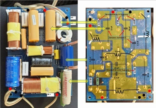

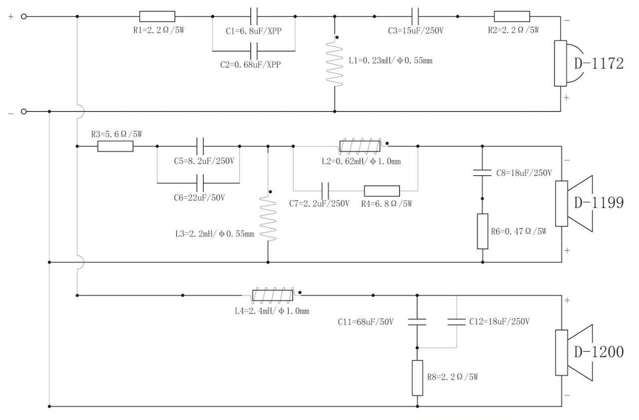

Hi, I wanted to upgrade the crossovers of a Wharfedale Linton 85th. I was trying to find out what the signal path is before reaching the driver so I found a schematic online and various images. Looking at the schematic it looks like after the signal reaches the tweeter, it goes through R2, C3 and then through L1 for the second time before go back to the circuit's minus. This seems a bit odd and I was wondering if the polarity of the drivers could be displayed incorrectly here. Why would there be components after the drivers? Can someone explain?
Here is an image of the path on the crossover board.
Thanks for the replies. I still don't fully understand the schematic. Current flows from the circuit's plus to minus so there still is an order in which current passes through the components, including the parallel components, right? If so what is that order? Correct me if I'm wrong. And why are the tweeter and mid driver's plus and minus reversed compared to the bass driver?
The plus and minus symbols on the driver terminals simply indicate the phasing. If a 1.5 V battery were connected across the terminals in that polarity, the driver cone would move outward.
The electrical out of phase connection of the mid and hi drivers in this crossover is necessary to ensure they are acoustically in phase with the woofer.
I suggest you start off by analysing a simpler crossover circuit - such as the one attached.
The Linton 85's crossover contains additional response shaping components in addition to the essential crossover components, making it difficult to analyse.

It flows both ways.flows from the circuit's plus to minus
It passes simultaneously.so there still is an order in which current passes through the components,
..and less current means more Voltage.Current flows
Thanks! Now the schematic makes sense.The plus and minus symbols on the driver terminals simply indicate the phasing. If a 1.5 V battery were connected across the terminals in that polarity, the driver cone would move outward.
This one I can understand. I'll try and put the Lintons in Xsim to get a sense of what some of it does.I suggest you start off by analysing a simpler crossover circuit - such as the one attached.
Not dissatisfied nor a certain expectation. I know the opinions vary on the effect of component upgrades. Some have (very) very strong opinions. I want to see for myself and learn something about crossovers. Nobody will die if my resistors are overspec'dThat makes me wonder what audible improvement you are looking for.

This one is hard to grasp. The components are in a certain order and the output is different if that order was different, no?It passes simultaneously.

You seem to be trying to say yes or no to each component based on what you see. I would suggest there's more to it than appearance.The components are in a certain order and the output is different if that order was different, no?
You are experimenting.. and that's OK. So do all components make a difference? Maybe none do? Why are you attempting to determine if only half of them do, without any evidence? If someone were identifying the operating conditions and parameters responsible for changes in sound, then I'd expect them to seek them out via measurement or similar analysis.
Crossover upgrades ordinarily involve determining the component values, the circuit itself. If that's good, then why not get yourself some EQ for the speaker overall, and find a good location for it.
I am curious: when substituting the electrolytics that are being bypassed with PP, wouldn't it be a wise choice substituting a pair for an equivalent one since they are in parallel?Capacitors: the majority of caps in the standard crossover are polypropylene. There are some high value electrolytics but they are bypassed with PP caps to reduce any distortion. So is there any reason to replace them? You could replace the electrolytics with a load of PP types but you’ll have trouble fitting them on the PCB.
For example the woofer has two: 68uF and 18uF. Could we put a 82uF standard value instead and get better performance with less components? It's only 4uF less.
The midrange has 22uF and 8.2uF. Could we put a standard value 33uF in spite of a 3uF difference?
Or is it better to substitute for same values one to one?

Hi wyup!
Those 'strange' parallel combinations of capacitance in this carefully designed crossover have been arrived at through careful analysis of the response of the speaker.
Your substitutions would change those values by 5% and 10% respectively, enough to change the response from that which the designer intended.
Rest assured that Peter Comeau knows what he is doing!
P.S. Looking at the photo of the crossover board in post #1, both the 8.2 uF and 18 uF are yellow film capacitors.
The 22 uF and 68 uF they are in parallel with respectively are electrolytics because equivalent film types would be large and expensive.
