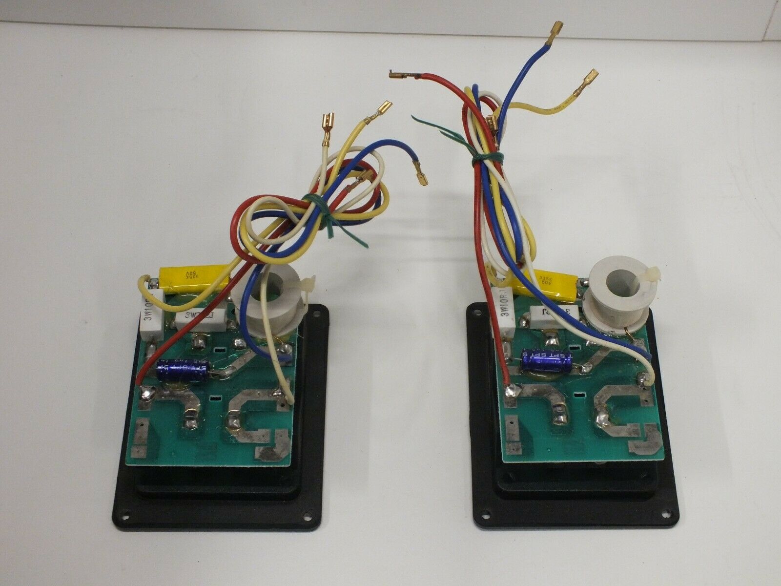

Please note that the crossover shown in my attachment is that of the Sapphire 83, not that of its big brother the Sapphire 87.That little electrolytic is a good quality one, or mediocre?
Hopefully, msj965 will soon be in a position to post a photograph of the Sapphire 87 crossover, after which we can examine its components.

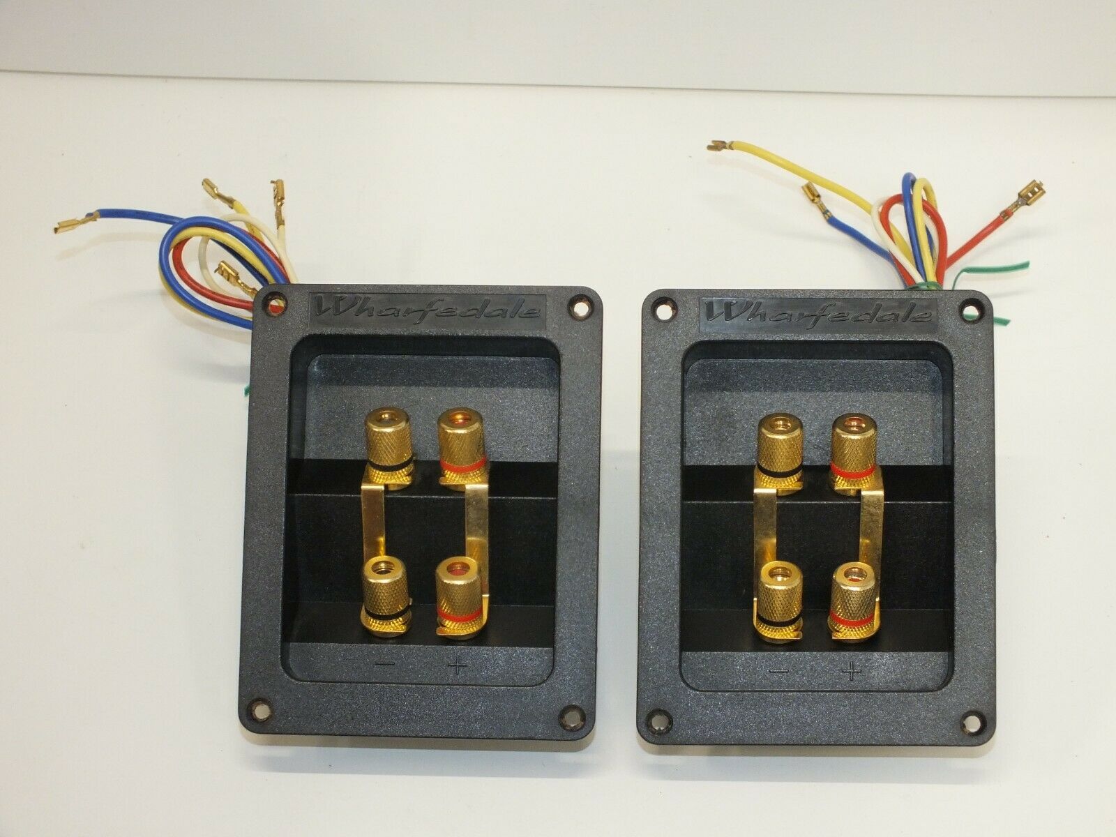

Hey Galu just unscrewed the back mounting terminal post but no luck maybe the crossover is still mounted at the center of the box. Ived searched the internet even the block diagram of this particular model but still nothing. Ived tried frying the plastic facia but scared ruin it up. Hope on this site guide me and give me illustrations how to dismantle this speaker.
