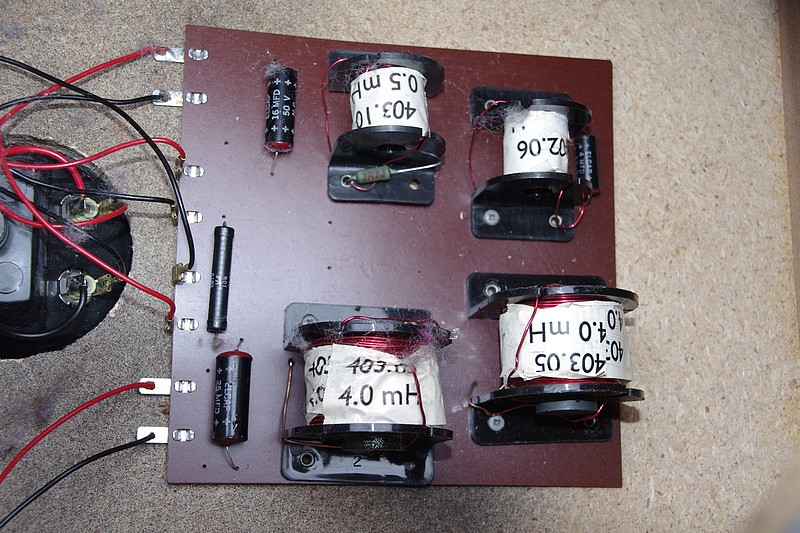

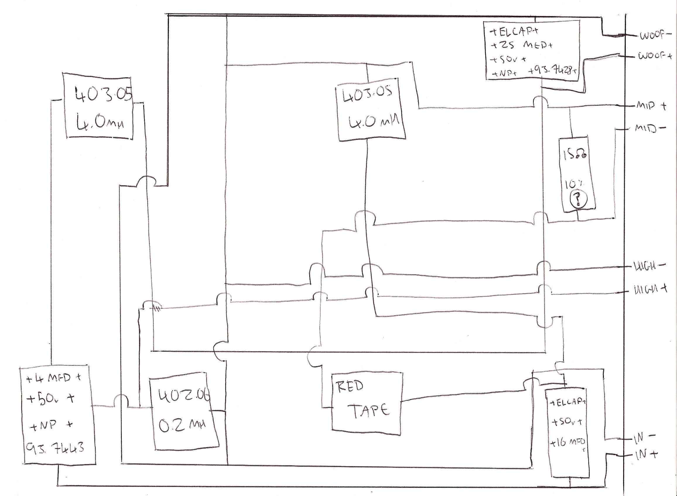

Here's the actual 3XP board which reveals the missing "red tape" inductor value to be 0.5mH.
There's also a sneaky little 2.2 ohm resistor alongside that 0.5mH inductor!
Second order high pass 4uF serial cap and 0,2mH parallel inductor indicate a 4 ohm tweeter crossed at 5,5kHz (Bessel). If we could compare the XP2 that would help.

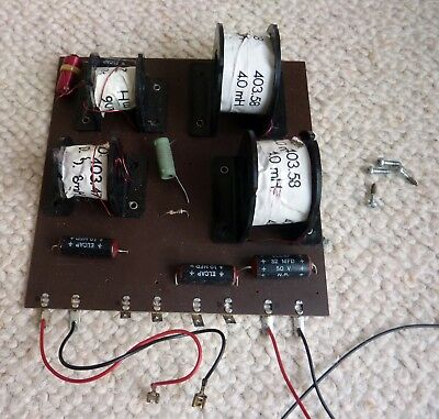

The Glendale XP2 board is shown in post #9, if that's of any help.

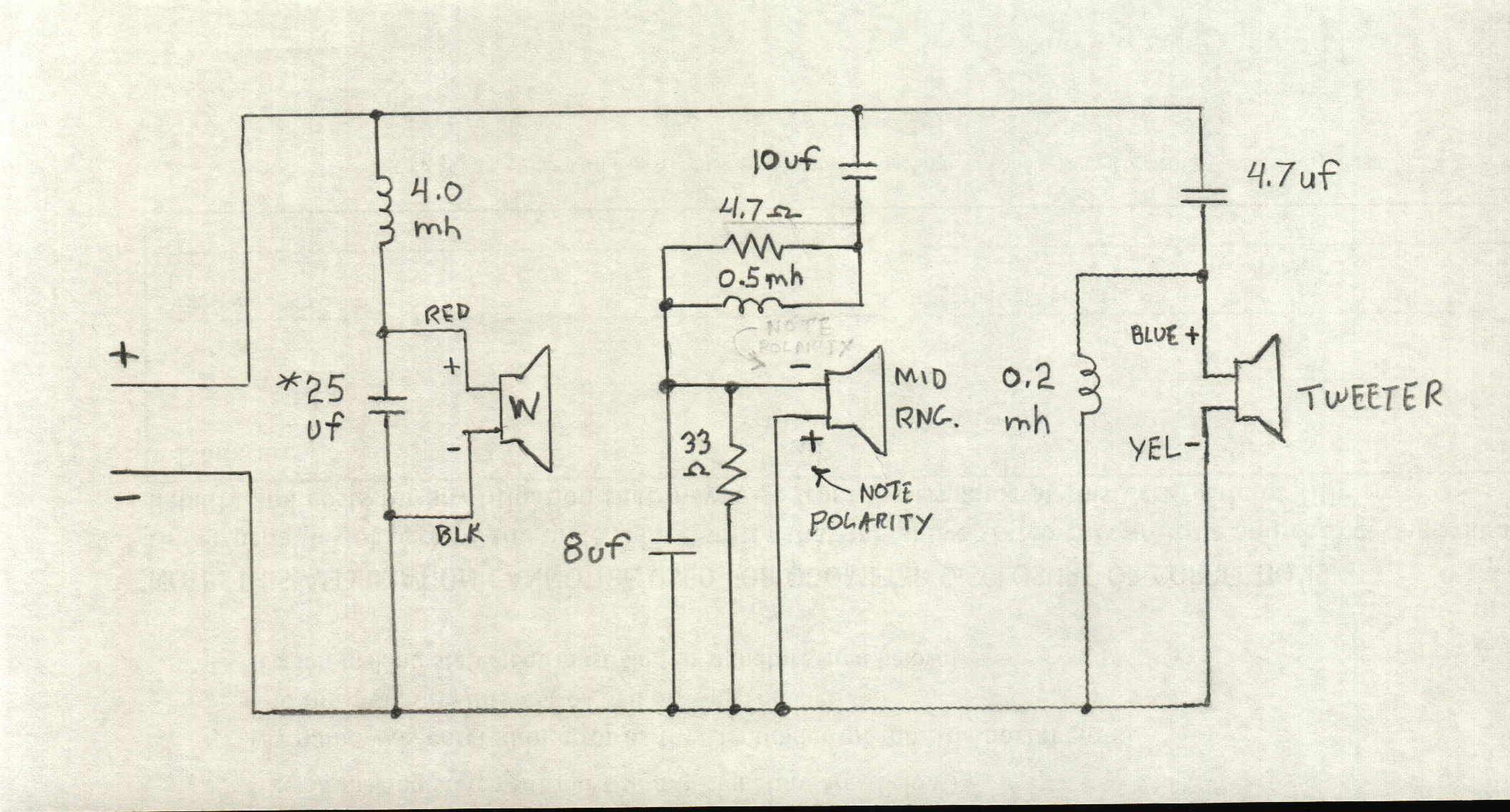

Below is the Linton XP2 crossover schematic which will be similar to that of the Glendale XP2.
The mid and tweeter of the Linton XP2 are the same as those in the Glendale XP2, which has a 10" woofer instead of the Linton XP2's 8" woofer.
