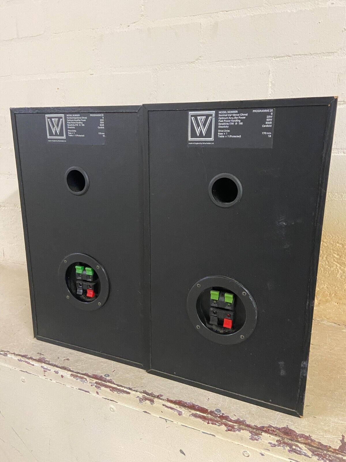

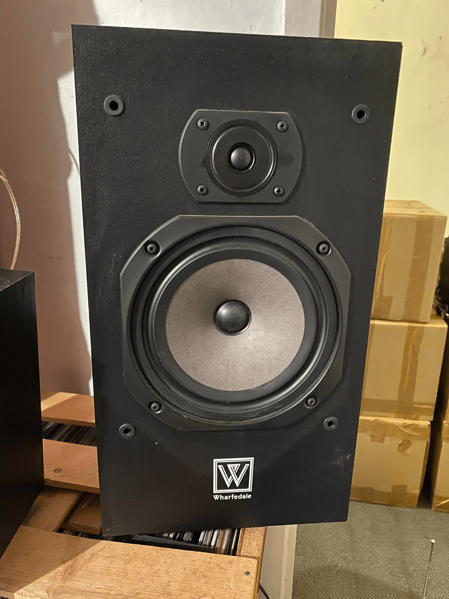

Thanks Galu. I can't seem to find the exact model on the 'net but here are some pix of the actual ones I have here.............. I'll get some pix when I look into the crossover too.

I'll be interested in seeing the condition of the internals.
I have learned that this particular Programme range was intended for commercial use, e.g., in association with a jukebox in a pub.
Such speakers can lead a challenging life. However, the pair photographed appear to be in good nick and may only have been used domestically.

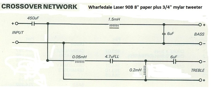

I have dug up a picture of a Wharfedale Laser 90B which might be similar, though I would expect a polyfuse in front of the 0.05mH coil in this case.

Thanks for all the replies. Sorry for the GIANT images - they are what the owner sent me before I collected them. AFAIK they have only been used in a domestic setting although they may have had a long-run of cable to them previously. I'll get the crossovers out and post a (smaller) image of them later. Both speakers cut-out after a loud half-second hum/buzz and, as I say, will only fire-up again by turning the amp off and back on again
Whelkie, does the Programme 50 have those two green terminals above the red and black ones as seen on the Programme 20 image I posted earlier?

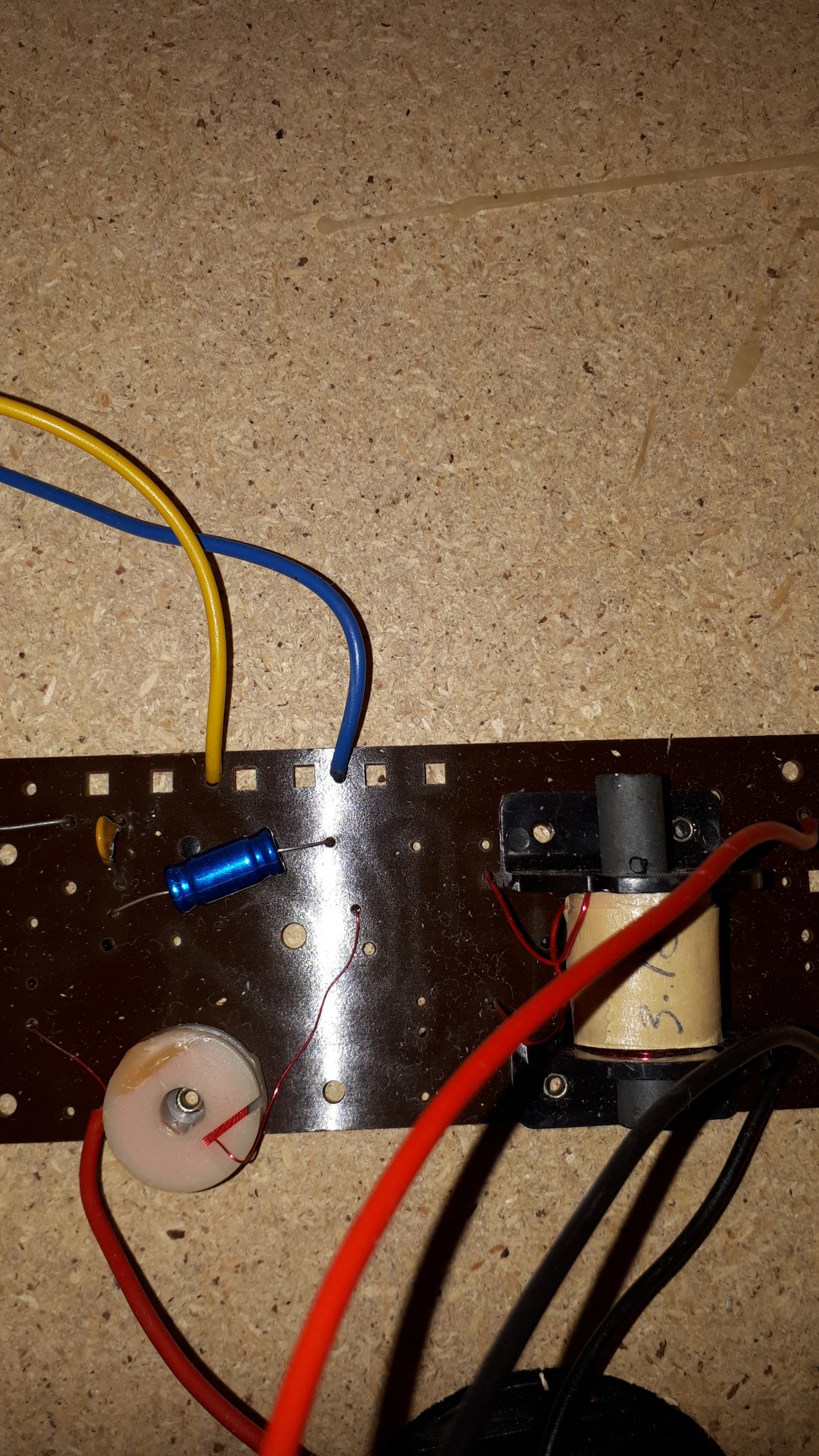

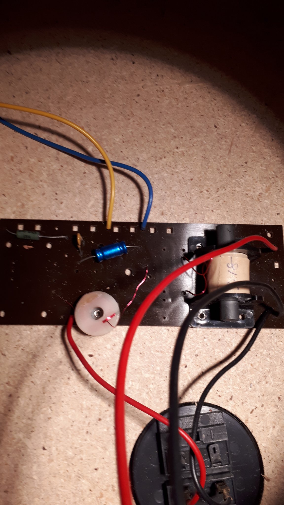

Here are some pix of one of the crossovers. Sadly, it seems they are glued to the cabinet quite firmly, so if anyone has any tips for safely removing them to inspect the soldering etc. it would be much appreciated............. Sorry if the photos have come out large again
Yes Galu, it does have the two green terminals but they are not connected to anything - just a couple of lugs inside.
The Positec protection device is the small mustard coloured disc at top left. Can you measure its resistance just for interest's sake?
There's nothing remarkable regarding the crossover. Looks like a ferrite cored inductor in series with the woofer and a second order capacitor/inductor filter for the tweeter. Also an attenuating resistor in series with the tweeter as will be the Positec.
Next thing is to measure the DC resistance of the woofers and tweeters.

It is a simple 3.18 mH bass coil and second order tweeter here. The tweeter has a level adjust resistor and a polyswitch.

This particular speaker doesn't seem to use a professional transformer option, Naresh
