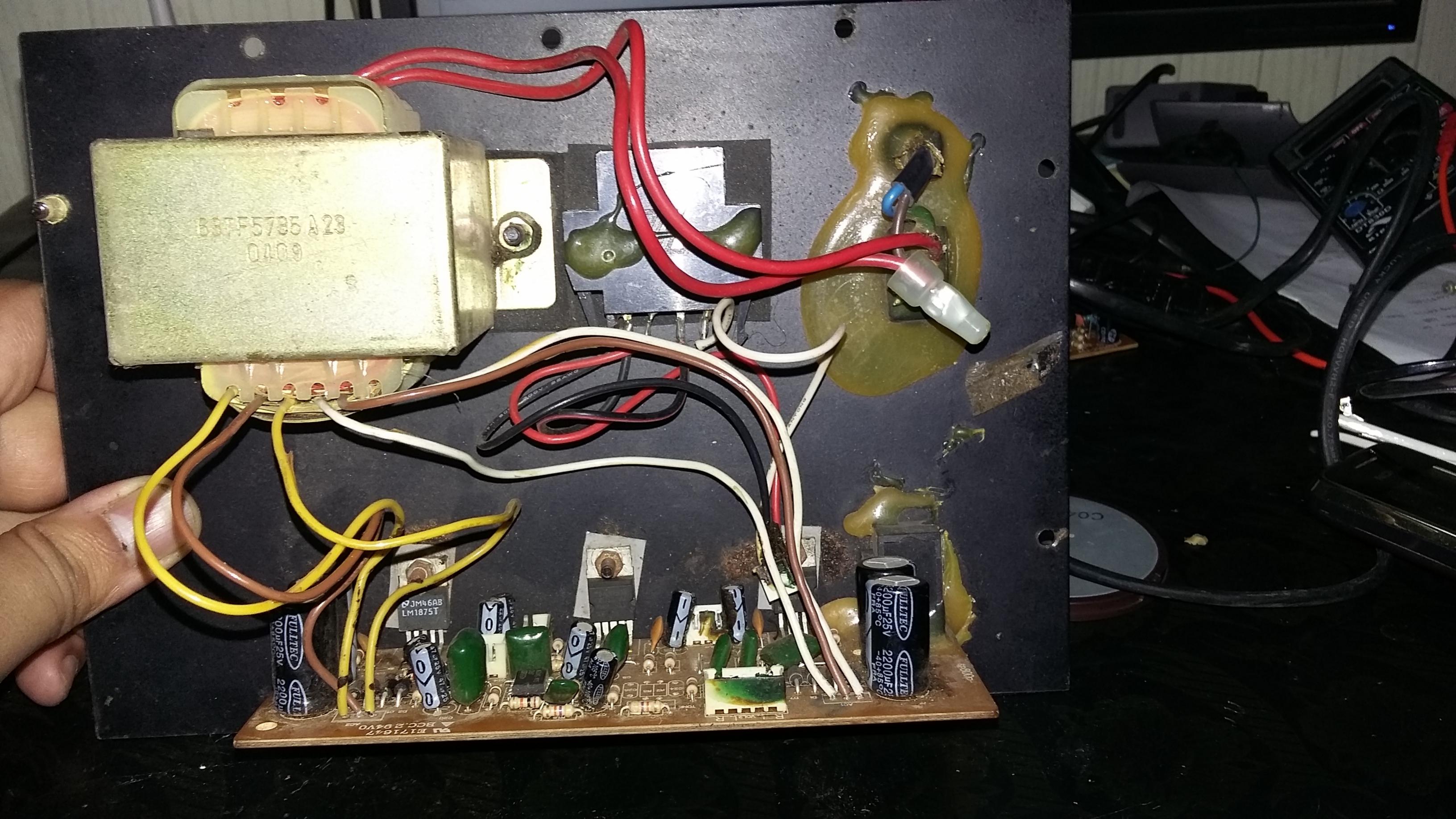

let me give you guys the pictures of what i am having.
The snaps are self explanatory

I am testing the diodes with a multimeter by the way after setting my multimeter on diode mode I probe Negative lead of the multimeter on the silver strip side of the diode and Positive lead on the other side of the same diode it shows values around 700 and when i reverse the probing leads it again shows readings on the multimeter which to my understanding means the diode is short as it is conducting both ways where it should be conducting the electricity one way only. Do tell me if I am doing it wrong or missing something.

This is normal for measuring a fullwave diode bridge in circuit. You get the normal diode drop voltage in one direction (forward bias) and "some reading" in the reverse. The reading may increase if the small current from the meter is charging the filter caps. This implies you are measuring across each diode and not the opposite ends of the bridge.

please post bottom side pics also. what is the voltages output of the transformer. I see there is two center tapped windings for sub and sats amplifiers.if u could post the bottom pics we can get the schematics of your 2.1 system.

I don't know. How can I know that?are those set of diodes 1n4007 types?
they are 4007 diodes. if you happened to desolder it, you can see the name on the body of the diode. doides never short. they work unless over heated and cracked. if your transformer is above 2 amps then change the rectifier diodes(1n4007) to 1n5402.

changing the power capacitors is ok. but changing all 3 ic's needs to increase your power supply also. yours is 2amp transformer with two sets of center tapped windings. one for tda2030 satellites and other for lm1875 sub.the both are 1 amp each. may be your sub box is not enough to put bigger transformer.
