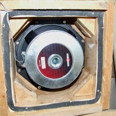

I have noticed some foam surrounds on speakers. A lot of them subs. I just ordered a pair of these GRS 12" woofers for a project.
Is the surround like a tweeter surround where it absorbs some unwanted high frequency tones? Or is it for mounting on the inside of the baffle? If it is the latter, I just might do that.

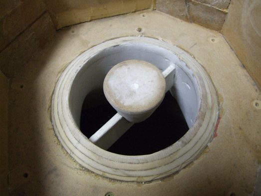

Oh yeah, and here's some picture of my future off coffee table. I'll build it sometime next week. Push push. They are locked by M5 threaded rod and it is all braced to hell. Probably going to do all these window braces by hand. Anyways, should hit to 18 hz flat as a pancake. No vibration for office visitors setting their coffee on the table. It will have a clear acrylic top so you can see inside. Found a giant sheet of 1/2" acrylic for free so why not?

It is a speaker mounting gasket, that serves that function yes, also for aesthetics when front mounted.Or is it for mounting on the inside of the baffle?
They come in foam, or cork or other plastics usually.
It can/will to some degree decouple the driver from the baffle also depending on material/thickness/compression etc.
You will see some have a trim ring instead for aesthetics, and front mounting.
Back mounting will have diffraction effects, but at the intended use/frequencies i guess it is not a concern.

Ok, I will mount them on the inside of the baffle then. That makes it a bit cleaner looking.
And those gaskets adhere to and hide the glue bead that squeezes out from the surround.Those are traditional mounting gaskets
And if they leak you will hear it. They form part of the acoustic suspension of the cone.Those are traditional mounting gaskets
Good point. Since this build has the removal acrylic panel I don't see it as an issue.1/2" acrylic for free. That's a good score. The only bummer about mounting from the inside is you have to have access through a removable panel.
