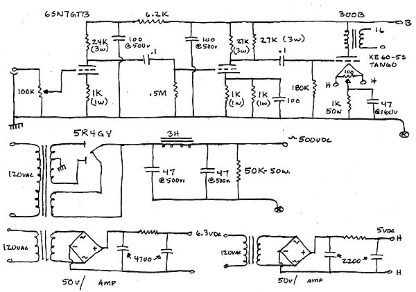

I don't know what a 7044 is but a 300B takes about 40 (actually I haven't seen a circuit this low) to maybe 80V peak drive. To run from a .25Vp signal source you'll need as much as 160 gain. This can only be done in one stage with a pentode. Typical circuits use a 12AX7 (I wouldn't, not much drive capacity), an 'AX and a low-gain, high output driver, or two 6SN7 stages.

That's an unusually high sensitivity. 1.5 to 2.5 volts rms is more common.

300B power triode (not European version of this) has very low input capacitance. If you'll made some (one) driver stage in SRPP - something like this
(see only the input/driver stage) with the valves lika 12AX7, 12AT7 or 12AU7 (sonding are these a lot of different options), you'll get a good sound, enough gain,....It isn't neccessary to find some exotic drivers. Some of good 12Ax7 like Sylvania (5751) or Mullard,... are enough exotic choice..

I would respectfully disagree but i can't, driving a 300B with a 12AX7 is outright hilarious! A lot of the undeserved bad rap the 300B gets is due to inadequate, anaemic drivers.

Mu followers built from 6BM8s as the 300B driver have some popularity. It's not difficult to see why. Plenty of gain combined with good drive capability is never bad. The triode in the 6BM8 is essentially 1/2 a 12AT7.
A Gary Pimm style CCS load, with its built in mu follower, allows you latitude in the choice of gain triode. The 6n1p, the 12AV7, and the 6J6 are possible candidates. IIRC, GP indicated that the pentode (6AU6)/FET variation of his CCS is particularly good sounding in front of a power triode "final".

We don't understand each other. I told about 12AX7 in SRPP configuration. 12AX7 and 12AX7 isn't the same (depend on amplifier configuration). SRPP is capable to drive very complicated load.... also with 12AX7 (far from anemich....)
