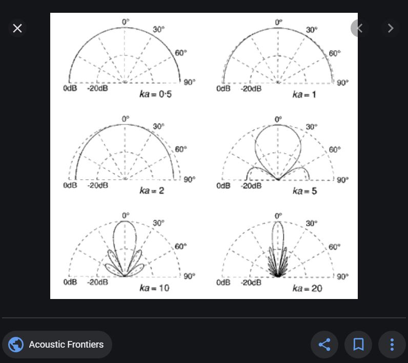

I think most will agree that 1/4 WL maximum spacing at xover is the well known holy grail. That is incredibly difficult to achieve.
I believe 1/2 WL spacing is probably the goal, to try to stay under.
Once above 1/2 WL, lobing becomes worse and worse.
And frankly imho, once above 1 WL, the speaker design is fundamentally flawed. (Using lobing to control room reflections makes no sense to me.)
I think your XDir animation bears the 1/2WL limit out nicely.
Starting at a 1/4 WL 45mm Driver distance, a pattern close to ka=2 can be seen.
Then there is a progressive pattern narrowing to approx 1/2 WL 95mm distance, approx ka=5.
And above that 1/2 WL spacing lobing begins building....and building...and building...
Imo, the trick to driver spacing vs xover frequency selection, is to match the radiation patterns at xover.
For the woofer, ka seems to be a time tested approach in assessing its pattern.
Where ka = driver circumference divided by wavelength.
![ka chart.JPG ka chart.JPG](https://www.diyaudio.com/community/data/attachments/820/820967-d0911da15893c48a0840b965eec7fb31.jpg)
Comparing ka of the woofer, to the pattern generated with XDir of the summed woofer and tweeter, finds the xover frequency where radiation patterns match. That's what we want i do believe...
Playing with this pattern matching shows anytime driver spacing is greater than 1/2 WL, it becomes close to impossible to find a xover frequency that matches radiation patterns.
As it's hard to imagine wanting to use a cone above ka=5 or so.
With regard to steep xovers, yep they help ...and the worse the spacing the more they help.

In other words, in a loudspeaker, we have a few variables:
1) the diameter of the woofer
2) the diameter of the tweeter
3) the crossover point
4) the center-to-center spacing
But if we opt for One Wavelength Spacing, then we can calculate the center to center spacing based on the diameter of the midbass.
![WHXcj91.jpg](https://i.imgur.com/WHXcj91.jpg)
A 17CM midbass has a diameter of about 17cm. The area of the cone is about 118cm^2. Do the math, and that means the cone has a diameter of 12.29cm (4.84")
![f7RroaQ.png](https://i.imgur.com/f7RroaQ.png)
The driver is beaming at 2800Hz. (Due to it's diameter.)
![K95cmlP.png](https://i.imgur.com/K95cmlP.png)
The spacing on the Revel speaker is wider than that, but a lot of that is because it's just physically impossible to get the drivers close enough. The crossover point is reduce from 2800Hz to 2200Hz because of this.
![N1ejT6E.png](https://i.imgur.com/N1ejT6E.png)
If you prefer a lower crossover point, you can afford to spend about 3X as much, and you want more output, you can step it up to the Satori 9.5" woofer. When you do the math on the cone, it works out to a diameter of 18cm.
This would dictate a center-to-center spacing of 18cm, and a crossover point of 1888Hz. The diameter of the Satori woofer is 24.2cm. So that would mean the waveguide would be about 11.8cm tall. (4.64")
![BpVisFu.jpg](https://i.imgur.com/BpVisFu.jpg)
![MfpPu0q.jpg](https://i.imgur.com/MfpPu0q.jpg)
In the measured response of the JBL 308P, with an 8" woofer, you see similar design decisions as the Revel speakers (also a Samsung company.)
Once again, the crossover point is 'pushed' down a bit. So the driver spacing isn't strictly single wavelength. It's about 80-90% of a wavelength.
But the main point here is:
1) Nearly all the Revel / Infinity / JBL speakers are using waveguides
2) The crossover point and slope is mostly dictated by the diameter of the woofer, which dictates the diameter of the waveguide, which dictates the crossover point.
As always, thanks to Audio Science Review for the measurements.

We want to cross over where the woofer is beaming, because the beaming of the woofer reduces how much sound is radiated into the floor and the ceiling.
For instance, the 17cm woofer in the Revel speaker is down about 4dB at 60 degrees off axis. We don't have measurements for 90 degrees off axis, but it's safe to assume it's down at least 6dB.
So that's a 75% reduction in output. That's significant, it's way more than you would get from treating the ceiling and the floor.
The downside to single wavelength spacing is that the vertical beamwidth at the crossover point is VERY narrow. I ran the calculations on the Revel, and it's got a window that's barely taller than the loudspeaker itself, if you're listening at a distance of one meter. If you're listening at two meters, the window is twice as high.
I kinda wish that loudspeaker manufacturers would put this factoid in their manuals. I've told the story a million times, of how I owned a speaker with a 15" midbass and a 15" waveguide, and didn't know about this null for YEARS. I literally just thought that the speakers sounded weird if you sat too close to them. And by too close I mean "less than two meters." This became a problem when I moved into a home that was very small...
While the vertical beam of Single Wavelength Spacing is about 20-40 degrees, if you go with Half Wavelength Spacing the vertical beam gets up to about 60-90 degrees. With half wavelength spacing, there's no off axis lobes at all, so that's definitely a plus.
Realistically, the bottom line here is "Do you have a tweeter than can handle a 1000Hz crossover point?
With a 6.5" woofer and 1/2WL spacing, you'll need a crossover of 1030Hz. That crossover point will dramatically limit the dynamic capability of the loudspeaker, unless you opt for a serious compression driver, one costing as much as $300-$500. Which would be a strange engineering decision, considering the midbass costs $60.
Another option would be to use a $50 compression driver made of titanium. Personally, I haven't heard any compression drivers under $100 that can do justice to 10khz-20khz.
So this leaves you in a pickle:
1) You can use 1WL spacing, and a $50 tweeter with a xover point around 2khz. This is what Kevin Voecks did.
2) You can use 1/2WL spacing, and a $50 compression driver, and basically write off having that 'sparkle' above 10khz
3) You can use 1/2WL spacing, and a $300-$500 compression driver that can do it all.
If you spend $800 on compression drivers, the dynamic capability of a 17cm woofer will become a problem, and then you'll start looking for 12" midbasses, and then you'll have to drop the crossover point from 1khz to 567Hz.
