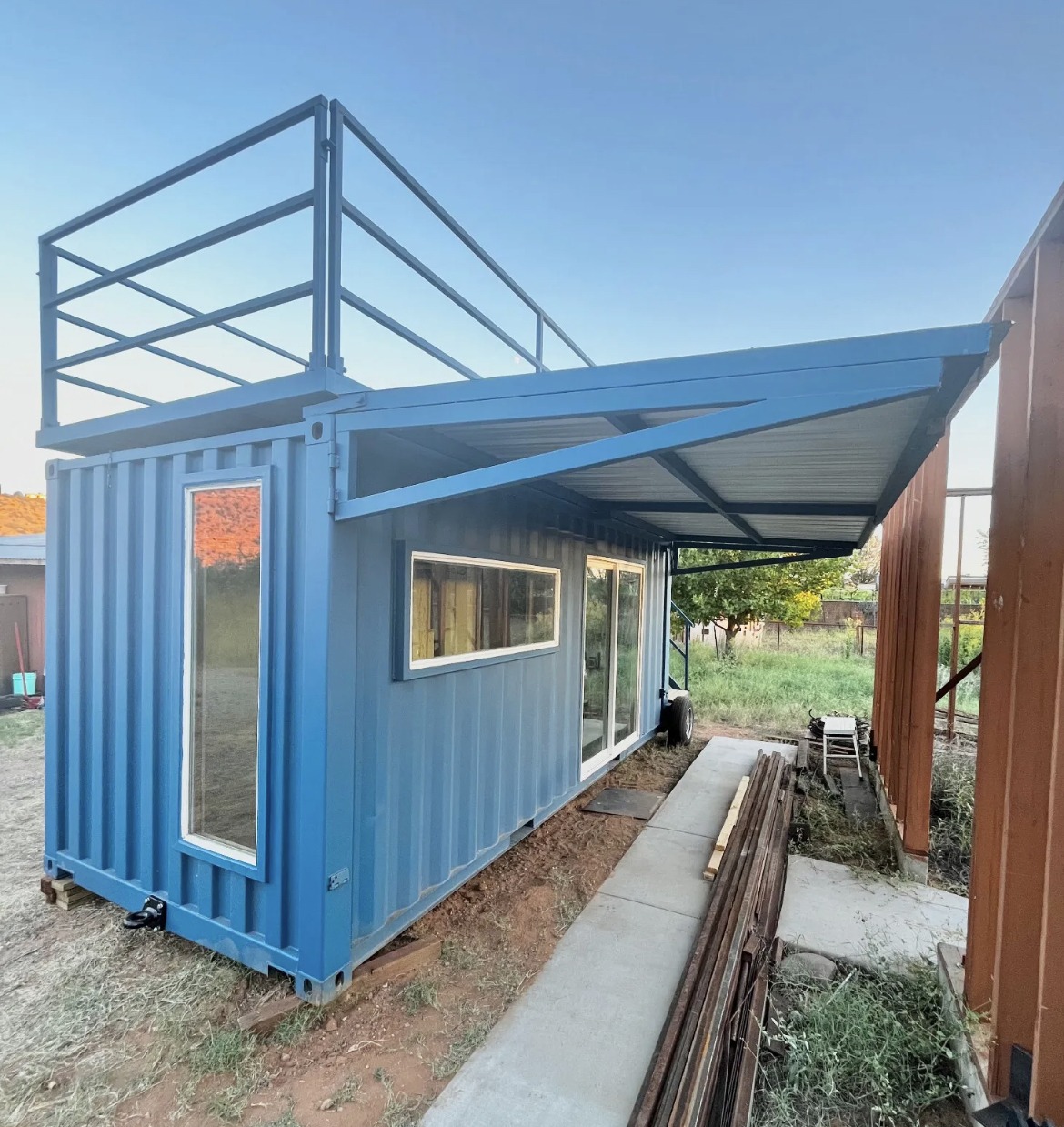

Cool micro home/cabin. Is there a portable AC somewhere we can't see. Average summer temps are around 94 degrees. But I'm sure you know that. 🙂 I can't imagine how hot that container may become. If you're living off-grid, does that preclude a portable generator? I guess you're not too far from civilization as I see building structures straight ahead, and behind the container. Still cool.

That container is just a picture from the net but is a good indicator of what we are building. From our camp site we can’t see any signs of life. We always go mid October so the heat is not bad. We don’t use a generator. We cook diner over open flame and take coolers to keep stuff cool.

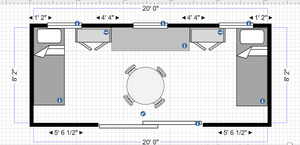

Here is the layout of our build. 20' container with a sliding glass door out to a 20'x20' wood deck. It will have a set of outside stairs and a railing all around the top for star gazing. Outhouse and bring-our-own-water whenever we go out there.
we think it's a good start and we can always add more containers.
