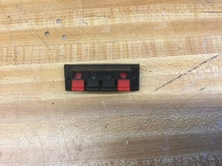

Lots of options out there, I don't really love any of them.
Bananas - low retention force (usually), no strain relief or insulation support, don't always come with gold plating (important for me), typically providing crappy set screws for wire connection, crimp barrels are non-standard or questionable, solder barrels very rare
Spades - don't always come with gold plating, no strain relief or insulation support, don't work with many kinds of binding posts, sometimes comes with crappy set screws, can slip off binding post if loose (big problem)
Ring crimp terminals on barrier blocks - no strain relief and typically little to no insulation support, no gold plating (but the high compressive forces from the barrier screws mitigates that), risk of short circuiting due to exposed conducting surfaces in close proximity to many wires (could be covered up with plastic sheet)
Speak-On - moderately expensive, no practical solder option while the set screws can (rarely) loosen, silver contact plating instead of gold (durability/contact resistance concern), good strain relief
Proper spring-cage connectors (e.g. Wago) - looks goofy, no strain relief, secure gas-tight spring connections but questionable fatigue life (the springs dig in REALLY hard into stranded wire)
4-pole XLRs with gold-plated contacts - reliable solder connections, low contact resistance over multiple cycles, good strain relief, moderately expensive, decent current capacity (6-10 A per pole), limited voltage capacity for high voltage/high power amps (<50 VDC)
Thoughts?

Speakons where possible but they are designed with the expectation that they will be mated and unmated occasionally. Barrier strips with crimp lugs are ideal for just about any loudspeakers used at home listening levels. Banana plugs into binding posts give the largest mating surface area but need to be secured with a tie wrap to guard against self ejecting over time. Precious metal plating is not particularly important at the levels of voltage and current used in loudspeakers.

I think you are overthinking it. Bananas are fine. They may need very occasional maintenance. Spades are likewise fine. You can find solder types and heat shrink over them if you like. Add a crush washer (Copper if you like) and it's very unlikely to loosen over time.

Have two wires coming out of your speaker, twist the bare ends with your speaker cable, stick each one in a terminal block and tighten up the screws. The terminal block will stop the wires touching and stop them untwisting, and stop any strain ( pulling ) on the wires going into the speakers. If you use four pole conectors you could always double them for a better contact.

I am probably going to go with barrier strips and PIDG ring crimp terminal connectors on my current build. The screws will squish the crap out of (through?) the tin oxide layer, especially with some trusty DeoxIT Gold, and I can add a bit of wireway to prevent any excess stress on the terminals. Cheapest route that isn't generic banana/spade.Speakons where possible but they are designed with the expectation that they will be mated and unmated occasionally. Barrier strips with crimp lugs are ideal for just about any loudspeakers used at home listening levels. Banana plugs into binding posts give the largest mating surface area but need to be secured with a tie wrap to guard against self ejecting over time. Precious metal plating is not particularly important at the levels of voltage and current used in loudspeakers.

Go for Speakon.
You will follow the standard in speaker connections and if You want You can solder the wires to the connectors and ditch the screws.

I need 8 channels - both sides of cable, plus amp side, plus speaker side. Adds up to a lot! At least in Canada it's about $150 just in connectors, not even including the cable itself.2-3€ for the NL-2FX isn't so expensive.
Go for Speakon.
I believe there are gold plated versions also.
So, for example, on amp side:
(8x) NL2MP
(8x) NL2FX
And on speaker side:
(8x) NL2FX
(8x) NL2MP
Also, I have read many reports that it is extremely difficult to solder to Speak-on contacts (at least without melting a bunch of plastic)... have you tried before?

Love Speakon connectors. I use the four wire ones and parallel them for two conductors. Keeps any resistance even lower and less likely to have any effect.
Just about any connector should be moved and reconnected at least once a year as there is nothing that won't loosen its grip, oxidize or attract dirt to some extent.
