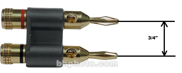

I am making a drawing to submit to DIY Audio Store to convert to CAD and having a slight hiccup with my speaker binding posts.
The description for the binding posts says "holes drilled 0.75" on center"
Does this mean that the distance from the center of both holes should be 0.75" apart? Or 0.75" in either direction from a midpoint spot?

The standard mounting distance for a pair of binding posts is 3/4" which means
the center to center distance (where the holes are drilled). This placement fits the
standard dual banana plug that also has 3/4" center to center plugs.

Dual bananas are made so that you have to drill holes with a 0.75" distance (about 19 mm). It is easy to check if you hold it in your hands.
It is standard so there are many plugs with such a distance. Even Europe mains plugs (Shuko, CEE7 etc) are made with the same distance.

It's pretty simple, when you mark a hole to be drilled you typically make scribe marks horizontally and vertically and use a center punch to provide a registration for the drill bit. The center punch marks the center of the hole and for these sockets the specified spacing is 0.75" on the center punch marks or on center for shorthand.
