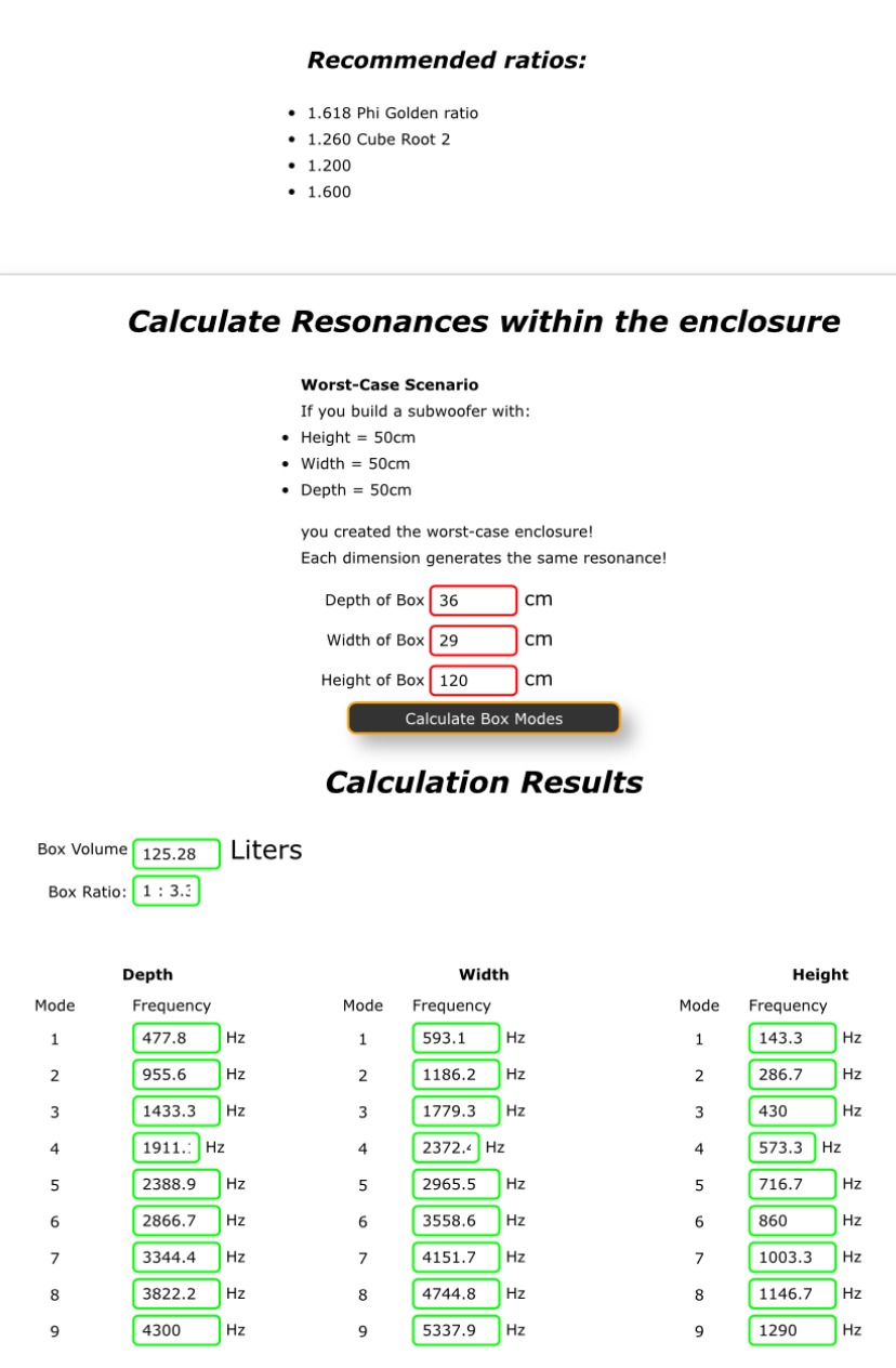

I found an online calculator of box resonances. It’s easy to use, simply fill the speaker cabinet dimension and it will return results.
Picture is the result of my speaker’s dimension inputted.
Unfortunately, I don’t understand what they mean. Could anyone please explain the results for me?
Also, according to the results, which frequencies could cause the mid-bass boom phenomenon?

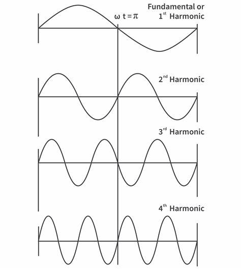

It's calculating the fundamental standing wave frequencies for each internal dimension (mode 1) and the harmonic series based on multiples of each one (mode 2, 3, 4, etc.)
So for depth, the dimension supports reinforcement at 477.8 Hz, 2 x 477.8 = 955.6, 3 x 477.8 = 1433.4, etc.
It can be helpful to view them on a dot plot on a single line to see how much they are bunched up.
So, I should focus on mode 1, right?
And if I’m going to account them into the crossover design, in order to compensate for these resonances, such as using underlap crossover point technique, I could use the mode 1 as the center frequency of the gap created by underlapping crossover points?
But it still be confusing because which side of mode 1 should be picked; depth (477.8Hz), width (593.1Hz), or height (143.3Hz)?
Mode 1 is the lowest frequency for each axial mode, so if you can avoid exciting those at all by crossing over lower than them, you are in decent shape.
There are other modes (tangential and oblique), but they tend to be lower in intensity so aren't focused on as much.

Neither do I, what I see from your post isn't complete.Unfortunately, I don’t understand what they mean.
Firstly, you need to consider where in the box the source is placed, this makes a difference to the modes in both distribution and level.
Secondly, it doesn't tell you what's happening. For example: Consider one wall 1.7m from a source where all the energy goes, reflects then recombines. You'd have cancellations at 50Hz, 150Hz and 250Hz. You'd have an increase below 25Hz, at 100Hz and at 200Hz.
Furthermore, this is usually managed (reduced) by damping material. Probably a good thing considering the delays added by reflected energy.

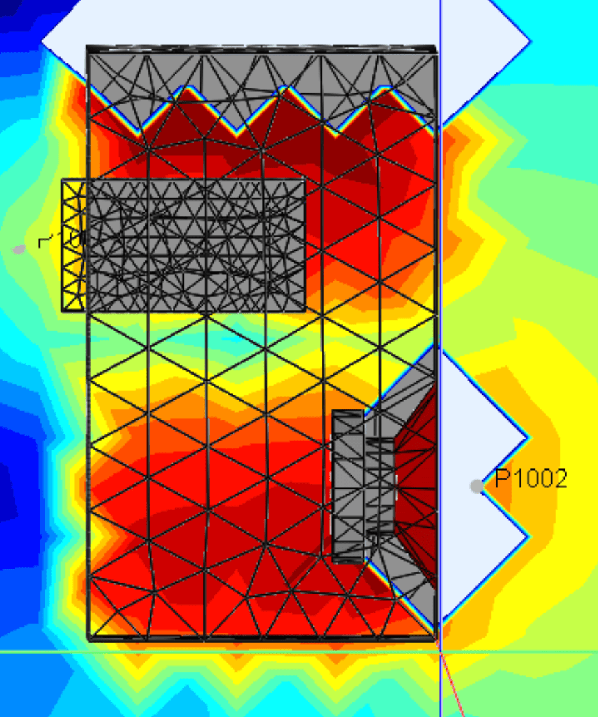

It's calculating internal eigenmodes / standing waves raher than panel resonances. Still, the basic principles are similar -if you're running a sealed or vented box based purely on Helmholtz assumptions (uniform internal air particle density & no standing waves), then ignoring everything else, an efficient design is one that hits the target alignment with the minimum of acoustic damping. So avoiding equidistance between panels, & preferably using one of the various acoustic ratios to distribute those modes on the three dimensions is usually a good plan, when it's possible / practical.
You should not do anything with that information, ignore it.

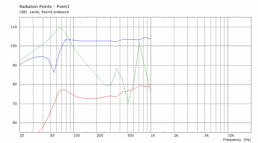

First, if the speaker is closed, it will not matter all that much. Second, if the speaker is ported the resonance leakage to the outside world is very complex. It is affected by the woofer placement as well as port placement. Additionally other objects such as the woofer magnet or bracing beams and damping materials will change the result. You need a deep understanding to optimise this result and IMO making multiple prototypes or adjustable porotypes before a final build is the best way because even advanced simulation easily give false information that lead you in the wrong direction.
Example: Red - Far Field on axis. Blue - Woofer Near Field. Green - Port Near Field.
Visual of height mode at about 350Hz
