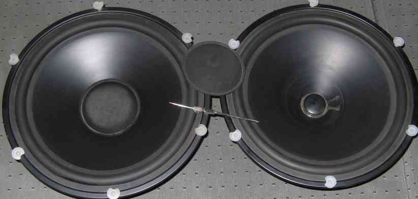

The following picture was posted on one of the the OB threads
here: http://www.diyaudio.com/forums/showthread.php?threadid=110583&perpage=25&pagenumber=3

OK real bonehead question here - since it's called a "dust" cap, does removing it expose the motor to contamination?
I have replaced the dustcap with a light foam plug placed at the edge of the voicecoil, and it works wonders ... its on an 8" woofer
sdclc126 said:OK real bonehead question here - since it's called a "dust" cap, does removing it expose the motor to contamination?
Yes.

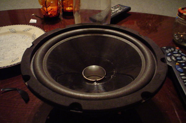

Just in case, watch out for vent holes in the cone below dustcap.

I took the cap off permanently. These are strong, durable drivers. I was ripping and flexing it everywhere and it seems to have not done anything to it. I will have to hook it up and listen to make sure though. The voice coil gap is quite big (relatively I guess) and it looks like a coax could be made out of it very easily like has been suggested for the Pioneer B20. I don't like the fact that it says it can run up to 3 kHz, meaning the crossover between the woofer and tweeter would be in that no-no area. Here is some pictures.
This is the vent through the pole piece. One could easily shove a small tweeter down there and route the wires through the vent.
There is a bit of material on the former that something like a whizzer could be attached to as well. Has anybody tried attaching a whizzer to a woofer? The coax idea sounds really good with this driver too. The voice coil looks to be 1 1/4 inches. I am thinking something like this might work:
