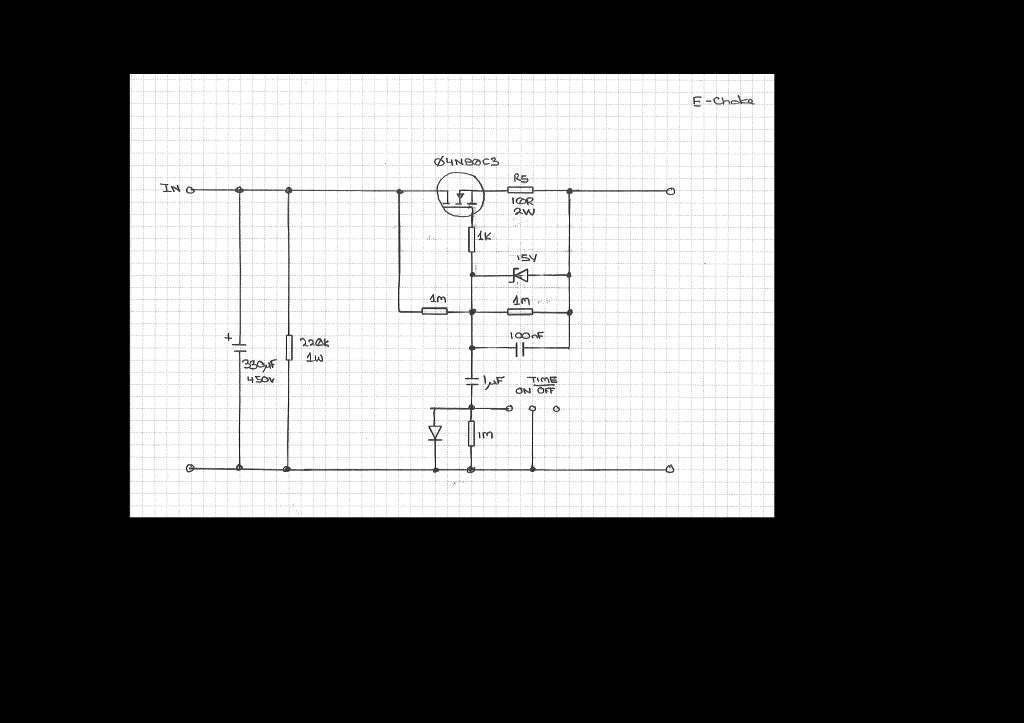

By my guess, E-choke is probably just a gyrator, i.e. a simulated inductor using opamps and capacitor.
http://www.diyaudio.com/forums/atta...ower-supply-mosfet-vs-choke-filter-echoke.jpg
That;s from searching further and finding post 8 by gingertube in http://www.diyaudio.com/forums/tubes-valves/261117-power-supply-mosfet-vs-choke-filter.html
so now I've got to learn how the heck that circuit works in order to really figure out how to use it optimally.
Thanks to some great animations, I understand the stengths and weaknesses of a capacitance multiplier. Now I've got to get similar background on these FET Gyrators and their strengths and weaknesses. Then...can they be used together...and if so exactly how & when...or when is a FET filter better, and how to incorporate a real regulator?

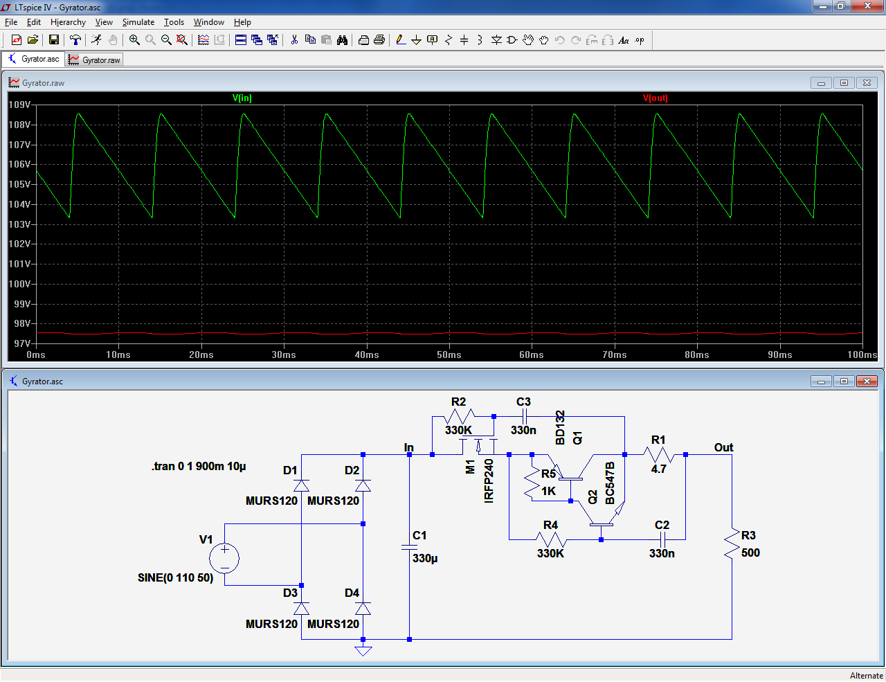

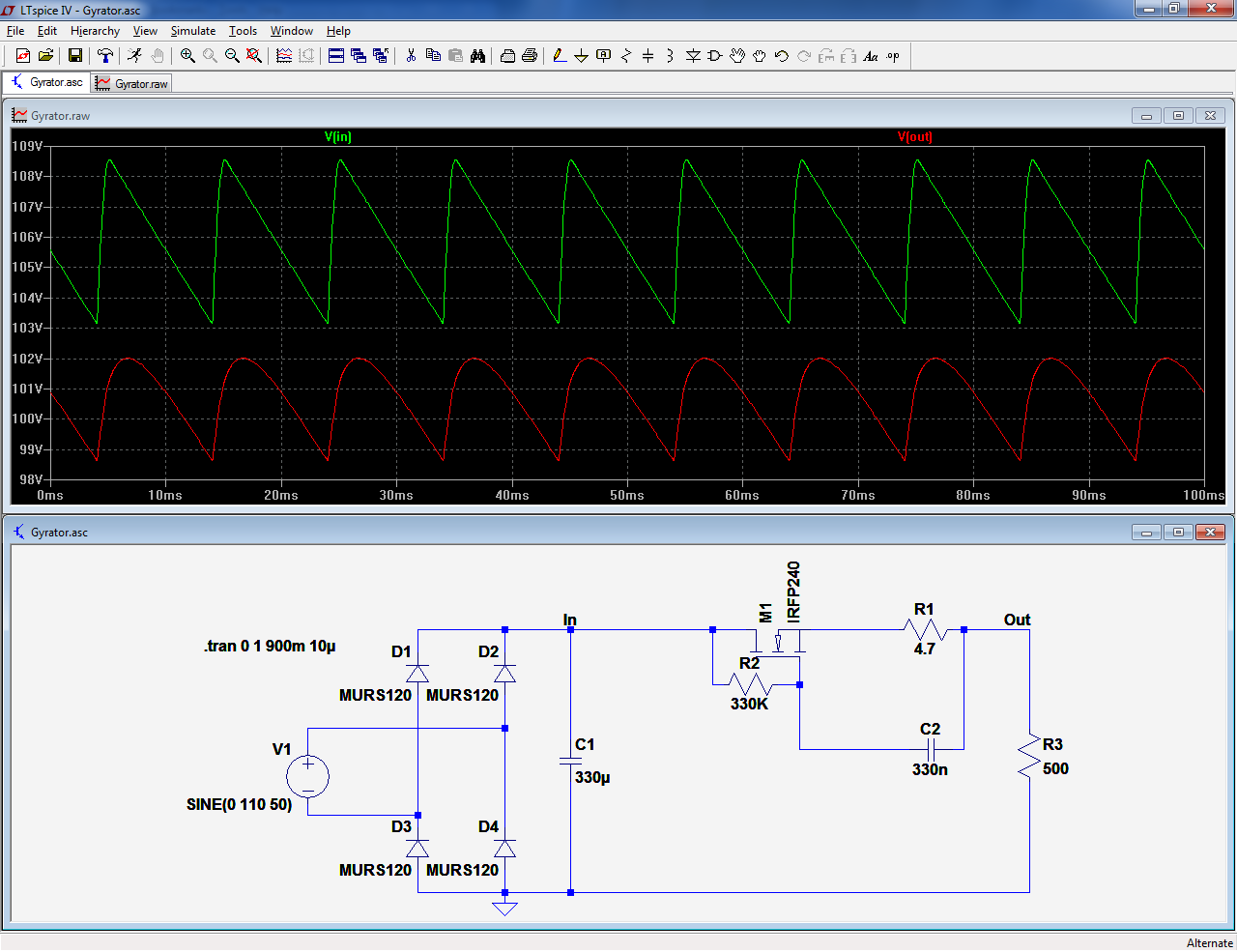

I'm lost. So how does that circuit work? Anyone got some magical links that will help me understand?
These are cap multipliers, not actually gyrators.
Here is an example of true gyrator: if you analyze the circuit, it is obvious that it tends to behave like a choke: for short term variations, it behaves like a constant current source, but on the long term, it is a short circuit (except for the drop-out voltage).
Of course, such a simple circuit does not perform very well: the MOS has a low transconductance, and a finite output resistance.
It can be augmented, by using BJT's as actual operational devices (they have a higher gm) and cascoding the MOS.
Note that this circuit is a two-terminal device, just like the real thing
Looks all the way like a capacitance multiplier.
Will replace a choke, with advantage, as a ripple killer.
Say, between 2 capacitors.
Will not replace a choke in the input of a supply, between diodes and first cap, because it can not store energy to be released later, like an inductor does.
In fact, even the "capacitance multiplier" name is misleading, because it does not store gobs of energy like a really big cap would, all it does is lower ripple.
