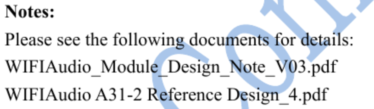

The A31 datasheet provides examples for the WM8919/8960 but I'm not sure why they refer to it as 'master mode'. I assumed the codecs would be master in the example? The datasheets for the WM's indicate they can outputs the required clocks.
Wiimu Information Technology A31 Wireless Audio Module User Manual 15 A31 UserMan
Also noticed a few of the Ti DACs might be able to output the required clocks eg PCM5122 / 5121, pcm5252...
I think at least with the pcm512x you don't need onboard MCU to control them. Unfortunately no cheap generic boards available.
