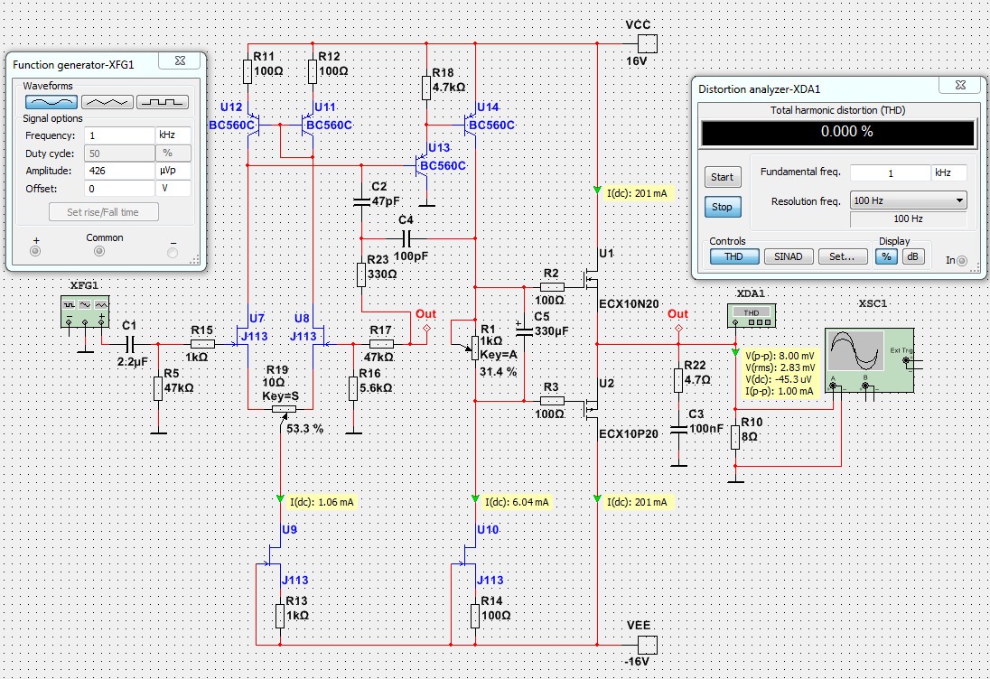

Laterals have a specific Id for zero tempco below which the tempco will be positive and above it the tempco becomes negative. I have no experience with exicons, the K1058 was around 125mA, slightly lower for the J162.I settled for 50 mA bias. It was a tiny bit better than 100 mA.
And the 100 Ohm resistors are in place!![]()
Gate resistor is needed to suppress oscillation, 100r gate resistor is kind of small for them, may not be enough in case of clipping, difficult load or RFI. 330r - 680r would be safer. I've even seen others recommend ferrite beads.
I went back to 200 mA. I had this before I tested 50 mA.
200 mA gives better bandwidth and so I can reduce compensation and so lower dist is a result.
I still have to test 125mA or 150mA.
Maybe increase gate resistors to 220 Ohm.
VAS current is increased to 6mA. It was 2 mA before.
Better bandwidth with the current.
Here is the schematic. I have not built and will not do this.
I am just playing with SPICE and the built in Oscilloscope. Because I think this is fun

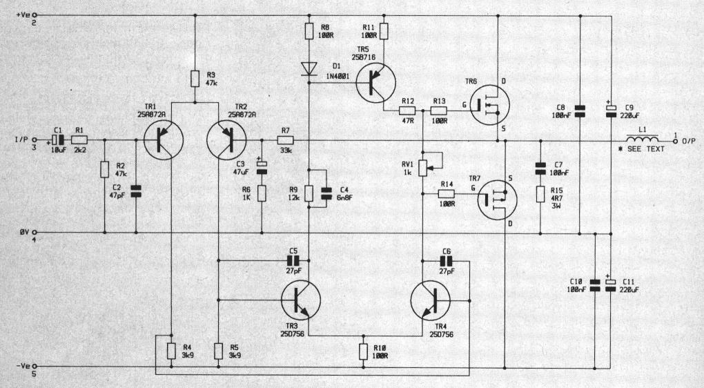

I'd be curious to know how many times you've mentioned Maplin amps since you've been on the forum 😜The old 1980's Maplin lateral mosfet amp 100ma was recommended.
I think the Maplin standard was minimalism (i.e. cheapest possible) whilst maintaining reliability- an excellent base formula for simple, knockabout, DIY disco sound quality as it happens and of course, very popular when everything else available to the DIY'er in the UK was comparatively complex, expensive, difficult to source and you needed to visit several stockists for specific parts. Here's a breakdown of a typical, though neither 150W nor home built stereo amp:

The simple Hitachi/Maplin design is immensely gratifying and a nice way to start audio DIY from scratch.I think the Maplin standard was minimalism (i.e. cheapest possible) whilst maintaining reliability

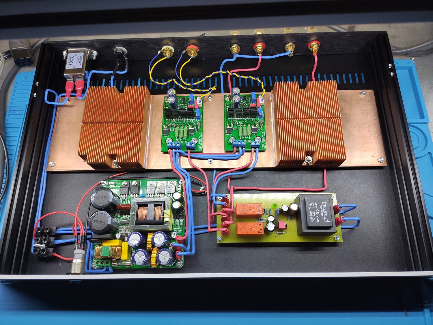

Could not believe how nice it sounds. PCB etched old school, designed by Prasi. 100mA bias.

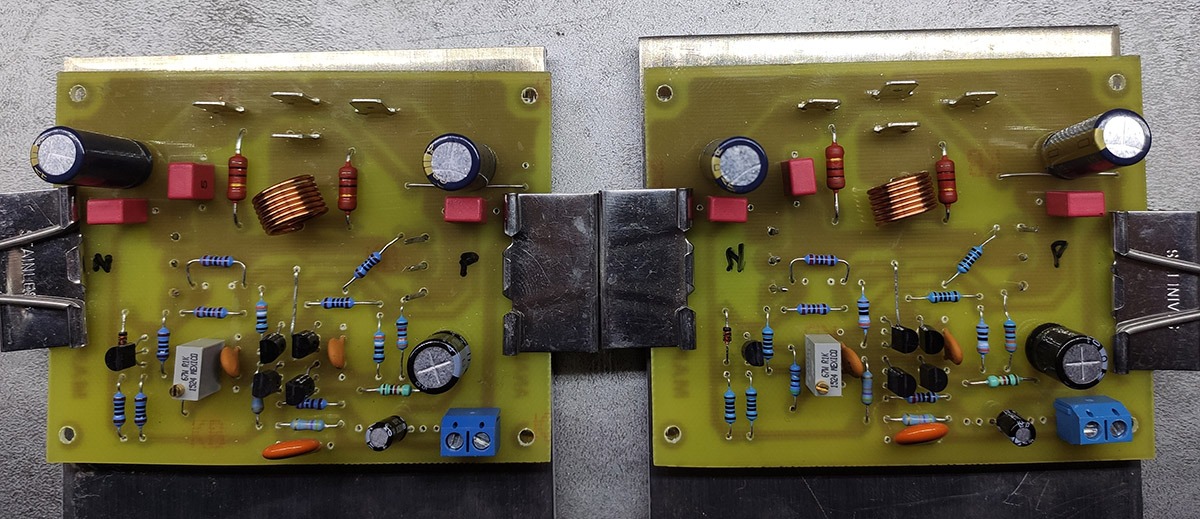

Lateral mosfest were made popular, especially down under, by David Tilbrook in the mid 80s. His AEM6000 is one of the best amps I ever built. Circuit update and PCB design by SuzyJ. I use it every day, 50mA bias. Unfortunately I am unable to find the three original 1986 AEM articles.
