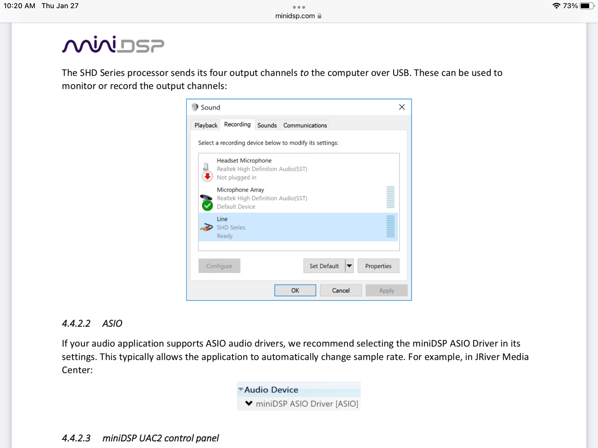

From the specifications -
- Bidirectional audio / 2ch playback (PC to SHD), 4ch recording post processing (SHD to PC)
Jan if it’s the same as my SHD it outputs 4 channels with all processing features intact over USB

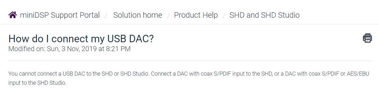

They say that isn't possible... https://support.minidsp.com/support/solutions/articles/47000681687-how-do-i-connect-my-usb-dac-Carl have you tried to use the USB out to external DAC configuration yet?
The USB Host port is for playing files off of a USB stick or WiFi adapter.
Well, someone just made me aware of this posting in a miniDSP support forum. That kills it I guess.

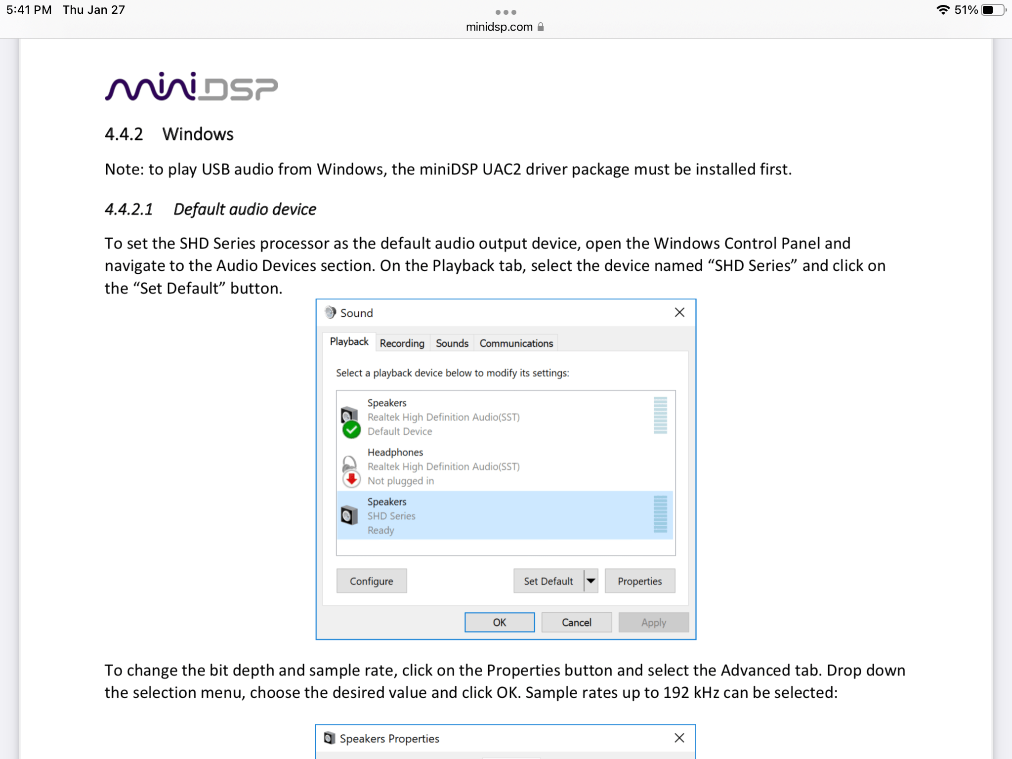

It is a USB peripheral. Can only connect to a host making it bidirectional between it and a PC or, presumably, any other host. Note that it has the same connector for USB audio as a dac. Can't go from peripheral to peripheral.
Yeah, I saw that in the manual too. The SHD has 2 different USB ports on the back, not sure we're all talking about the same one?

OK I just did a quick try with my SHD.
I have a laptop connected to the USB port for the control app and streaming from the PC. I just tried to play from the SHD via USB into the laptop and it did not work.
Strangely I did find it as an available input in Windows (see post 12 above), but no joy.
