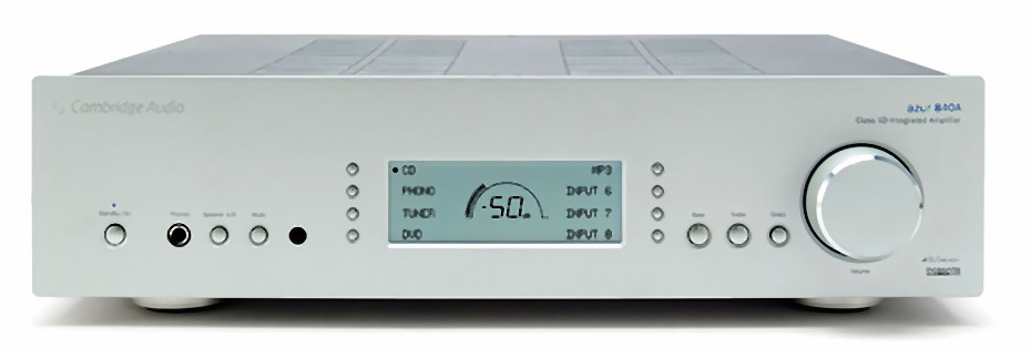

I could read, into their site, that operates class A and class B...and now they are saying AB is not good anymore!
It seems to me another automatic bias adjustment... some new dinamic bias adjustment.. from class A, going to AB and supressing bias into peaks of power.
Can someone explain how this works?
Thank you in advance by your kindness.
http://www.cambridgeaudio.com/summary.php?PID=292&Title=Azur+840A+(Version+2)+Class+XD+amplifier

I really wish they would have come up with a better term than Class XD. It makes one think they are talking about some form of Class D, as in switching amplifiers. I think they used XD to mean crossover distortion. But they could have done something else. Lame choise on creating a new marketing class (like Class T and Class I).
I believe Douglas Self talks about this in his book (some of the graphs in the white paper looks like they were taken right out of the book).

I have readed the white papper with full understanding
A crossover point displacement system is the idea as i could understand.... XD as Extra Displacement, or axel X displacement is fine....not "class" in my point of view... this amplifier has not a class...not B, not AB and not A, as i could see.... will depend of the volume... a Variable Class Amplifier.
I remember Graham Maynard have made that with the GEM some years ago...and this was published...not too much different.
And the GEM i have built and sounded great.
The diferences obtained, into the distortion is something i cannot listen to something more difficult to listen.... i cannot listen both levels of distortion...smaller than Class AB distortion into good amplifiers that i cannot listen too.

The notion of applying single-ended bias to the output of a power
amp has been around for quite a while. Take a look at the Aleph 0
from 1991.
Modulating that bias has also been done, but I found it much more
useful to modulate it against output current than voltage, as
it makes the effect independent of the reactance of the load. If you
modulate the SE bias by output voltage, it is optimum only for
resistive loads.
And while I'm at it, I think the technique of a SE current source on
the output is best used with a Class AB bias on the push-pull
portion of the output stage. If it is Class B, there is a significant
crossover distortion that is there unnecessarily.

My understanding is that it still operates in class A for lower levels and then goes into class B for higher levels. It just has the ability to stay in class A for a bit longer than a class AB with a hotted up bias.
I had a Yamaha A700 in the late 70's that was class A to 5W and then went into class AB after that. I have very fond memories of that amp and there's no denying that class A sound is very appealing. Better than any Yamaha I've heard since.
I have some fine DIY amps, AKSA55N & N+ plus a LF55, but due to a deteriorating medical condition I needed something with more convenience, flexibility and widgets for the future so I looked for something with a high bang for buck and was within my budget, hence the Cambridge Audio 840A V2. I have a 840C CD player so a good match.... I hope.
I think the class is irrelavent as it's the final sound that matters plus there are great examples from them all. It will be interesting to see if it's as good as my DIY amps. If it comes close I'll be very happy and if not, I'm prepared to lose some SQ but will have the ability to be able to use it.
So far the sound is very promising as it's been set up in my office to burn in. Listening to some nearfield speakers, a very smooooooth detailed operator so far..... 30 hours more and into the main system.

The old chestnut. Class B and class AB - what are they.
I prefer class B = no bias, class aB = optimum bias, class AB overbiased.
D.Self refers to aB as B. For the XD technique his class AB is not useful.

Hi Sreten,
---class B = no bias, class aB = optimum bias, class AB overbiased.---
Self has written an article called, I think, "Class distinctions" published in Electronics World. The aim of his classification is to avoid confusion.
I retained from that :
As no bias could also be class C, Self prefers to call class B an amplifier having at any time, at least, one of the branches of the output push-pull conducting.
He then introduces sub-classes, A+B, A+C etc.... to more precisely describe the biasing.
