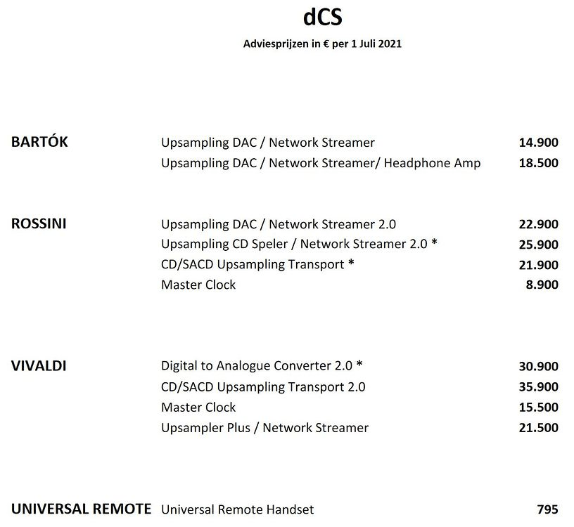

Or the Vivaldi with all options:
Along the above continuum of dacs, at what exact dollar value and or performance level would you say a dac goes from being affordable and good enough, to a symbol of snobbery?
