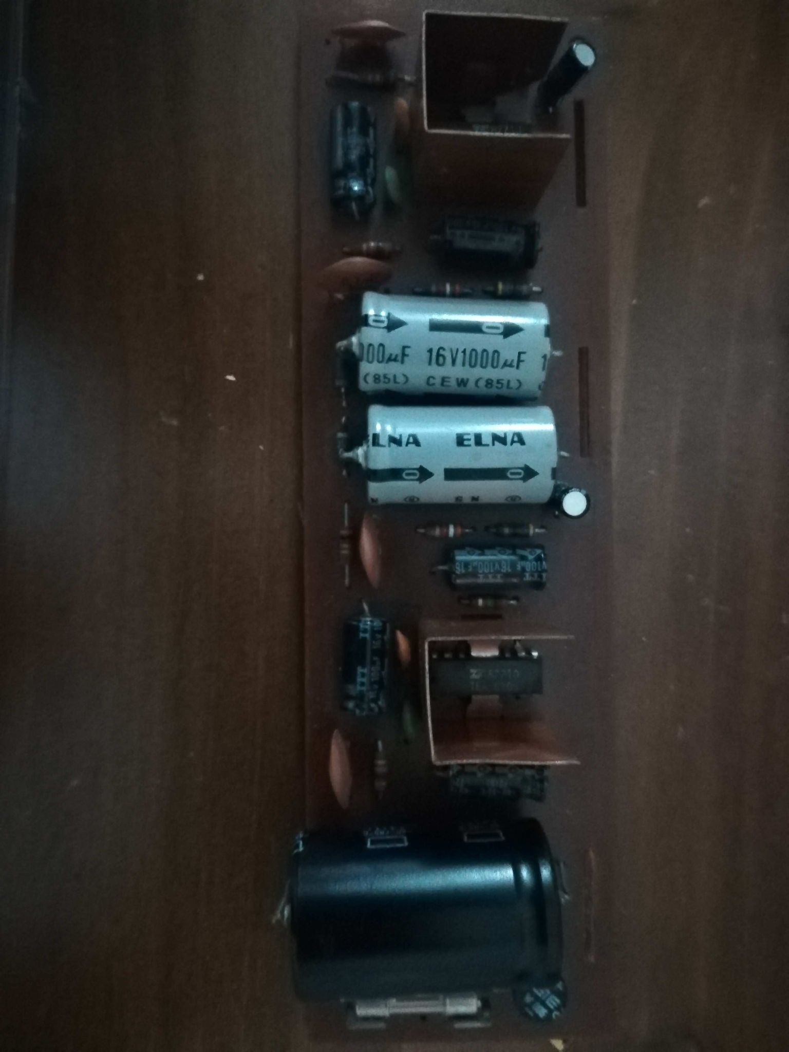

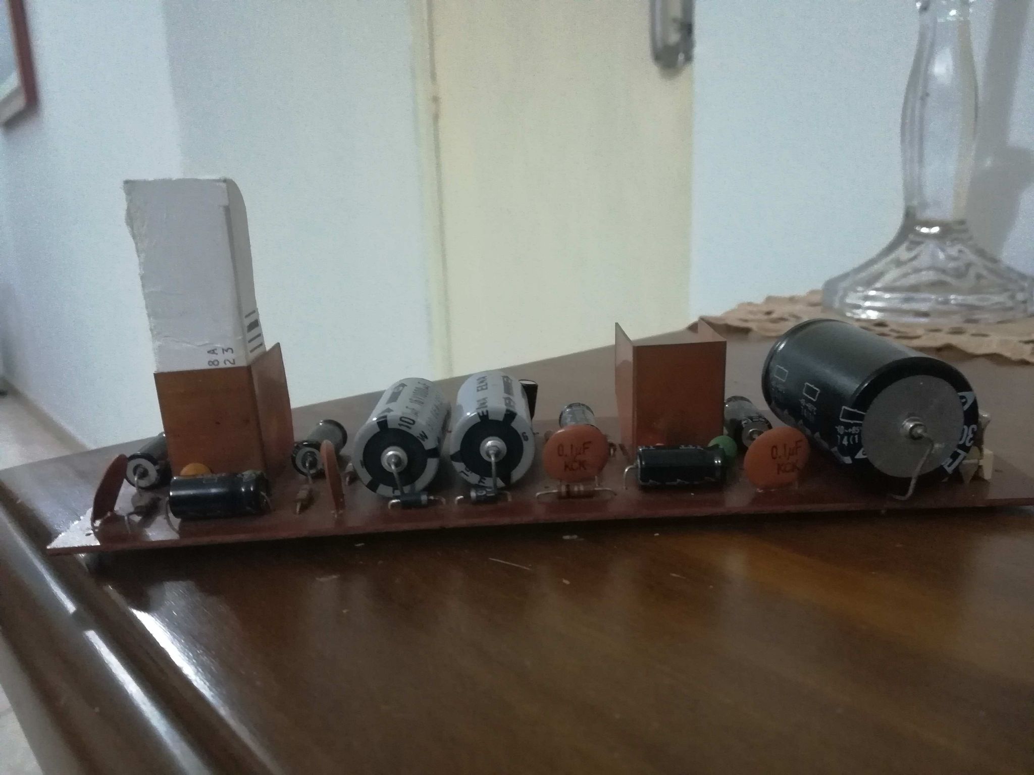

This is the small ampli circuit board with the two TBA810 transistors that I want to up-grade by replacing them with the equivalent bigger TCA940N.
So one of the pictures shows you the original amp board.
The other picture shows you the idea of what I want to do, when I'll mount the new TCA940, in order to get a bigger heat dissipation surfarce by adding three copper laths to the original small heat-sinks in the ampli board.
The piece of paper you see in the second picture, in practice, will be one of the three copper laths I want to attach to each of the three sides of the original heat-sinks, by using a small screw with a bolt.
Of course I'll insert thermal paste between the new copper laths and the original heat-sink surface.
This is my project. I know my english is very bad, but I hope you understand what I want to do!
Does this up-grade work in your opinion? It doesn't seem a very complicated project to realize, at least I think so🙄.Please let me know!

A lot has to do with the nature if the heat to be dealt with. If the heat comes from high power with a low duty cycle, a material like copper with high specific heat will work nicely as a heat reservoir until heat can be transferred to the air. Continuous power just needs high conductivity and surface area. Almost all heat sinks are aluminum, while transistor packages I believe use kovar.
> TCA940, 10 watt max
That is an IC for speech/music. While it can dissipate >5W on test-tone, it will not average even 2W in the loudest parts of speech/music. It will usually be fine with finger-tip PCB copper pads. (I have used a lot of LM380 and LM377 this way.) I have also cut 2cm squares of copper roof flashing and soldered to the tabs. (Copper because it solders well, and this much copper costs pennies.)
Your TCA940 even has thermal protection. If it is not cutting-out, it is not "too hot".

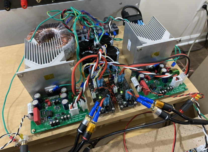

Copper is a pain to drill and tap. I have broken more taps in copper than I care to admit. Aluminum OTOH, easy peasy. For most applications, Al is the way to go. Before you DIY it, consider surplus CPU coolers. I use these for Class AB without a fan. For Class A, add a Noctua fan and it can handle 90w easily.
Dell Precision T3500 T5500 T7500 Workstation LGA 1336 Processor Heatsink T021F for sale online
Here I use them with a 50w Class AB "Xmas Amp" TDA7293 chipamp giveaway and it works beautifully.
