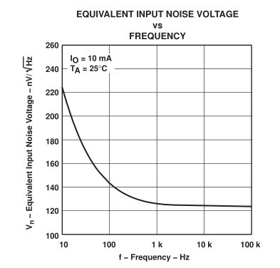

The need for a regulator to have the very low self noise is something that is, as you point out, application dependant. If the signal amplitudes of the circuit the regulator is powering are small, such as for an phono stage input circuit, or simply highly noise sensitive, like DAC clocks, then low regulator self noise can be critical. In a 2VRMS line level circuit, however, I tend to feel that typical regulator self noise is not much of an issue. So, I tend to agree with your view.

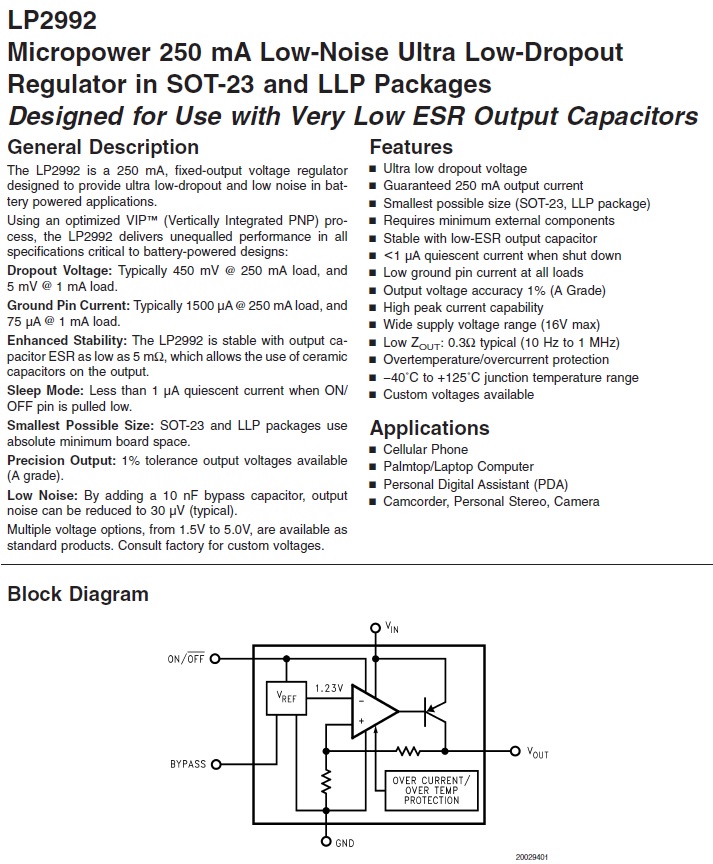

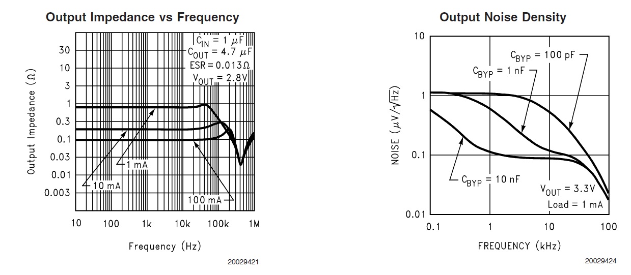

Regulator Zout is often more of an issue in practice than its self-noise, particularly when powering opamps.
Where in the datasheets do you find this? Is this also a reason to not put a resistor in line with the power before it feeds the opamps, like for a filter?
Designed for Use with Very Low ESR Output Capacitors
www.farnell.com/datasheets/10218.pdf
Why would it be in the datasheets? Its an application issue for the designer to be aware of.
There's more to it - if you put a resistor in line then you're increasing the opamp's self-generated noise by virtue of increasing the supply impedance. But you're also giving some isolation from that noise to the regulator. For myself I use an inductor so as not to significantly increase the supply impedance seen by the opamp.Is this also a reason to not put a resistor in line with the power before it feeds the opamps, like for a filter?
@ALD - 0.3ohm Zout up to 1MHz looks pretty good - probably better in practice than a TL431 shunt. I'd want to check though what output current that figure was found at - probably at the top end of its range. Ah I see that's shown in the lower plot - I'd be a bit worried about the regulator's noise - 1000nV/rtHz is considerably worse than a TL431 and that's well known as a noisy beast.
