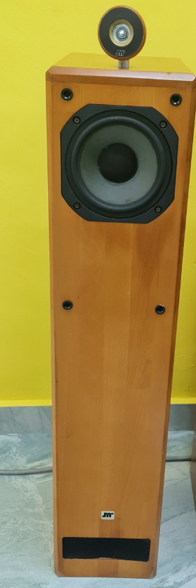

For me boxy is when the sound can be clearly located where the speaker are This is quite evident for instance with cheap speakers with cabinets made out very thin wood Actually i guess in that case the cabinet becomes an acoustic chamber
like placing a full range in the hole of an acoustic guitar

Usually this is achieved with some smart structural interventions on the cabinet like bracing damping adding mass etc.
Thanks a lot This is actually what i plan to do I love speaker with detachable panelsYou can experiement with this stuff quite easily: make simple box shell, with at least one detachable panel. Now play it empty, record the sound in various repeatable ways. Now, start adding bracing, damping material, what ever you have in mind, and compare the results. If you recorded some audio, you likely hear a difference between various stages of the build. Which one sounds better?🙂
My ideal speaker is made with a very rigid frame on which thick front baffle and base are bolted tightly
all other panels are think sealed and attached to the metal frame with magnets
I am not at all worried about lateral top and back panels flexing Not at all The resulting emissions will be negligible compared to the direct frontal one

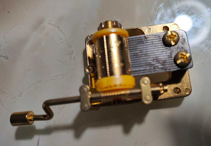

In the meantime i would like to show my boxiness tester The idea of course is absolutely not mine I was showed a similar device from one representative of the Fischer & Fischer loudspeaker brand at an old audio show
when I turn the crank while holding it in the air I can hardly hear the tune
If I place it against any speaker that I can find in my hand the increase in volume is shocking The amplification effect is surprising

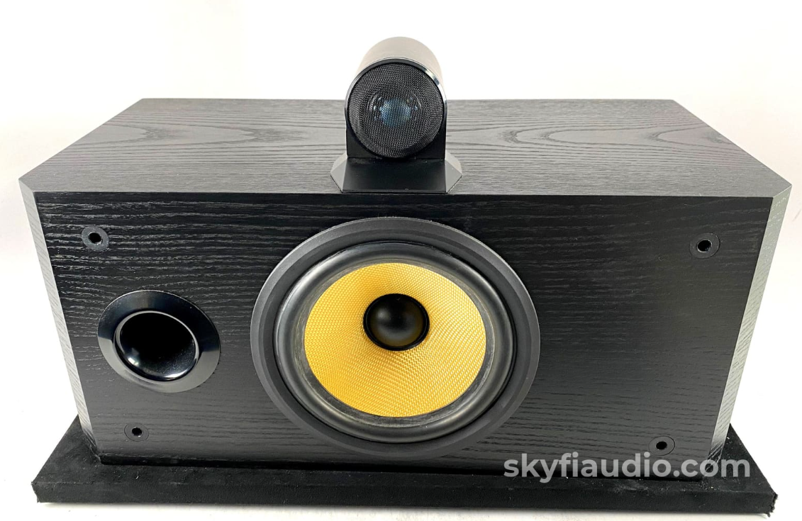

Needless to say that leaning it against a speaker of the brand mentioned above the difference with the situation in free air was very very small
But if I ever had to place those speakers in my house they would end up in the cellar due to their enormous weight
The dream would be that performance at more human weights
I will study the answers and get back with other answers hopefully smarter
Thank you very much again
