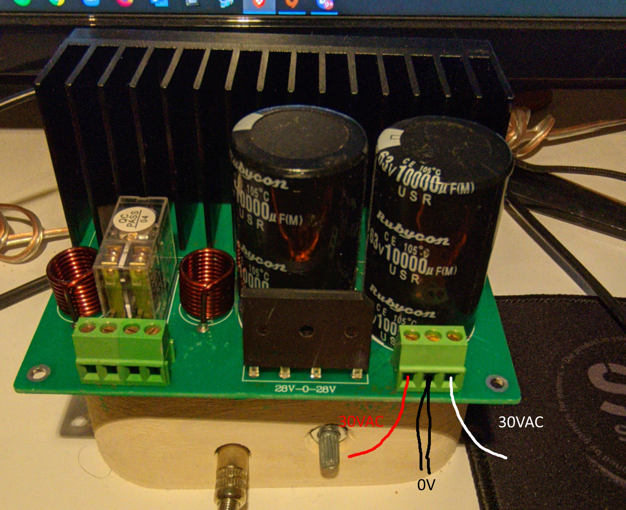

Hi again! So I got the amplifier and the transformer I linked to in post 8. Now Im looking to get everything started. But I'd like to know if I've gotten the facts correct. So am I right in thinking that the way i connect the transformer to the amplifier are like in the first image below?
The black thing between the speaker terminal and the powerterminal is that the rectifier bridge? And it turns the AC into DC?
Thanks for a fast reply! Am I thinking correct in the way im going to hook up the transformer?That is correct. It’s the rectifier bridge. It will get at least warm if not hot so be aware.
