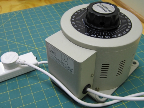

Everyone,
I have attached a picture of my autotransformer with cables added. The plug, cable and power board are rated at 240V 10 amps, but after all the amps I have made the 240V 10A wire seems awfully thin. I don't intend to power 4 amps at once but I probably could. 😉

Sounds fine, try to build it in if you can to save lugging it around when you want to use it. Also provide a spot for a fuse on the output side & meters if you want.
