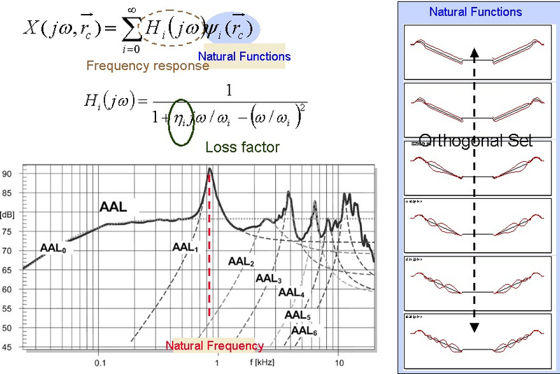

The corrugated surround provides this liveliness by reflecting energy back into the cone instead of absorbing it in the way that a foam surround would.
Wait a second - if you get energy reflected back in the cone - isn't that a different way to say "resonance"? Are you suggesting a "hard" surround - but I did said these things are very light, almost transparent - is causing resonances? I don't know of any association between paper surrounds and resonances in the cone.
Energy pulses (sound here) loose energy when it crosses from material of one density to another, but if the transition is too abrupt reflection will occur.
Notice how most paper surround drivers have relatively large cones, and it's only when you enter el cheapo territory that paper surrounds persist.
It's a delicate balance between control/stiffness on one hand and damping plus large xmax. abilities.
