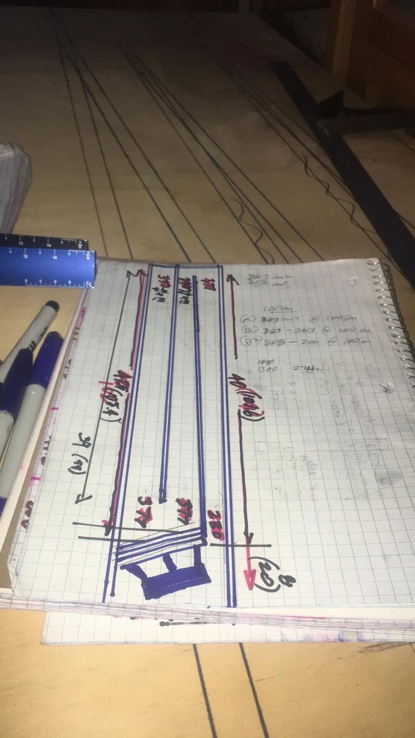

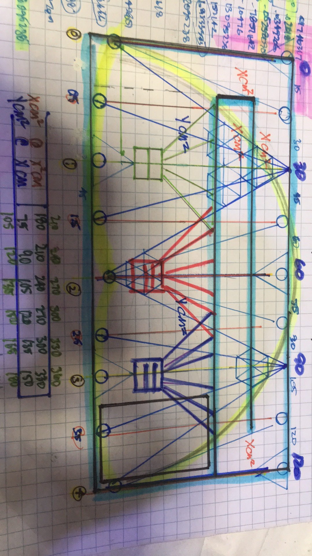

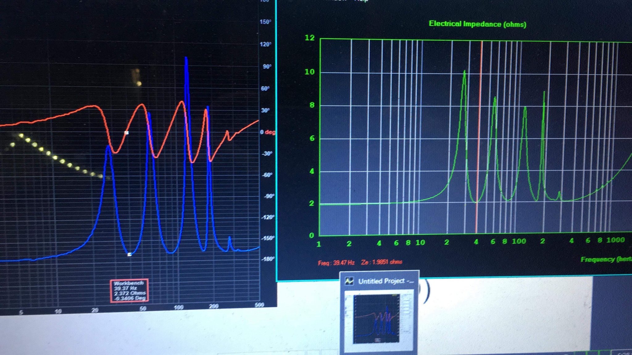

yes, my questions are based on this exactly as you can see👍🏻 But they remain questions answered but create more questions… it’s absolutely amazing(here’s two parallel ‘TL’ with the same exit (240 cm and 80 cm with driver entry @ 20 cm each(the center of 4 “ driver pairs )Before you even start trying to do the math. Understand how it works and affects your direct radiator and response.
Download Hornresp, Leonard audio transmission line software etc. and play around with it, placement of radiator along the length effects the lines behavior.

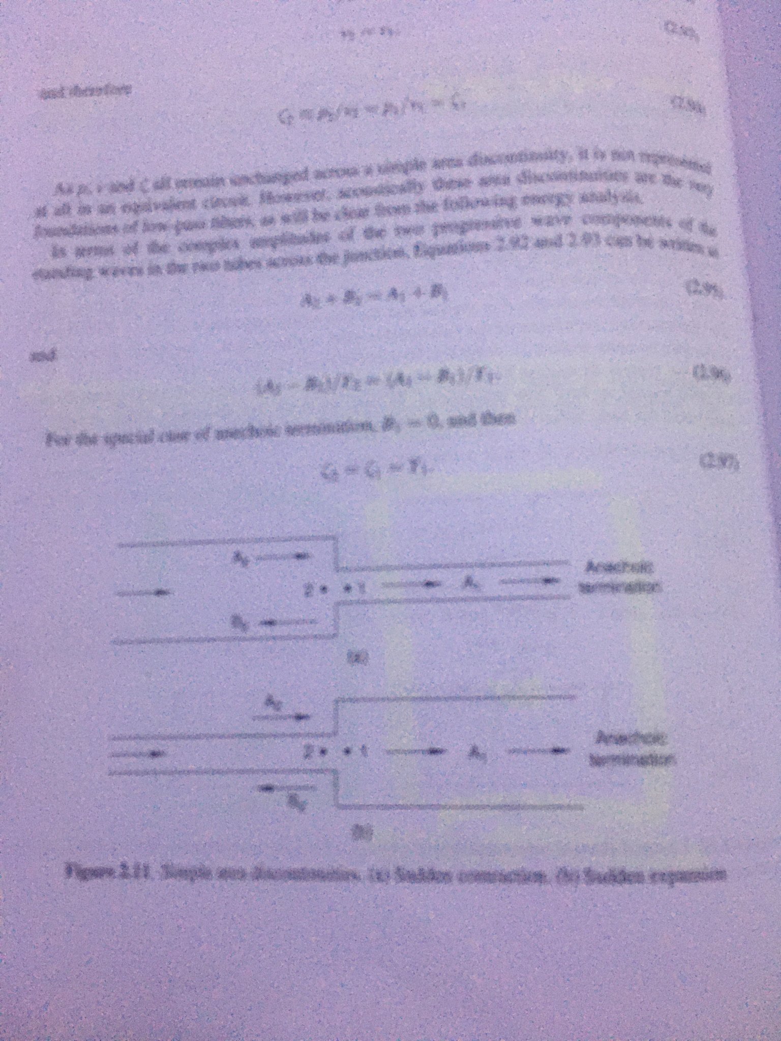

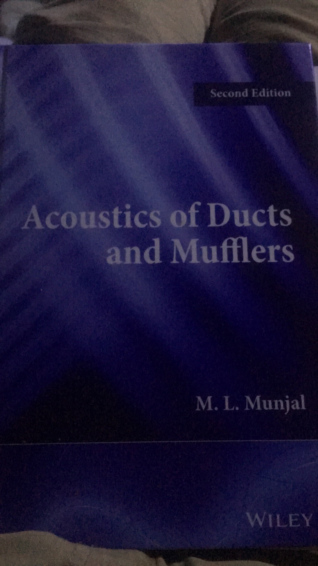

Martin King hookup/suggestion when i was poking him with ‘multiple resonators’ all over both sides of the cone whilehe was sneaking/exploring in a bass reflex to a tl instead .what's the book? it looks good.
perfect/helpful , as always👍🏻I see this is already sufficiently documented, so just another very basic paper for the record.

hard to discern between a singie fold and 2 fold (but never compared perfect apples to apples necessarily … (same driver, same everything otherwise and its always about that 3 x 1/4 harmonic at that point (2 fold offset entry)

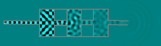

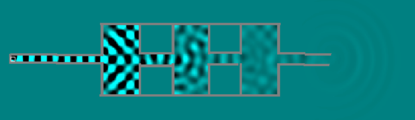

Well, the way I view it based on the muffler description/IME it's always the backside/terminus chamber since it's in series with the output; the fact that it's tapped doesn't somehow move it elsewhere.
The 'tap' in this case can viewed as a band stop filter if you visualize the driver mounted to its closed end, so while normally it creates a deep null, when physically delayed a 180 degrees it becomes a peak, i.e. 'tapped', so of course can become a wider/narrower BW depending on amount of delay as BP6S design theory proves.
this all makes sense and can be viewed in HR (and seen in ‘most’ of my RTA stuff too where it gets hard to keep track)👍🏻👍🏻Well, the way I view it based on the muffler description/IME it's always the backside/terminus chamber since it's in series with the output; the fact that it's tapped doesn't somehow move it elsewhere.

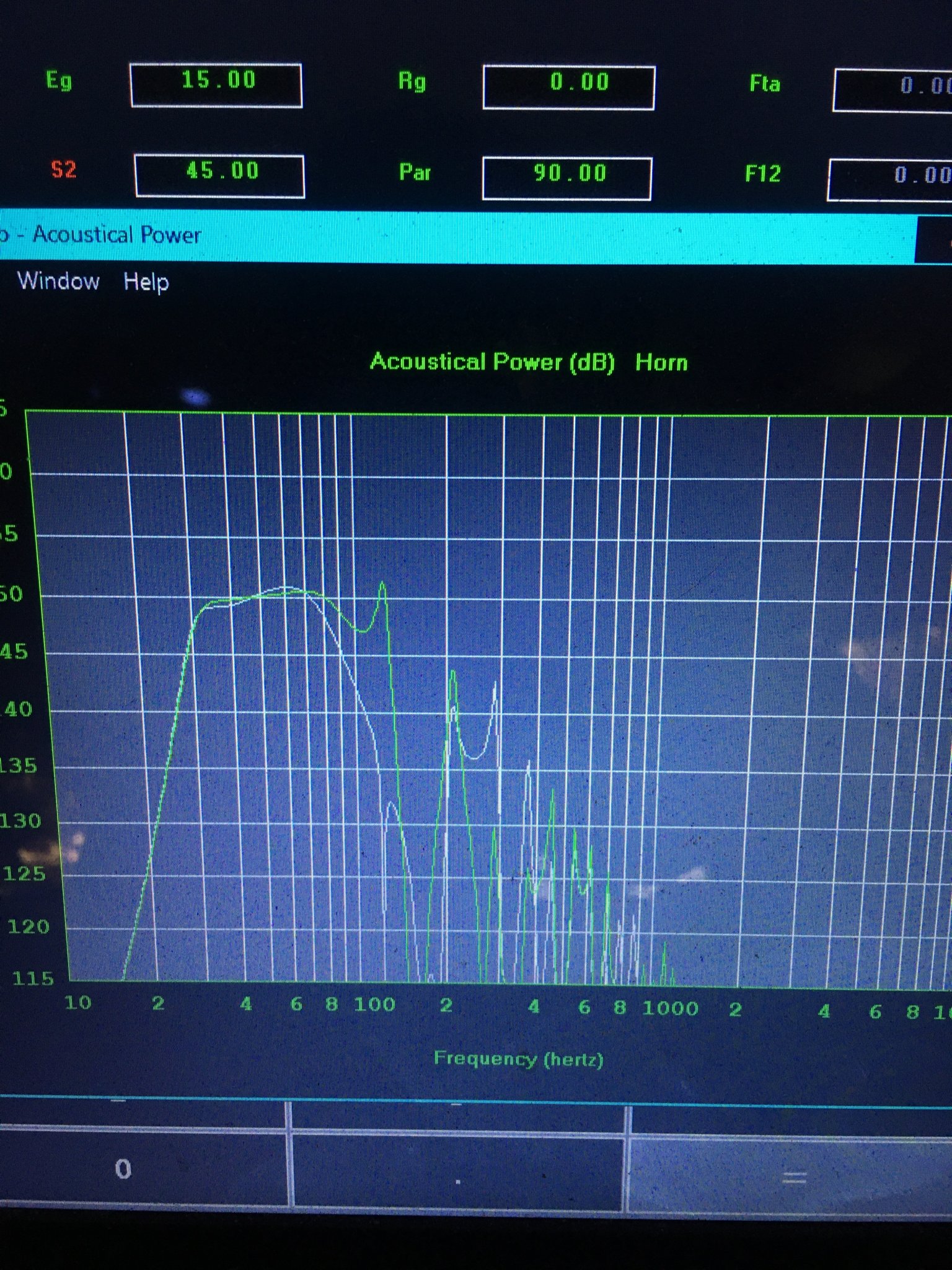

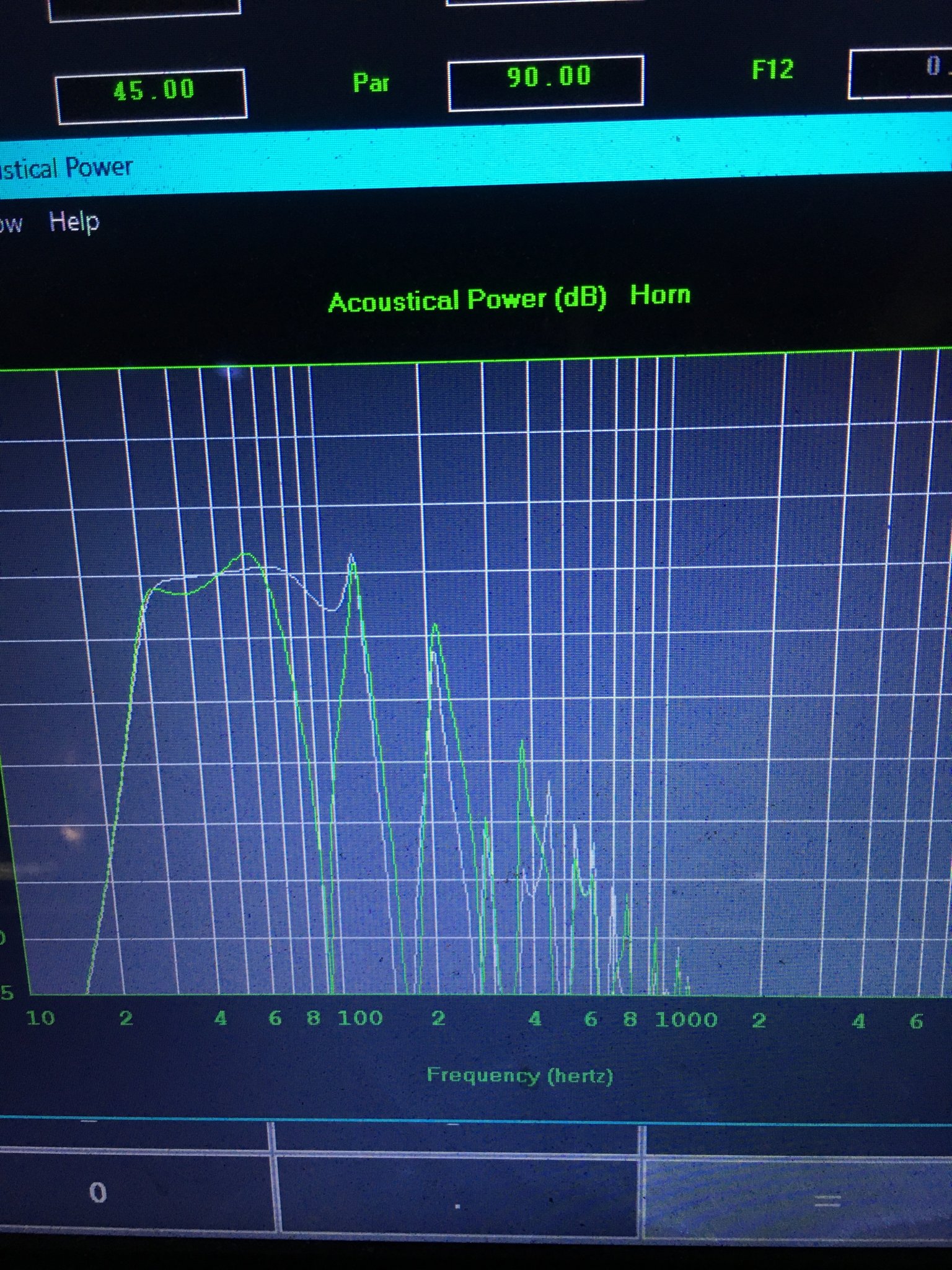

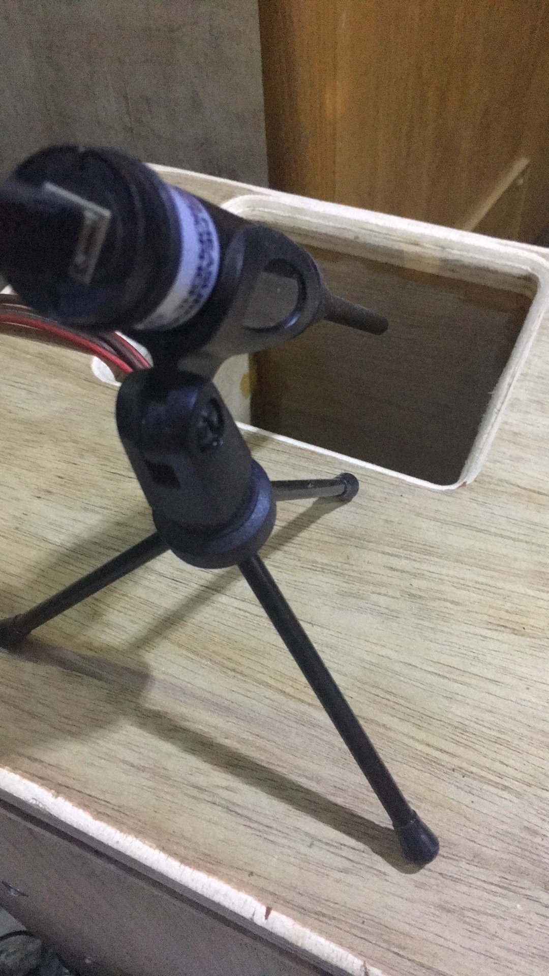

green (first pic green trace )
red(white trace )
blue(last pic green)
driver positions kicked my butt recently using a moveable baffle for a bit
until leaks started becoming excessive from the gaskets getting flattened and pinched, etc and then permanently sealed it into ‘green’ (best) forever
