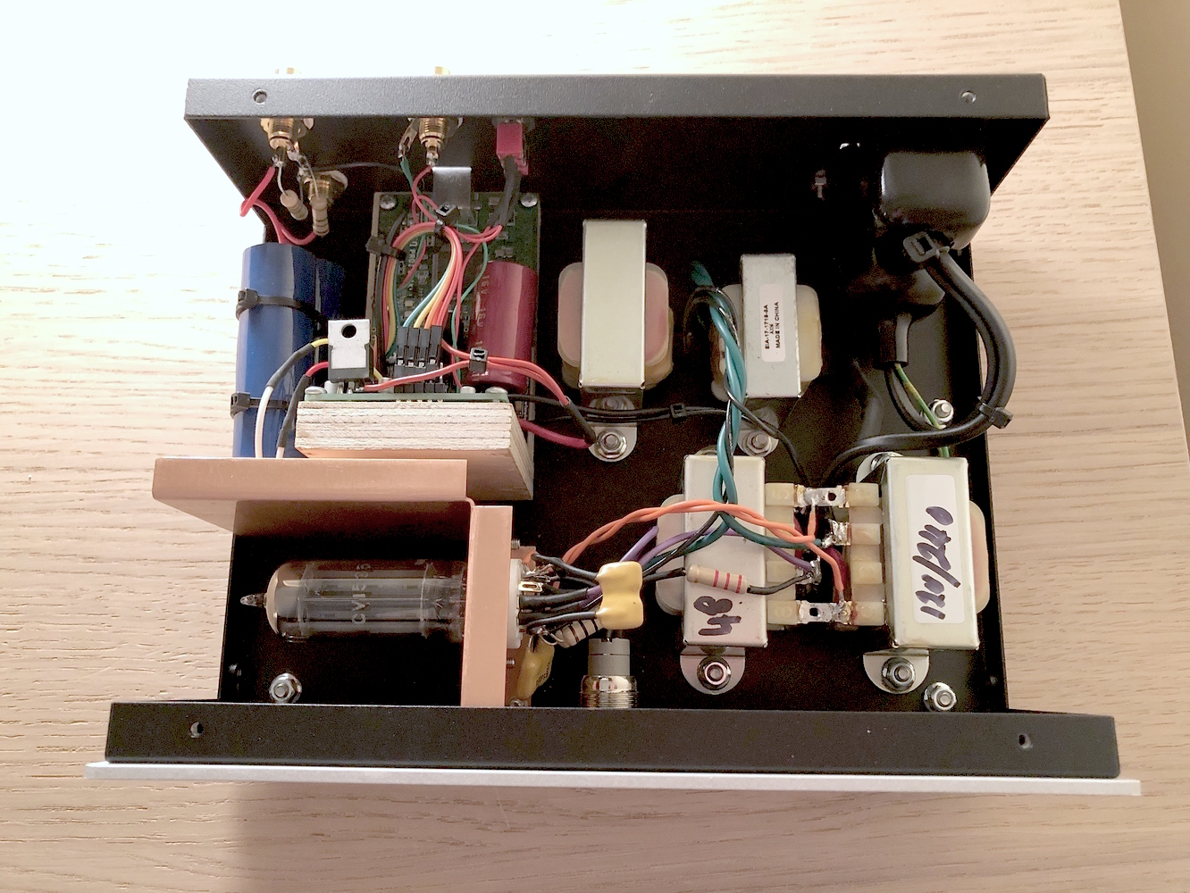

Excuse me for yelling but...
HOW THE HECK ARE THEY GETTING 5V OUT FROM A TUBE SUPPLY??
Im thinkin a tube rectifier then a passive or ss regulator?
And yes the 2015 looks like a joke. The actual dac module is from a korean vendor, and the supply looks to be clc?
The review states this clearly: the tube rectifiers are bypassed with ordinary diodes, which apparently do all the rectification. There is also a switch which disconnects the tubes and apparently changes the sound. Please don't ask me why.
The weird paralleled arrangement of good and bad rectification can also be seen in some of Kondo's amps.

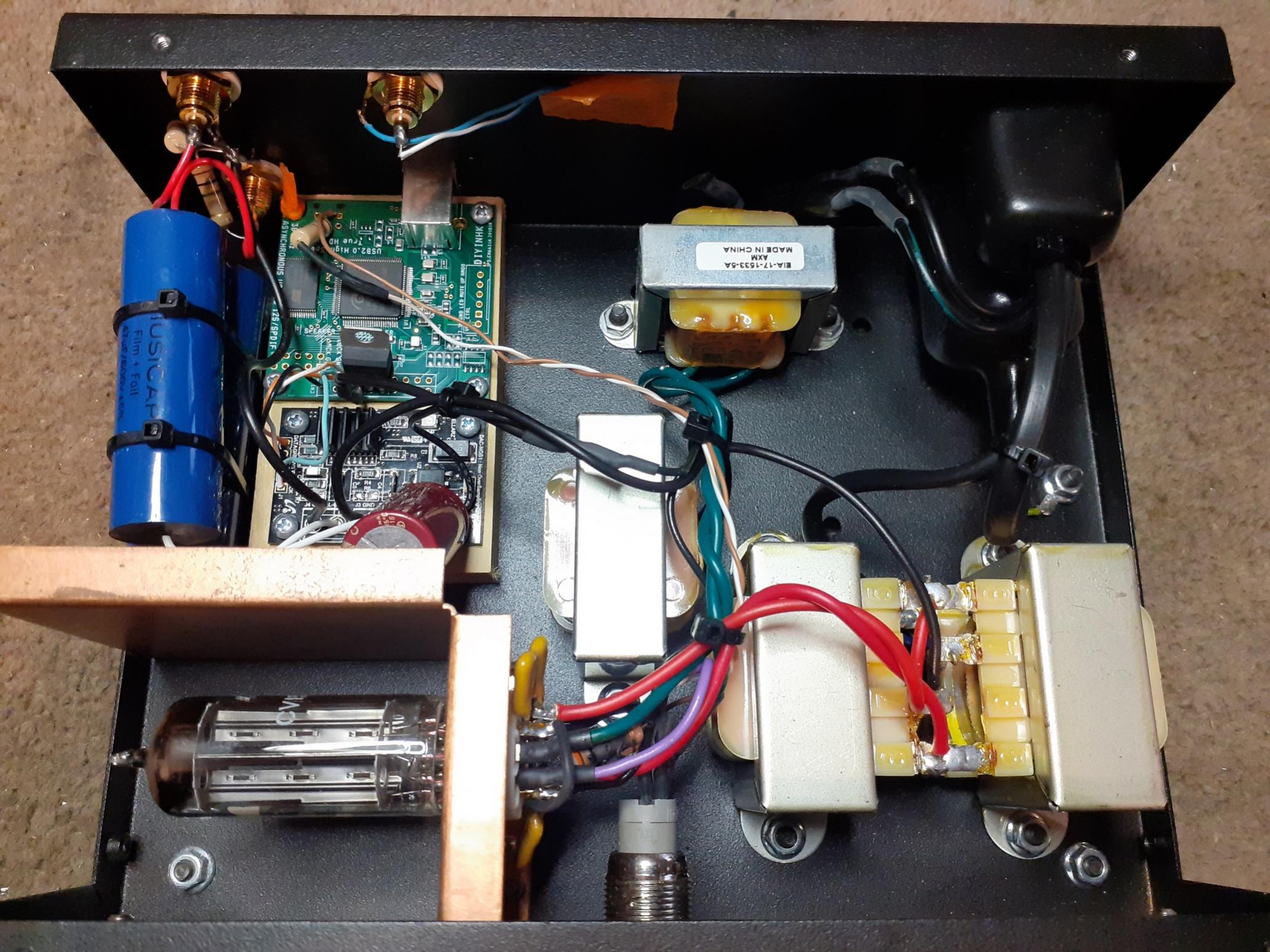

Looks like an amateur construction. 😛Found this photo on a Russian website.

I just got one of these things in for repair, so I am showing you this exactly as it came to me and as I observed it after taking the cover off.
This is what I have found:
One of the 33 ohm resistors attached to the rectifier tube has completely smoked up, unsure why.
The wiring isn't great, some of it is solid-drawn copper - looks like CAT6 wire pulled from a cable.
It has two transformers in a series-parallel arrangement (they could have used just one transformer with the right current and voltage ratings) for the main supply and another transformer for the filaments on the tube.
The switch on the front controls just the filaments on the rectifier tube.
The tube rectification is effectively bypassed by silicon diodes, why this has been done I really don't know.
There are wires straight-soldered into holes in the PCBs that look like they were an afterthought.
A 1 watt resistor has one end soldered into a PCB hole, the other end is in mid-air with a wire soldered to it and goes to the LED on the switch.
There's a 3-terminal regulator just stuffed into some utility holes on the rear board, and the wire to it from the 'tube' rectification is just soldered to the outside of the pin.
The front board has a huge electrolytic cap just jammed into the utility holes at the front, off the board and soldered in at an angle.
The SPDIF output is disconnected - wires taped to the rear panel with orange masking tape. I expect this has been done by someone, I would not expect it to come from the supplier like this.
The same orange masking tape is around one of the screws holding the rear board down - why?
There is a choke in the middle of the unit, which the LV passes through.
The output is fed to two large 47 uF 600 V Musicap 'audio' capacitors, which are cable-tied down then fed to the output sockets which are badly soldered.
The rear board is supplied by DIYINHK (DIYINHK) which looks to be a chinese supplier of generic audio boards, none of which I would say fall into the expensive or esoteric high end of audio.
The front board is a DAC-NOS-1 and can be had for about $40 on ebay.
For those curious about the voltages, there's 6.3 V on the heaters of the tube so it lights up.
There's about 17 volts coming off the tube-diode arrangement, which then feeds a 3-terminal reg which provides the 5 volts to run the boards.
My thoughts:
The unit is an amateurish arrangement of cobbled-together chinese/korean made boards, both of which are screwed to a bit of wood. Really?
I don't understand why they've done the hack with the rectifier tube and diodes. Is the tube just for show? It lights up, that's about it.
Maybe they had to pretend to run the power through it in case someone took the cover off.
This unit has the USB connector and SPDIF, and according to their website (BorderPatrol Digital to Analogue Converter) retails for $1850 USD.
Seriously?
There is probably $100 of parts in this thing at best.
The website has some pretty glowing (over-hyped?) reviews from notable music industry people. I think they're either all seriously deluded, the reviews are fake, they were all trashed when they wrote them or they've been paid a shed load of money to endorse this thing.
It has the look of something that a college kid has tried to assemble one night while watching TV. Aside from the case and the power switch which aren't actually too bad.
