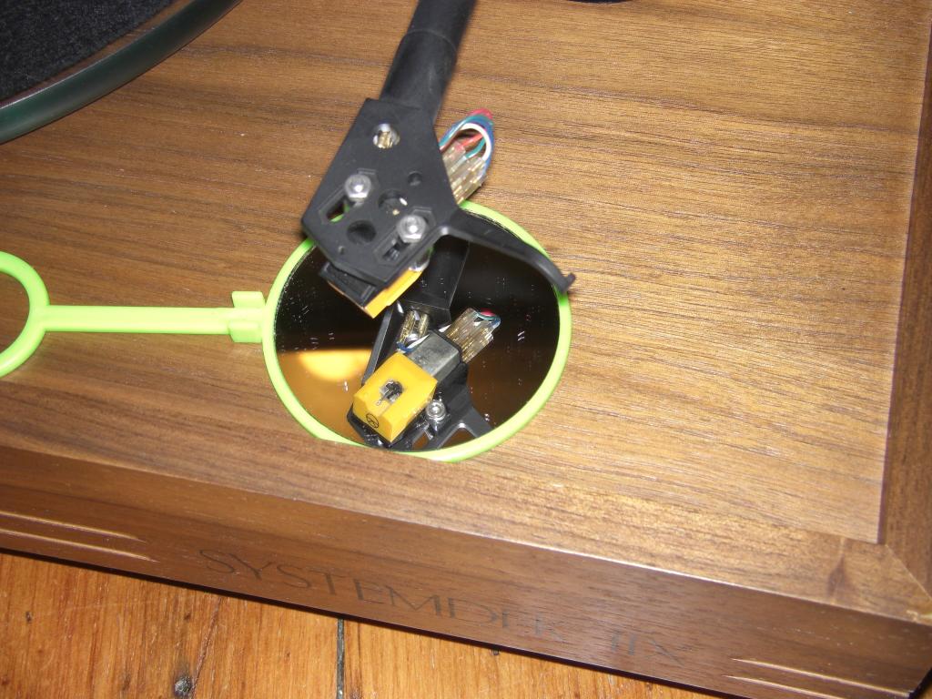

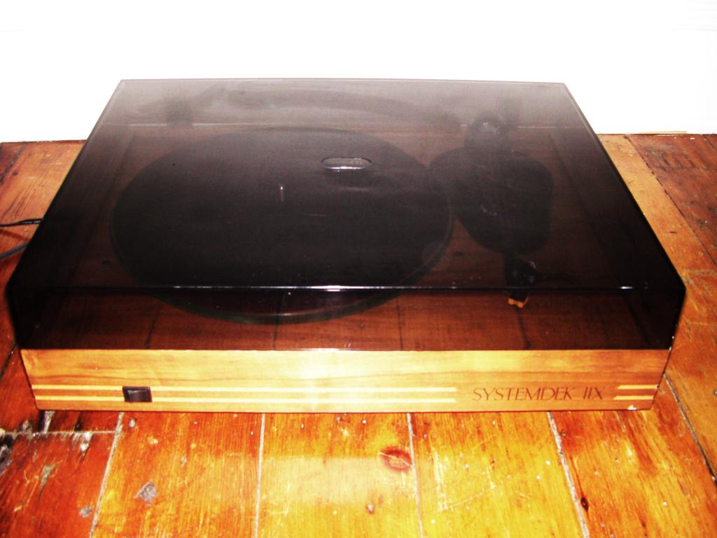

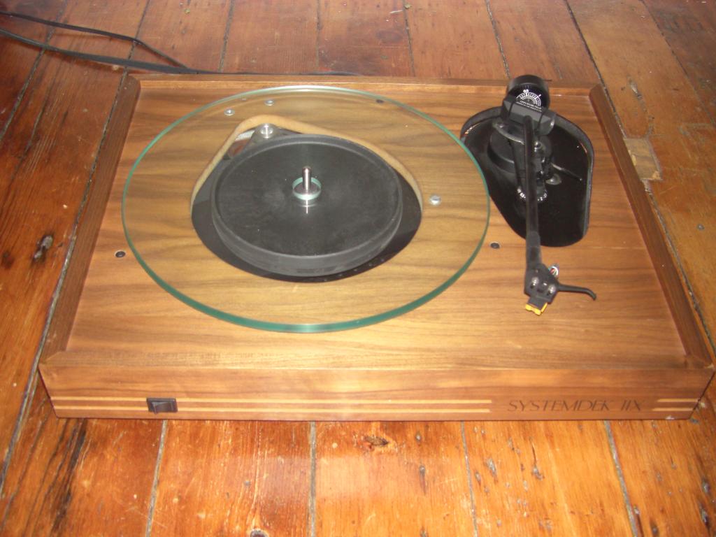

i have a systemdek turntable for sale on ebay.
i really, really want to make sure that i protect it so that it doesn't get damaged or come out of calibration/alignment when i ship it.
here's my plan:
remove and bubble wrap the glass platter
disconnect the belt
use foam cutouts to wedge the drive system in place so it doesn't move around.
use non marking painters tape to secure the tone arm (even if it's clipped in to place) and the top cover.
bubble wrap the unit with the cover on in at least 3 layers of bubble wrap.
what do you think?
here are some pics to get an idea of what i'm talking about:

Sounds solid. Additionally i would remove the head shell ,if possible,
and the counterweight and pack separately.

great ideas!
i'm a little concerned about removing the headshell because i'm concerned that if the stylus gets too much contact it may get damaged. is this an unreasonable concern? seems to me it's safest hovering in place. removing the counter weight is a great idea. i can probably cut out a piece of foam to fit it in.

Ideally, the buyer would be within a few hundred miles and you could deliver or have them pick up. Lacking that, assume the boxes will be dropped 6 feet on any face or corner. If your packing can't stand that, it's inadequate. Anything that can possibly be removed should be, and packed separately. Any type of dust cover has to be packed alone- they never survive otherwise. It's best to duplicate the factory packaging if possible.

Bubble wrap the platter and glass and ke the complete arm off and bubble wrap that also.

I kissed a Talisman S cartridge goodbye shipping it attached to the arm. The arm never moved, some debris was knocked loose and broke the cover over the cartridge. No more cantilever.
Ship the parts dissasembled and seperatley protected.

Buy a sheet of the pink rigid foam insulation and use that to make spacers, wedge things in place, or reinforce corrugated cardboard. Wrap the cover in bubblewrap, then place it separately in its own carton. If you live in a city of reasonable size, there should be someplace that sells cartons. Some are available in doublewall construction, which isn't cheap, but adds a lot of protection. Your buyer should be willing to pay for proper packing.
Packing the base is tricky. I'd look for a doublewall box that was a close fit (but with plenty of overhead clearance), then use blocks of rigid foam to clamp it in place. If the base had secure mounting points, maybe bolt it to a sheet of plywood and build a crate around that, or at least a sort of framework to brace it inside the carton.
Headshell and cartridge could be immobilized in foam, or (maybe best) ziptied to a U-shaped piece of cardboard, and stuck in a small cardboard box separately. Counterweight: wrap in bubblewrap and in its own little box. Put all the boxes in a one or two larger cartons as convenient. Extra layers of cardboard help prevent puncture damage.
Visualize it falling off a conveyor belt 6' into a bin, or bouncing off the edge of the bin another six feet onto a concrete floor. Where it's kicked to the loading dock by a disgruntled employee wearing cowboy boots. Or check out that website that shows turntables damaged in shipping.

Thanks for all the suggestions everybody. My auction has now turned into a message board of sorts. I've had many emails from many current owners of the same systemdek offering great advice.
i think i have it locked down now.
