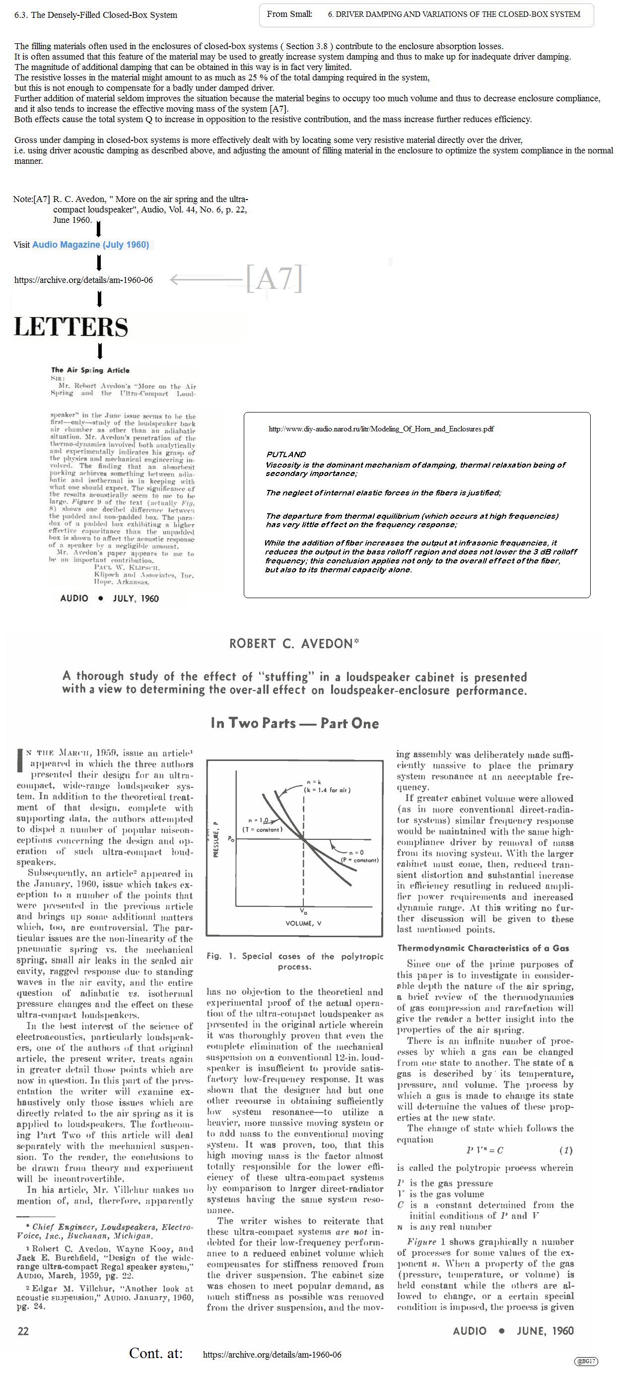

http://www.kirchner-elektronik.de/~kirchner/Speaker_Development.pdf
Starting on Page 50(W5.3)
Studying the enclosure lately - Thought this might add something to the topic here.
As bjorno has linked, the relation between apparent box size and stuffing is a known mechanism. If you have no stuffing, the air in the box compresses adiabatically where p(v^1.4)=c and the air heats and cools slightly during compression and expansion.
Adding stuffing at the critical amount gives a large amount of surface area for the air to transfer heat to, making it an isothermal process that behaves with pv=c.

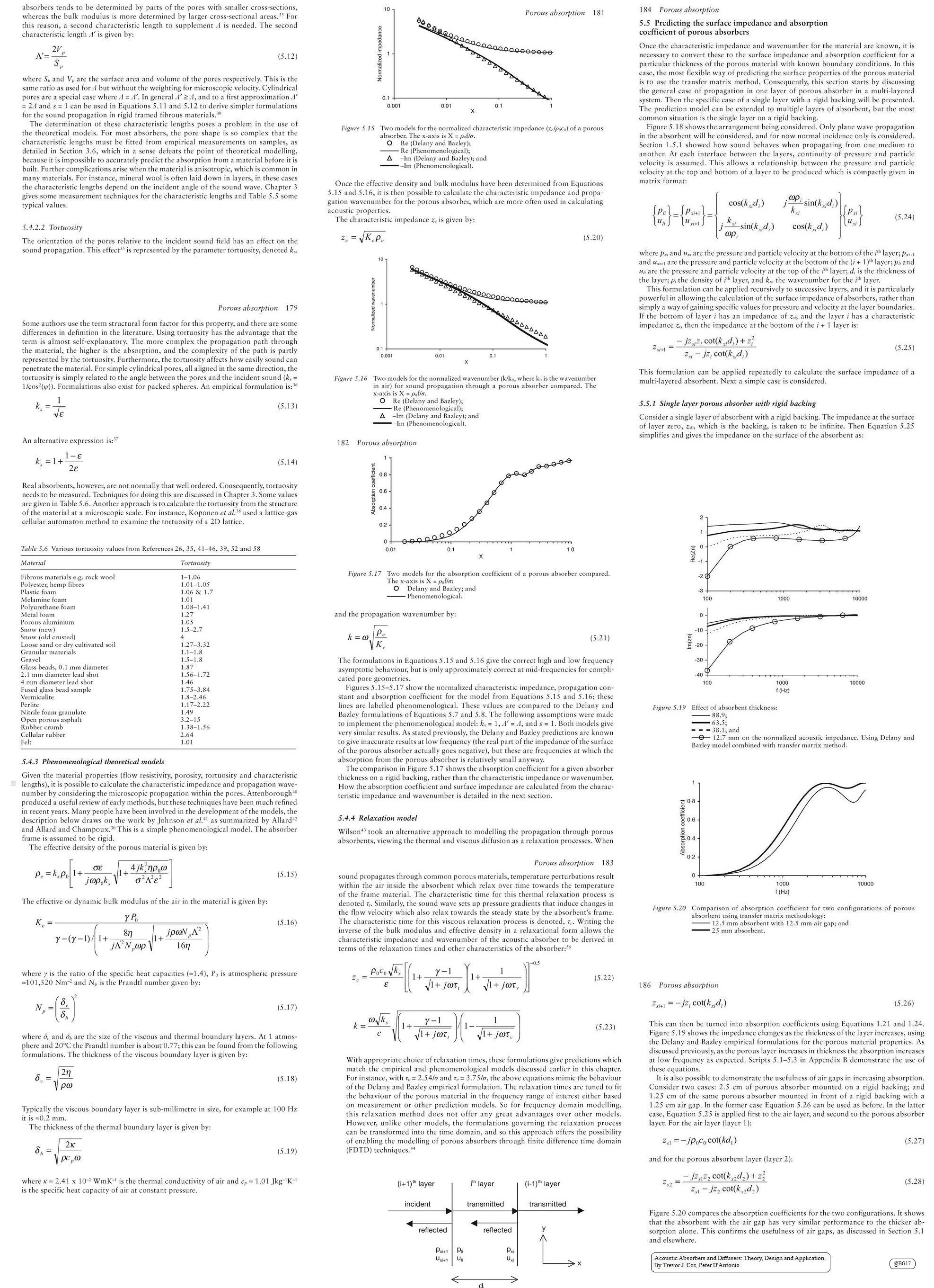

Acoustical Resistance
If I remember well from the Olson book stuffing acts as an acoustical resistance.....

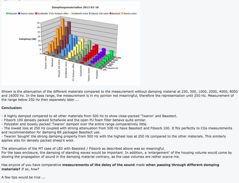

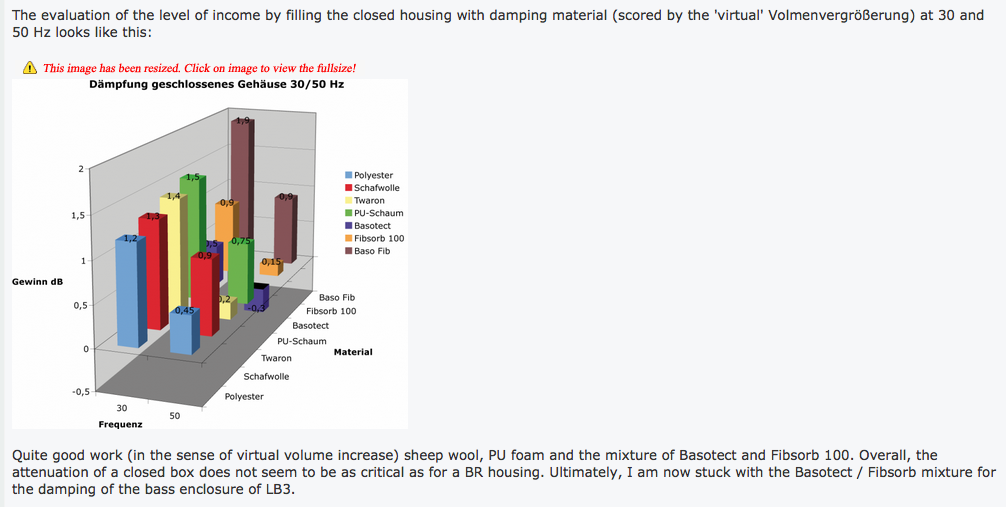

... but polyester fibers are the worst material according to tests done by a German magazine.
