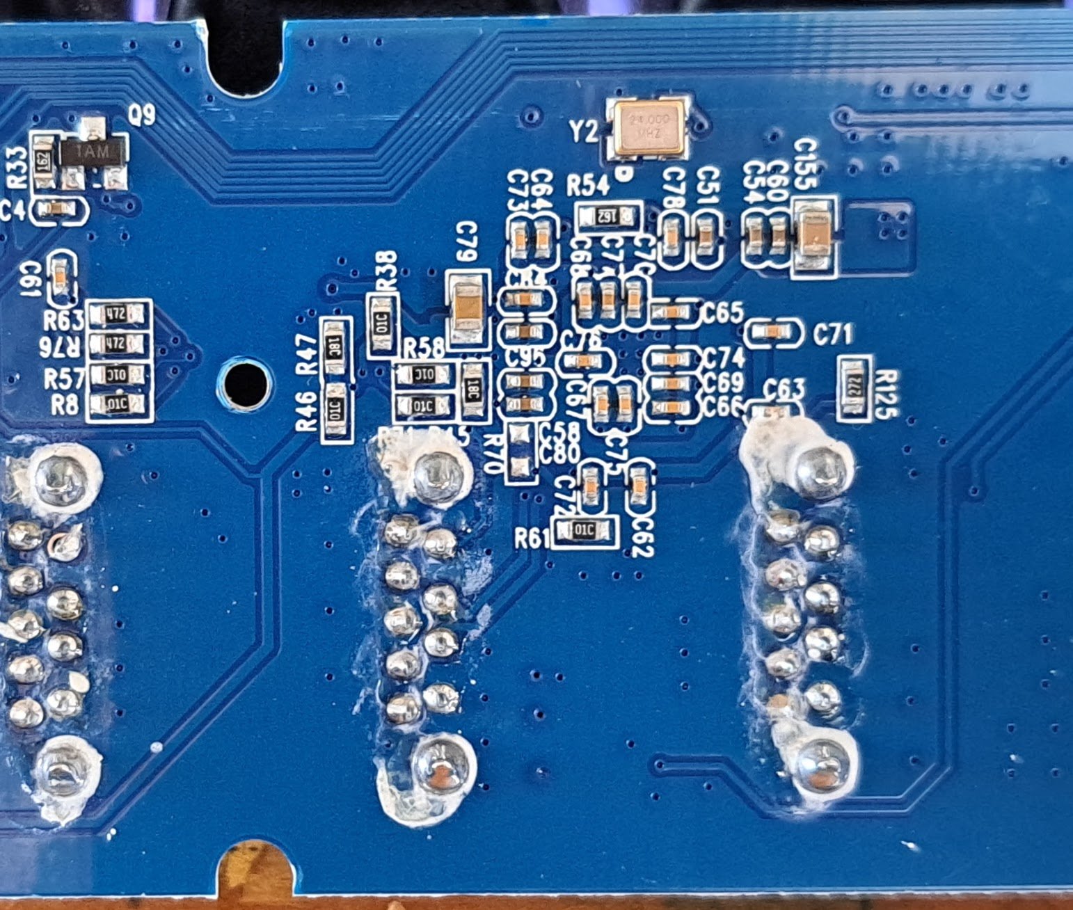

The attached is the back of a USB hub that stopped accepting power from the wall wart. I took it apart because I can't help myself and was wondering what the white stuff was on the hand solder on the board mount USB sockets. It's easily scraped off with a finger nail and I assume its flux residue, except that there's the more normal flux residue there as well and it's only on the pins that're connecting the socket case to the board.
Any ideas?

Hi I know this from cleaning water based solder flux also with water.

I was just curious why the white was only around the socket support pins. I'm not up on industrial soldering and thought there might be something to learn.

The white stuff may also be from water based flux and hand soldering without cleaning. The smoke sometimes has this consequence. Not easy to remove.

They might have hand-soldered the connectors. Probably used solder with no-clean flux. You don't technically have to clean no-clean flux off the board, but it's generally a good idea, at least in sensitive circuits. As you can see the flux residue can attract stuff and react with it.
