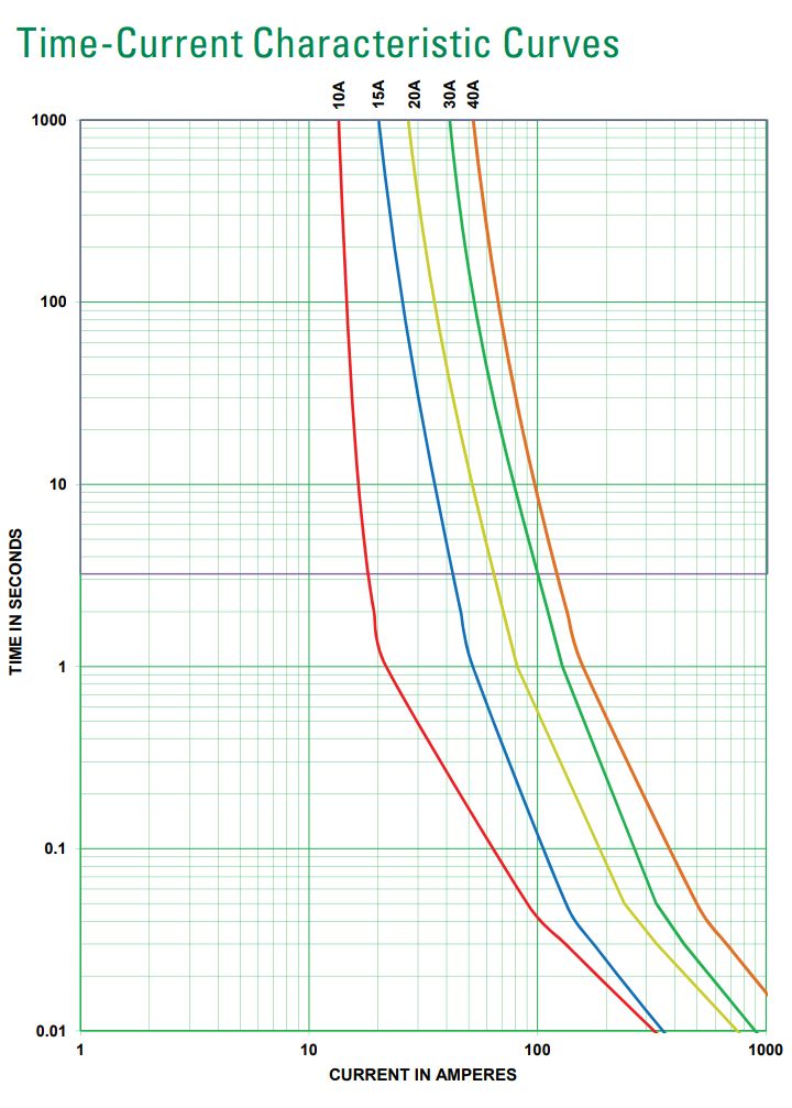

A fuse subject to, say, 100% overload, will take a couple seconds to blow open.
It is in the datasheets and you can check that yourself.
https://en.m.wikipedia.org/wiki/Fuse_(electrical)
From Littelfuse themselves:

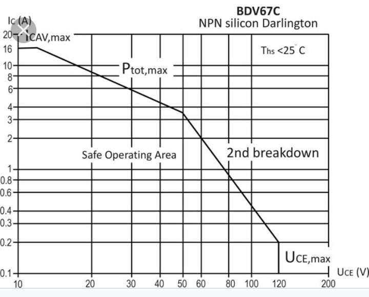

Semiconductors, specially Bipolars who show second breakdown, will die in milliseconds.
Here we have a nice powerful 16A 220V 170W power transistor, which might be a good choice for, say, a 60 to 100W amplifier.
Thermal damage looks like we expect, meaning we expect it to fail if dissipation is exceeded but not before.
BUT that holds only up to meager 50V 😲
Good enough for, say, a 25-40W amplifier 😫
How come?
Notice acceptable power dissipation curve holds well ... up to 50V that is, and then bends down catastrophically.
At 50V it stands 3.5A for a dissipation of about 175W 👍🏻
At maximum 120Vce it "should* stand 175/120=1.5 A.
BUT graph shows it stands only pitiful 0.2A 😲😫
No reasonable fuse will protect such a weakling
Couple seconds delay will protect power Transformers, mains wiring, electrical generators, stalled electric motors, etc. , all of which:
Again shown in datasheets.
