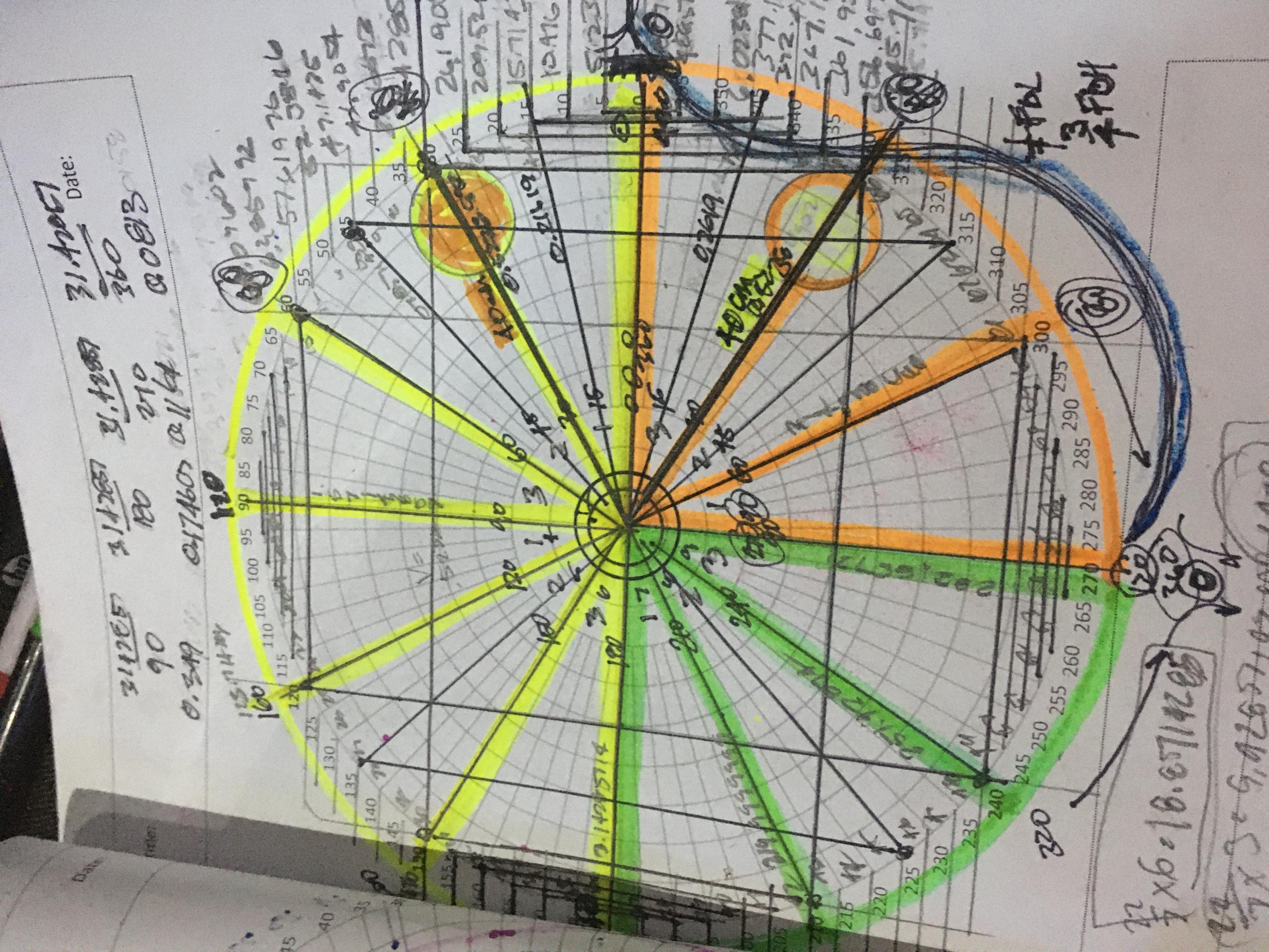

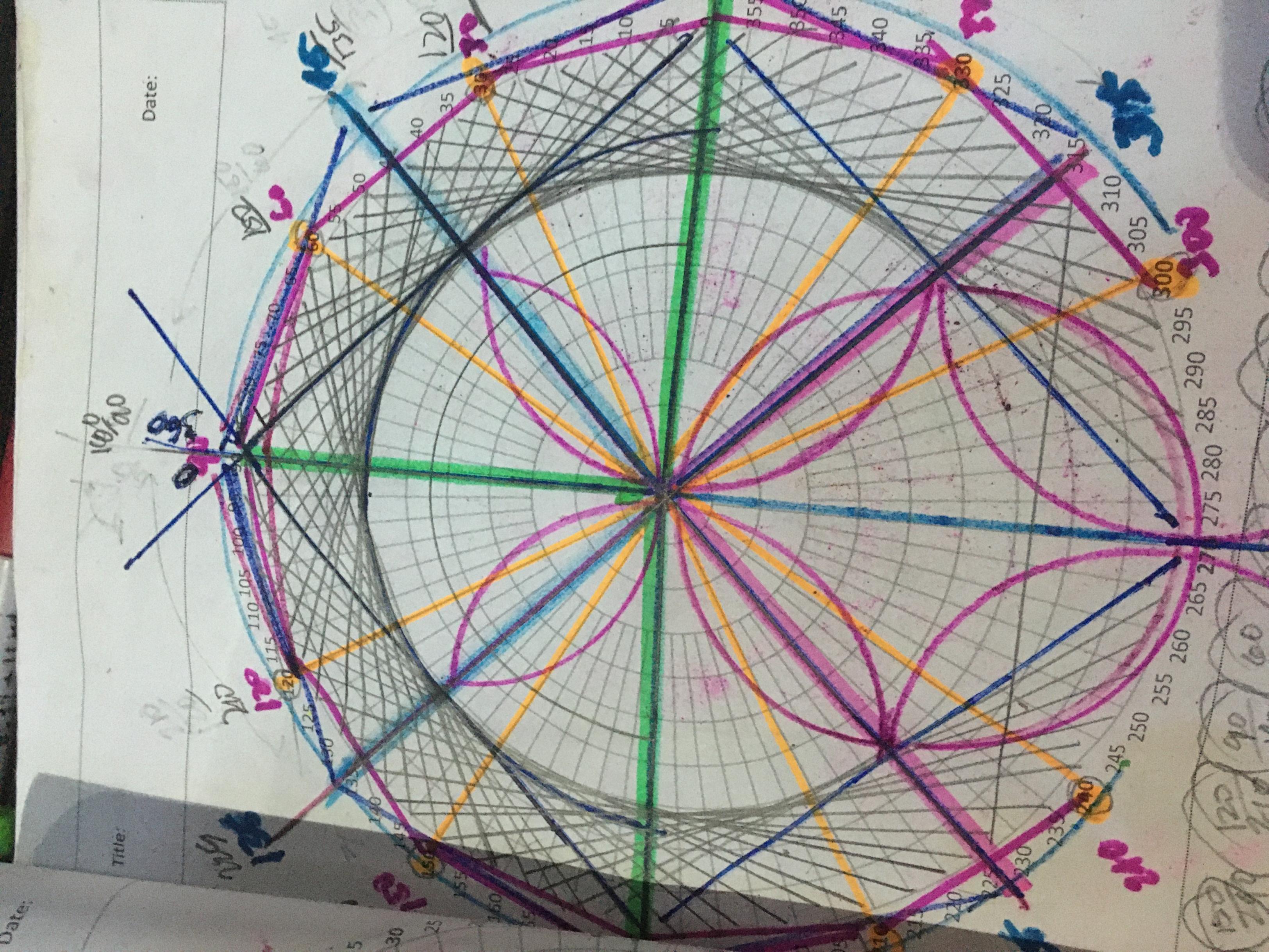

what a great thread!! (edit/ i can't get pics to upload here) i think (i'm positive ) it's hidden in this but it's all based on the odd harmonic /standing wave that traverse..
each parts of a sphere/circle which in math can be seen as platonic solids just like the old greek and egyptian maths did it all long ago. it's so clever yet nostalgic. ironic when you find the age old ancecetry math is the modern answer. not a sores shert or calculator.. just horn respond and graph osier with isometric views in 1/4 as 30/60/90 degrees is on that. it's the math in much easier for digestion . and it's visual.
. i found the high order qw answer to everything this way. it's perfect! over and over.. but it's different if massloaded and the ratios are just outta my grasp. i've had a little bit of luck as a bow tie or bevy tutu shape , but nothing consistent like straight pipe and the pipe physics says why.. node abd harmonics w only pure ones not the taper or flare endless umbrella of them. it's a hard pill to swallow. but it's just the plain view to see..aand simple is always perfect ..
i cannot build /design a flawed dual compound parallel /series TL now. but i cannot quite get the mass loaded varieties into this.
typing sucks but the math is all in platonic solids as it then stages into the circle. nodes and anti are a hexagon overlaid on a circle you see this as a hexagon is 6 circunferece(perimeter) the circle is 5.236 per 5 of the hexagon sides (6 parts each). doesn't sound like much, but next compare the volumes? and also add up the parts as degres in the circle (trig, calculus whatever it's just the unit circle. google it . pinterst has pics . you'll see. i promise it will help and you'll grab it..
4/3 pi r^3. volume spherre.
c = pi r
compare the cube and sphere as 5.236.
now look at 6 parts of a perimeter of a hexagon. now look at 12 individual parts of a circles. there's 3.143 at 30 degrees, 31.43 at 300 and there the hint . because its .2618 .5236 and 1.0472, and keep go in g at 180 , at 330... it's all there
in a cube or hexagon(overlaid. this is the start of the answer. it's too much to type ..tilt the second hexagon at the velocity pressure .
c = pi r
i'm not picasso but this is math with colors. it's solid , follow it as 90 degrees instead of 360 (qw instead of compounded 360). i think it'll fall into place . those are nodes at every other hexagon corner and this is 30/60/90/130/150/180 and trig is in .349/90, /180, /270, /360. it's pi (31.43 ) at 30, for a ~30-32 hz tune. tricky.. break it down to 1/7,7/7, 11/7, 22/7.. then you find 1/4, 3/4, 1 1-1/4... 28/7, 14/7, 7/7... 44/7, 49/7.... 13.9 billion/7 (14/7)is still a node. and so is 7.02969.., only 11 orders of operation later . this works all the at to sound .
