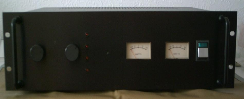

Good point Ed. Switches do need to be suitably rated. Mine is... a big illuminated rocker. Its been in use for around 17 or 18 years and used 2 or 3 (or more) times a day. Still perfect although the neon isn't as bright as it once was 🙁 to many hours on the clock.

Did you use it on 115V or 230V?
In old money its on 240 volt, supply is often around the 243 region.
