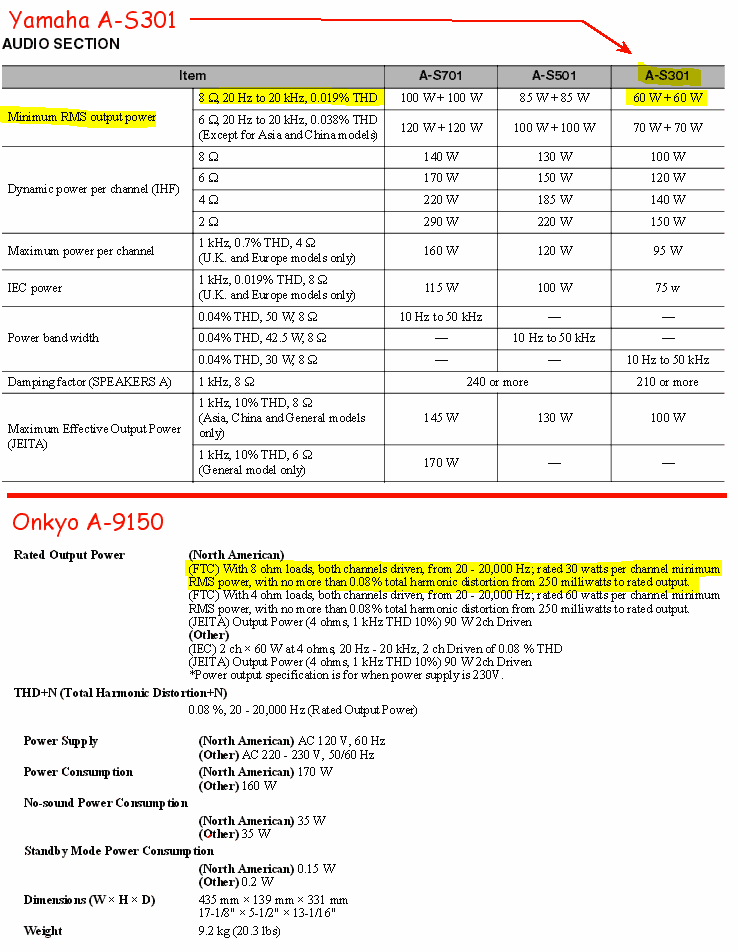

I am browsing for an integrated amplifier and I stumbled upon the Onkyo A-9150, that meets all my requirements (budget, good sound, discreet class AB design, internal DAC, pre-out, phono, the whole package), but I am really curious by its power rating. Looking at the specs, it is rated as 30W/8-ohm and 60W/4-ohm with 0.08% THD from 20 to 20,000Hz.
Okay, but the manual also states that it weighs 9.2 Kg, almost the same (even heavier) as the Yamaha A-S301, that weighs 9.0 Kg. Only the Yamaha is rated as 60W/8-ohm with 0.019% THD and 70W/6-ohm with 0.038% THD from 20 to 20,000Hz.
Upon inspection of pictures over the internet, their transformers are pretty much identical, just like their chassis. Also, the Onkyo has two 10,000 uF capacitors, and the Yamaha two 6,800 uF caps. I am definitely no expert, but for what I have seen in the service manual (very superficially), the power supplies seemed very similar to me. And the voltages indicated in the power amplifier section were 40 V for the Yamaha A-301 and 37.5 V for the Onkyo A-9150. I don't know if that difference is significant to that point.
How come is this difference in power so big? Where is all the power in the Onkyo unit going, if not the speaker output? Any ideas?
PS.: If you look in their service manuals, I guess you will find that their topology is similar and that the Onkyo A-9150 amplifier transistors are even more powerful than the Yamaha A-S301's. I also noticed that the idling current adjustments are different: the Yamaha asks for 1-10mV on the emitter resistor, while the Onkyo asks for 20-30mV. Maybe there's something in that, but I just don't know enough to make something of this.

Are both specs the average power while continuously playing sine waves or is the Yamaha spec a music power, peak power, peak envelope power or whatever manufacturers come up with to get higher numbers power spec? Are both specs at low distortion, or is the Yamaha spec for 10 % THD?
...the Yamaha is rated as 60W/8-ohm with 0.019% THD and 70W/6-ohm with 0.038% THD from 20 to 20,000Hz.
Power output is relatively unimportant, considering at normal listening leves, you rarely need more than one watt.
Lacking norms how to precisely measure output power, it's no surprise that similar amps are rated completely differently.
Not that there are no norms, but there is no authority to inforce them.
Remember the days when small boomboxes powered by six batteries has sticker claiming 2x120 watts?

A manufacturer can rate their amplifier under any test conditions they specify - as long as the conditions comply with retail laws in the country of sale. So if a manufacturer is facing stiff competition from others, all they need do is specify different conditions where their product looks significantly better. That won't suit all customers but they are looking for market percentages, after all.
If you think about the power specs, the Onkyo model has exactly double power at 4R loads compared to 8R. That's highly unusual with class AB unless the issue is that it has comparatively low power supply rail voltages. On the other hand, Yamaha's model delivers only 17% more power with a 6R load and isn't even specified for 4R. I suggest the difference here is primarily with the power supply voltages. The relative size of the transformers probably has less to do with this.

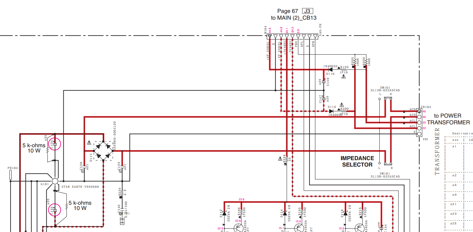

The Yamerhammer has an "impedance" switch which re-taps the power transformer to optimize for 4r or 6r loads. The Onky (like 98% of amps) uses one transformer which must be a compromise.
Rough numbers squinted, guesstimated, and interpolated from incomplete data in service manuals:
Onk 9150
rails: +/-37V
max gross power: 55W@8r
Yam 301
rails: +/-38V@4r or +/-46V@6r
max gross power: 84W@8r(on 6r tap)

So, would you attribute this difference in output power to a more flexible power supply design of the Yamaha? The Onkyo doesn't have a switch to change taps in the transformer, but I think it has a thermal protection that is more strict when 4-ohm loads are "selected" in the menu.
Thanks to your high-res. image, it's now possible to see a few voltages. PRR had to squint and guess what the text on the linked manual showed. Anyway, the point is that Yamaha uses a higher voltage tapping on a similar size transformer and this allows much more efficient 8R speaker use whilst still being capable of 6R use. The original NAD 3020 models had this feature too, many years ago. On the downside, it's likely that the Yamaha model will current limit and distort if 4R speakers are used at a high enough level. It isn't even specified for 4R use.

The '301 has a big brother, the '501, rated twice the power. My squint suggests the 33V/40V numbers are for the '501, the '301" "should" have lower rails.
Some funny business may be involved. When a maker has a series of models, it is not unknown to down-rate the lower model so as to not compete so much against the higher model.
Still very odd. The '301 sells for $350, the '501 for $550. This comes to $200 for another 60 Watts. It is insane to charge $3/Watt for incremental power in this day and age. (We passed $1/W in the 1970s, and I have seen $0.20/W recently.) For what is not an exceptional circuit technically (no CAT-SIT devices, no Pentagram topology, no multi-servo correction-loops...).
