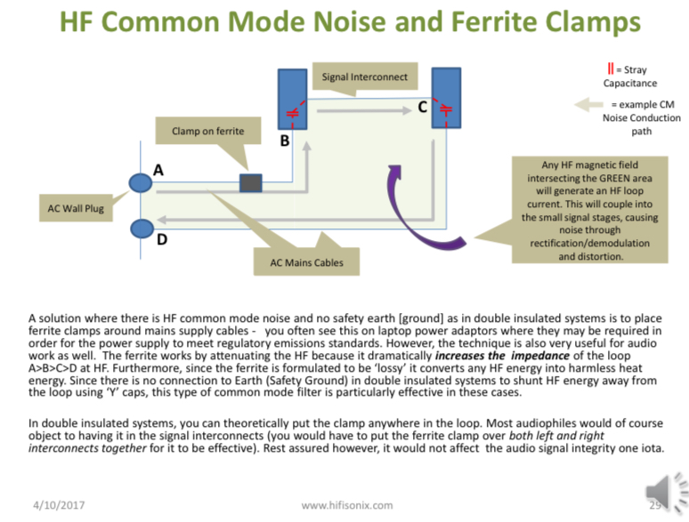

Put them as close as you can to the port. Essentially, below ~500 kHz, ferrites basically look like a short (mildly inductive, but that's generally negligible). At higher frequencies, they more or less look like resistors. In between they are more or less an inductor.
Rule #1: Every wire is an antenna, and every wire is a transmission line. Most RFI makes its way into an enclosure on cables entering and leaving the enclosure. That includes the AC power line, every input, and every output. The IEC line filter module (which you should be using!) keeps most RF from entering or leaving on the power cord. Ferrites are a powerful tool to deal with this. They also serve as a way to break RF ground loops.
You won't hear a difference (and certainly not an improvement - they're not the most linear things ever) from ferrites unless you've got an RFI problem. If everything in your system is working as expected, there's no need to start throwing ferrites at things. Usually modern equipment (especially well-designed equipment) won't need it. A 40-year-old phono preamplifier is a whole lot more likely to have issues than a modern DAC or class D amplifier.
For example, at my workplace RFI is a constant battle (plasma physics experiment). RF for plasma heating, 80 kV switching power supplies, RF excited ion sources, pulsed lasers, etc. It's always interesting to see that some equipment is almost bulletproof from an RFI perspective (I have never managed to take down anything made by Tektronix or HP/Agilent/Keysight from this), while others will fall over the moment even a tiny RF ground loop is created (cryogenic monitoring equipment seems to be quite prone to this). It's all about how well the I/O filtering is handled (and a little shielding, occasionally).
What kind of issues does it usually manifest? It ranges from audio-frequency noise (a lot of circuits work as AM demodulators even if that isn't their intended application), oddball system glitches, system resets / lockups and (in our lab at least), equipment failure. That said, it's very rare that I find a need to install ferrites on cables in an audio system.

Ferrites (along with virtually any magnetic material, including soft iron, mu metal, nickel, etc) have mediocre linearity at best due to their magnetic hysteresis. That's why we try to avoid ferrous alloys for speaker connectors, for example. This is a known, documented, measurable effect, and it's one of the (many) things that makes audio transformers quite difficult to design. Despite this, I've actually had pretty good success controlling parasitic oscillation with ferrite beads on the output of solid-state power amps, without too much measurable distortion. The amplifier in question still had no trouble meeting my standard (which is that 0.005% THD+N is good enough and any further improvement is only useful as an academic exercise).
It does not apply, however, to common-mode chokes (which is how clamp-on ferrites are generally used). When used common mode, they will have zero impact on the intended signals. The physics here is pretty easy to understand - the magnetizing force from the two conductors cancels. Even with very high-speed signals (pulse generator outputs with sub-nanosecond rise and fall times), common-mode ferrites generally have no impact on the normal (differential) signals.
Common mode chokes for differential signals, yes, agreed. Similar clamp-on chokes used on single-ended stereo signal cables is of course another matter. There the effects can be quite audible in some cases. Just mentioning it for people who may be using such cables. Had a cable that came that way with an old computer sound card (ferrite clamp around shielded cable with dual SE audio signals).
