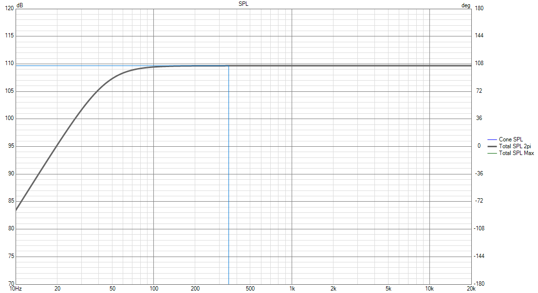

Vifa/Peerless Tymphany NE265W-8 ticks a lot of boxes: Based on WinISD calculations, a 32 liter box ported to 29.4 Hz provides F3 of 35 Hz. Looking at sensitivity, based on RMS power, this should provide 102 dB@1m max at 35 Hz -- or 105 dB at the peak of 250W (assuming no power compression). A sealed box of the same 32 liters pushes Fs to 57 Hz; this is far worse for bass output, and doesn’t match the ported box till 20 Hz at -15.5 dB. The 32 liter box calculated doesn’t include the port volume or driver displacement, which might be as much as 2-3 liters. This combined with a sealed mid chamber might push external dimensions to 40+ liters. The extremely low weight due to the NE265’s neodymium magnet is a plus, along with the advanced frame design, which appears to have inspired Satori bass/mid drivers. However, one serious caveat is that this driver is virtually unobtanium for DIYers due to the 100pc min order imposed by Tymphany these days; I might not be able to make more than 1 pair, which could be a problem.
Dayton Audio RSS265HF-8 is designated as a subwoofer. A 47l box provides Q=0.707 and F3=38Hz, which seems excellent for a sealed box of this size. Reducing box size to 40l provides Q=0.73 & F3 of 39 Hz. I generally prefer the sound of sealed woofers over ported ones, so the 40l box size is OK, and PEQ with the planned Hypex FA253 plate amp could provide even deeper bass performance or equal bass performance in a smaller box. Using the 250W maximum power output of the Hypex FA253, I calculate max SPL at 39Hz in the 40l sealed box to be ~106 dB@1m. The 14.3mm Xmax (if that means ∓14.3mm) promises good responsiveness to bass EQ, too. The high 7.7kg mass, 3X that of the NE265, is the only real downside -- and the fact that it’s a sub driver suggests FR above 100Hz may not be ideal, though factory specs don’t show anything untoward to 500Hz.

An SB Acoustics SB29NRX75-8... ....Reducing box size to 40l gives F3= 37.5Hz, slighter lower than the Dayton in the same box.
Is this sealed for the SB29? If not, F3 of 37.5 ported vs F3 39 sealed is kind of an unfair comparison to the Dayton. That 1.5hz is irrelevant but the sealed will have a much better F6 and F10.
The Dayton is the only one that looks like it will do well in a small sealed box. As I mentioned, PE says F3=30Hz in 1.1 cubic feet.Is this sealed for the SB29? If not, F3 of 37.5 ported vs F3 39 sealed is kind of an unfair comparison to the Dayton. That 1.5hz is irrelevant but the sealed will have a much better F6 and F10.

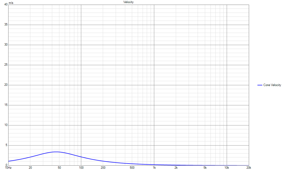

Please take into account the woofer has to play up to 600Hz at least, were an ultra light 0.6 Gram 66mm Beryllium dome takes over.
My gut tells me this doesn't match well to a 120 Gram aluminum cone with 230mm diameter.
Don't know how the Yamaha feels at 105dB, too.
