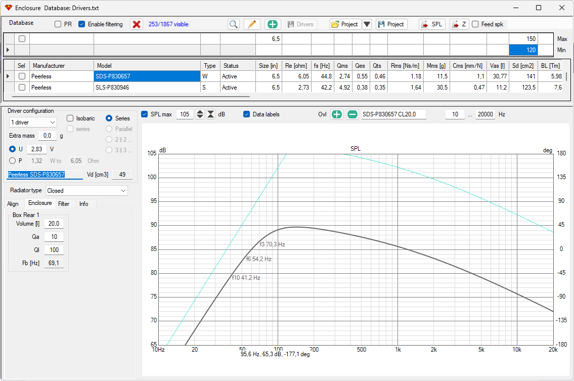

18w8531 I think fits this description at Q=0.7, it's used in the Zaph ZRT with a recommended 20L closed.
Quick online calc -

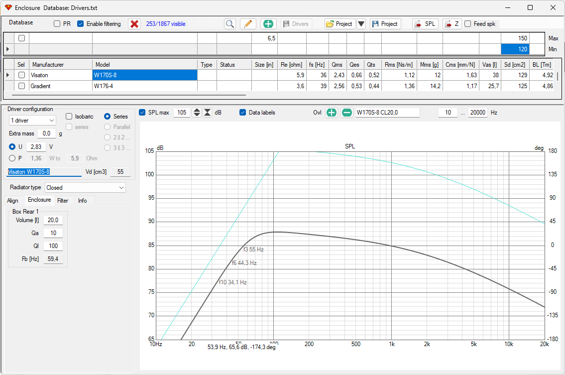

How do you calculate this with the T&S parameters of the mid-bass unit? You're speaking here of the Q of the box, yes?
I found this which I'll try: http://www.mh-audio.nl/Calculators/CBCQ.html

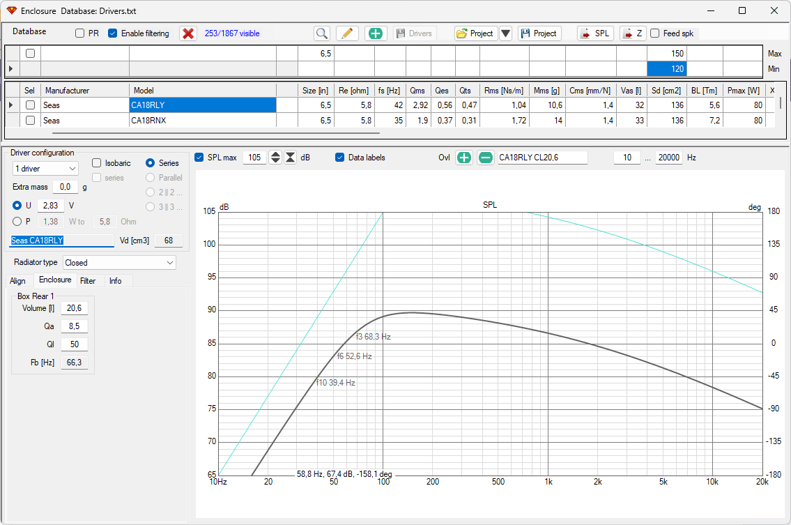

With the above, the SB 17MFC has an ideal sealed box of 14.7 litres, which looks pretty typical.
SEAS CA18RLY has an ideal sealed box of 25 litres

The mh-audio calculator is pulling up some unexpected results.......
Scanspeak 18W-8546 - Fs 22Hz, Qts=.19, EBP=100, Qtc = 6.5 litres
Monacor SPH165 - Fs 33, Qts=.21, EBP=143, Qtc = 3.5 litres
Looks like a Qts of .4 or above is needed. But the SEAS U18 with a Qts of .37 has a Qtc of 8.3 litres. Hmmmmm....

liters are for Vb (volume box) , Qtc is the shape of the low pass magnitude of the driver in box ; 0.707 ; 1.00 ; 0.61 ; etc ; > 0.707 is towards more bass envelopment and < 0.707 is towards tigther sound . But also depends on the amp, source, room. Try not to choose 4 ohms speaker and too much low sensivity with your 3 W SE amp.
