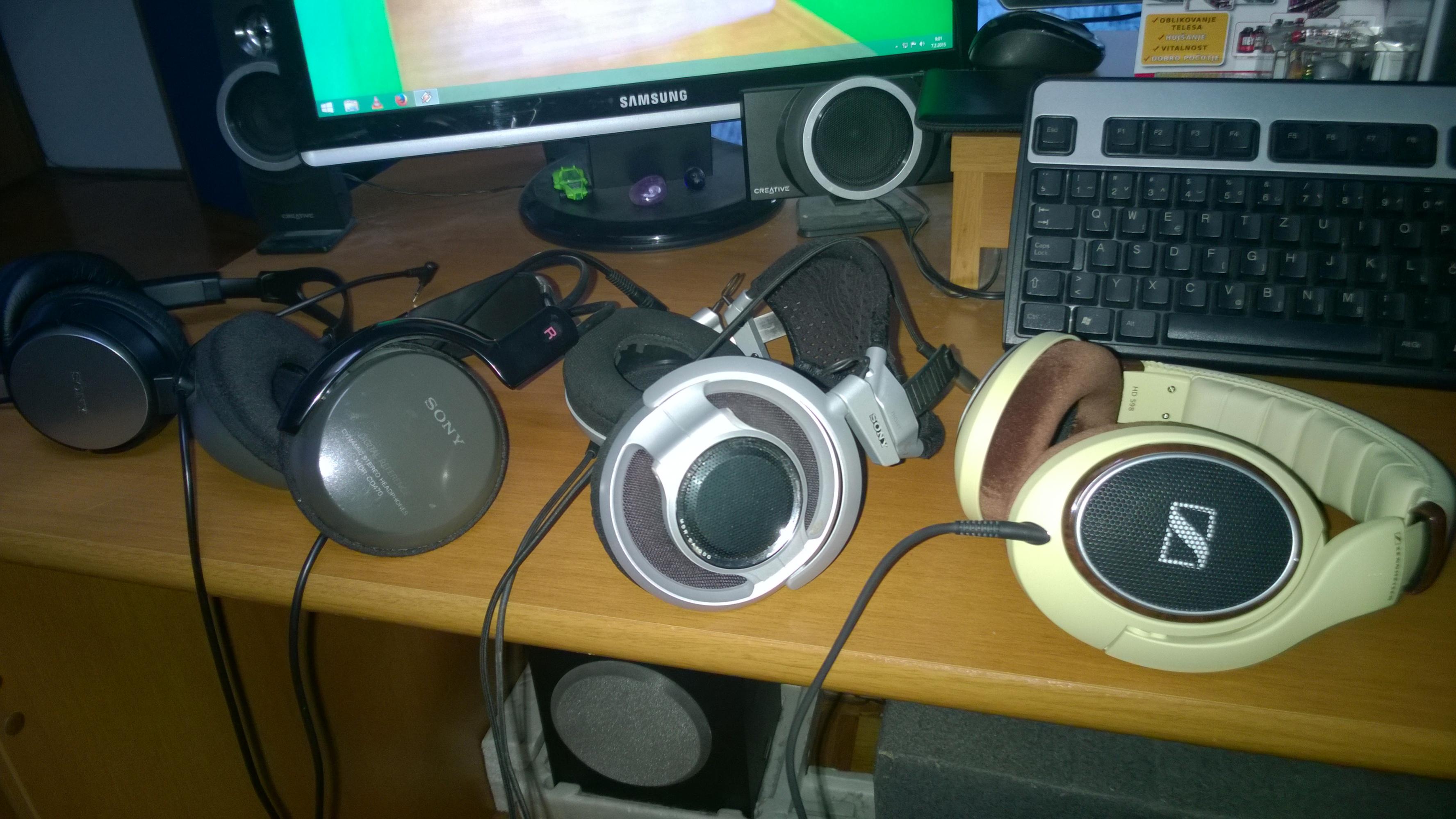

Today I have tested a few headphones:
Source: Gigabyte H81M-HD3 with Realtek ALC892 through Creative Inspire T6100.
Headphones:
- Sony MDR-XD150 (32ohm/1kHz, 12-22,000 Hz, 100 dB/mW, Dynamic and closed type),
- Sony MDR-CD470 (40ohm/1kHz, 10-25,000 Hz, 104 dB/mW, Dynamic and closed type),
- Sony MDR-SA1000 (70ohm, 8-80,000 Hz, 100 dB/mW, Dynamic and open type),
- Sennheiser HD 598 (50ohm, 12-38,500 Hz, 112 dB/1kHz/1Vrms, THD <0,1%(1kHz/100dB SPL, Dynamic and open type).
But the Sennheiser were the loudest, best sounded (even in the low freq. spectrum). So I guess that they are not faulty... I have to give them good source and right amplifier (I hope that this is the answer for my problem).
