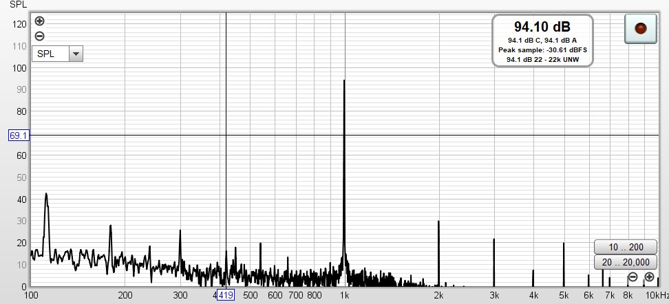

So I got my microphone calibrator today, from ebay. Finding the battery door, I put in a 9V and it made (I was later to find) a 1kHz tone, getting louder with the 114 and 124 db settings - "That's encouraging, I thought".
Of course, whatever socket it has doesnt fit my microphone (Apex 220), so one slice of bicycle tube, backed with one slice of duct tape and I got a snug fit. Hopefully sealed good enough.
Using REW, and my Tascam US-122 setup (I have a Focusrite also) with the Calibrator set to 124 db, I manually adjusted the gain so that REW's Oscilloscope trace went close to, but not over, the displayed limits. There's an indicator on the US-122 going from green to red at this level. The display was a sine wave with no clipping - of course!
Then, using REW's SPLmeter, I selected "Use External Signal" in the calibration routine. With the Calibrator outputting 124 db, I simply typed "124" into the popup box. Then the db(c) reading became 124.
Switching to 114db on the Calibrator, I read 114.1, switching to 94, read 94.2. Not complaining for $20, shipped.
