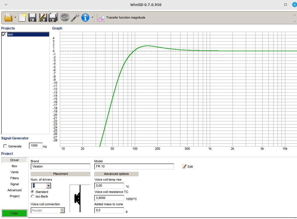

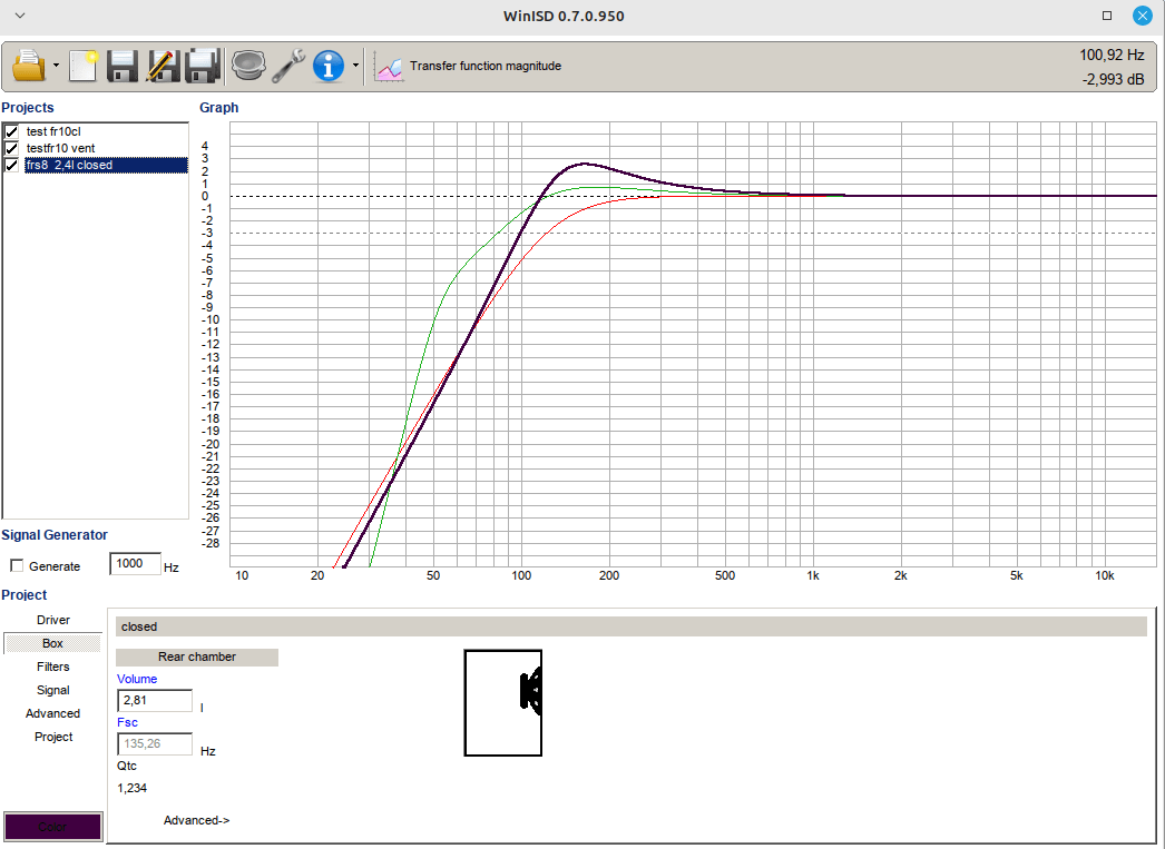

Hello again,
I tried to simulate the suggested setup with WinISD:
  • The yellow curve is the setup with 2.81 liters Dayton Audio ND65-8 2-1/2" drivers with two Dayton Audio ND65-PR 2-1/2"
  • The blue curve is the ND65-8 2-1/2" in a sealed enclosure exactly the volume as suggested by Parts Express (for comparsion)
  • The green curve is the ND65-8 2-1/2" in a vented enclosure with vent and volume as suggested by Parts Express (for comparsion)
Simon

Thanks a lot for your suggestions, @mattstat and @Dieter Geissel. Much appreciated. Would the Dayton Audio ND91 and the the Visaton FR 10 both work fairly well in a sealed enclosure?
Both suggested drivers are larger than I'd hoped for. If I'd go just for good overall sound quality without needing to much bass, are there any smaller full range drivers, which would work in my situation? I know that I have to make compromises here and there.
Best
The ND91 will do fine in a sealed box, but will roll off relatively high in that configuration. Something like this would typically use equalization to boost the bass, since the driver has a lot of excursion capability you can take advantage of.
If you're not as worried about bass quantity/extension, the ND65 is probably a good choice. It has similar construction and response to the ND64, which I like. I've tested a pile of 1.5-3 inch drivers, and the ND64 is the one I liked most in the end (but I did not test the ND65 because its depth was greater than my project would allow). The ND65 will get you more bass than the ND64 at the cost of lower sensitivity. Given your application it may be the best trade-off if you want to stick with the smaller driver.
