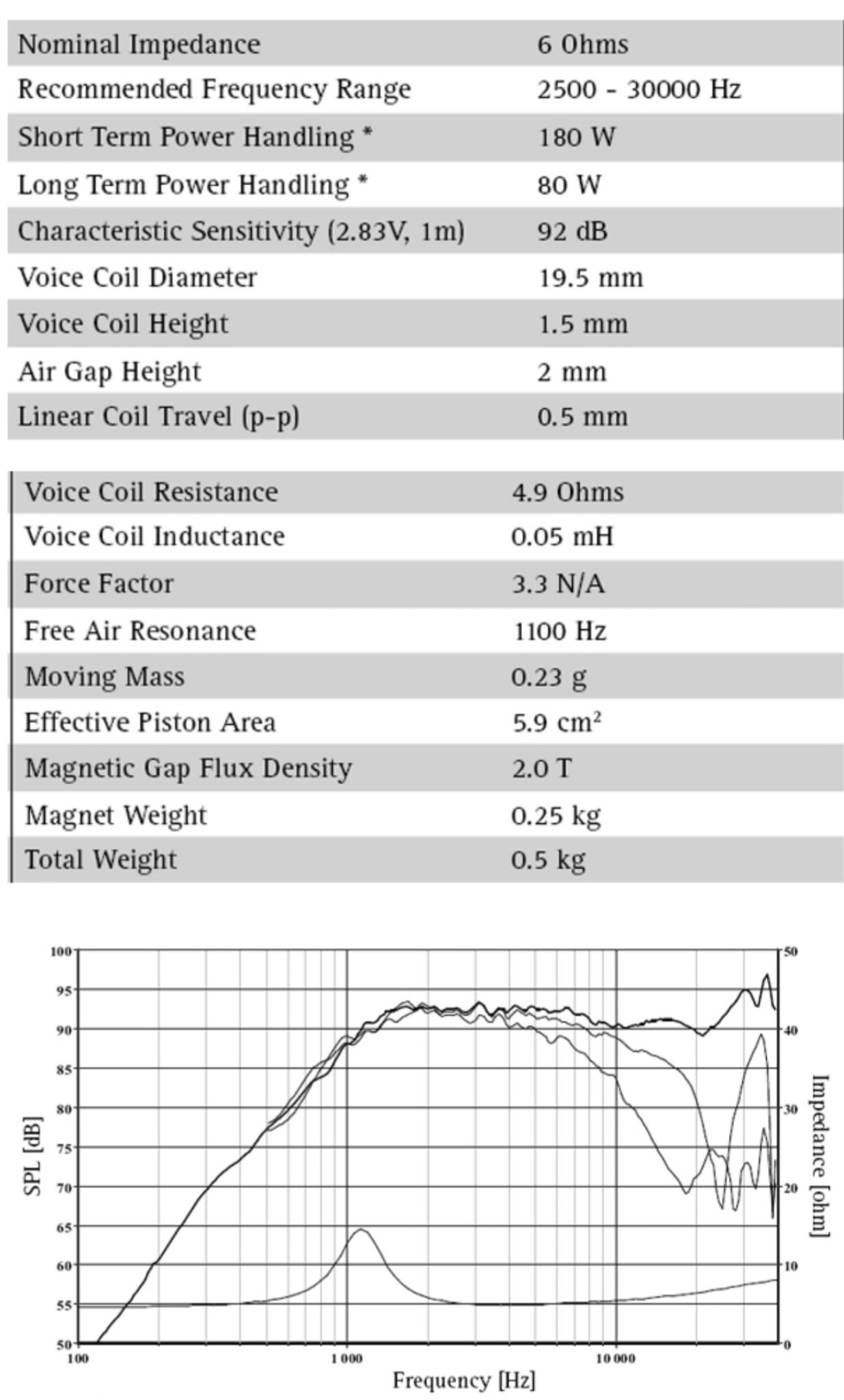

A short question. The goal is to be crossed at around 3-3.5kHz with about electrically 12dB/octave slope, acoustically 24dB/octave is preferable if possible.
Which tweeter is more advanced in technology?
A. 19 mm. woven soft dome with ferrofluid cooling
B. 25 mm. woven soft dome with air vent cooling

Ok, let me summarize the question.
Which one is more advanced in “technology” between a smaller voice coil with ferrofluid cooling or a larger voice coil with air vent cooling?
The answer is that as-described, neither is 'more advanced' or 'less advanced' than the other. Size, and the presence or lack of ferrofluid does not automatically make a drive unit 'advanced' or otherwise -same for whether it has a loading or decompression chamber or not.
That being said, assuming a fairly conventional 'modern' speaker, most quality 3/4in domes or 1in domes should have zero issue with power-handling crossing at 3KHz or above to a midbass, especially if you can hit LR4 slopes with a 2nd order electrical filter, although the polars / polar match is likely to be fairly rubbish at that frequency, the latter being less of an issue with a 3 way or > of course.
The Seas 22TAFG is a good example of a high tech modern tweeter. Its a 19mm alu/mg alloy dome and VC with a larger fabric surround, having the surface area close to a 27mm dome. You have the top end extension of a smaller metal dome coupled with the lower rolloff of a larger soft dome. This is a very natural sounding tweeter with lots of air and a smooth upper midrange.
It also has the high HD2 of all tweeters which use the flexible surround as an active part of their radiating surface, and rapidly rising distortion of all orders < 2KHz.
Still a good tweeter though & depending what you do with it, it can be crossed lower than might be believed. I quite like it.
