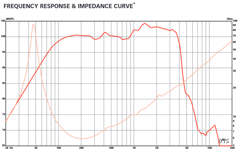

Firstly, my error.. a typo.. it's *97* db and it's a 15" driver.

As mentioned earlier, it's a 15" woofer... above it is a vintage Supravox T-215 RTF 64.
It is being custom designed to my preferences (to the degree that there are a wide range of choices in parts).

The supravox rolls off slowly and smoothly from ~100hz down to it's 55hz FS.
I will cut it at ~100hz first order.
Cutting the woofer's (slightly rising response above 75hz) first order around 75hz with a single high Q coil will flatten the response between ~40-45hz and 100hz.

The driver doesn't seem to be fit well for an open baffle project though. Low Qts (typical BR driver) is generally a bad indicator for OB TBH, I wouldn't use such a driver for that range at all. There are really cheap, good drivers with reasonable cone surface (12"+ since the membrane surface is very important for OB bass) with perfect parameters for OB that will result in a much more satisfying speaker. To be able to tell any more about that requires informations about the concept and other drivers.

Okay, that changes a lot. However, the problem with the quick slope to the low frequencies is still an issue, it will look pretty much like this (15", Qts 0,38, fs 47Hz):
You see the low spl in the sub-bass? Well, that driver got a ~3dB higher sensitivity, so the response plot of yours will run parallel below that, any driver with a comparable fs and Qts will behave exactly the same there, even smaller or bigger drivers do, just with different spl, smaller drivers only got a lower rise towards the mids. That's actually not good. And, as you can see, the response rises much faster than your 6dB, it's actually ~9+ dB. That means, a first order crossover will never work, it still rises +3dB/octave with it!
I wondered about that.... that is, the degree of difference (between the first order and the current 3rd order).
So are you suggesting I might like the (slightly) higher 75hz rather than the 70hz?
I'm curious to know.
Well, I doubt you'll be any happy with either of them.
Not at all for midrange! It sounds awful much above 100hz.
That can ofcourse be the case, but in denibenis defense, there are a lot of 15" drivers which do, in PA that's often even midrange territory and tons of PA tops are 15"+tweeter two-ways which makes it actually pretty likely.
Supravox claims it got a Qts of 0,58 (which would be a lot better) but 60Hz fs. I found a huge range of variing measured parameters which show they got a huge range of tolerances. With a Mms of just 8,5g the voice coil is not only small in diameter, it has to be extremely short too, otherwise a that low cone weight is simply impossible. A 15" PA bass-mid driver has usually 70-80g Mms, a sub 100-200g. Expect the driver to have an Xmax of <2mm.
With a that small voice coil, so low excursion, just 35W power rating and no ventilation behind the spider or the dustcap it's a terrible choice for a subwoofer. That driver is built like a fullrange, to use it as a sub is the worst ever you can do with that driver.
215 RTF 64 Full range driver unit 35W / 97dB / 8 Ohms - Supravox

I do understand your concept, that doesn't change the fact the driver doesn't fit your concept.
E: fixed quote
I think there's a bit of a misunderstanding....
The Supravox is being used as the "midrange".
High and low are relative terms...
"high Qts vs. low Qts in this case.
The 15" woofer... as it now IS.. has a Qts of ~ .37. (due to measurement related issues it might be .45)
SO: To bump it up a bit with a big coil is part of the goal.
Would this then be a "high Q woofer"?
Considering that some are as much as 1.5 plus QTS... it's all relative.
I tend to like a QTS of .45 to .5 in OB. Gives me the right balance.
This brings me closer to what you're suggesting.
First order low pass should also help fill in the region below where the Supravox slowly goes away.
Software shows only a 1.5db dip around 85hz.
There is also floor reinforcement, and (small) room reinforcement to consider as well.
Also, the FS for the 15 is 37hz, not 47... hope I didn't do another typo.
Regardless of the rest, the 15" woofer will fill in (at least somewhat) below where the midrange cuts off.
The Q peak at the low end, plus the high cut @ 70-75hz should flatten the overall bass response, and keep it flat to ~100hz or a bit more (rather than rising)..
Once again... I'm listening to it and and it's fine!
It's just a matter of fine tuning the crossover...
So again... which of the 2 coils would be better.
