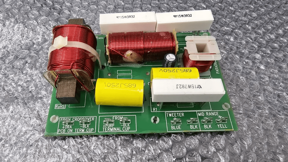

What about a photograph of the physical crossover so we can judge the quality of the fitted components?

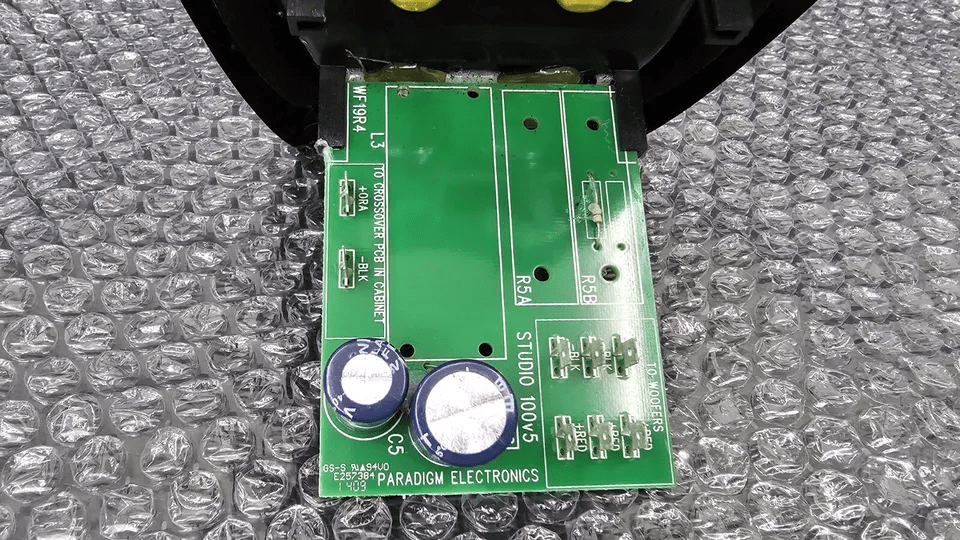

The midrange/tweeter crossover of the Studio 100 V5 is on this board (along with the bass inductor it would appear):
Here's the board which is fitted to the speaker terminal cup (which has bi-wire terminals):

The crossover components look to be of good quality. The electrolytic capacitors will still be well within spec.
Be aware that you may make the speaker sound different by 'upgrading' components, but not necessarily sound better
Changing components without making the required measurements is likely to upset Paradigm's intended sound balance.
Apart from replacing an obviously damaged component with a like one, I would leave well enough alone.
